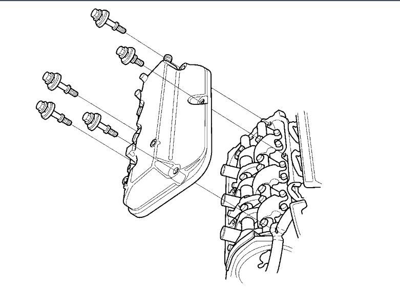

Cylinder Head Cover Removal
1. Remove the intake manifold See: Intake Manifold > Removal and Replacement > Intake Manifold Removal/Installation.
2. Remove the six ignition coils See: Ignition Coil > Removal and Replacement > Ignition Coil and Spark Plug Removal/Installation (Except J35A7).
3. Remove the dipstick.

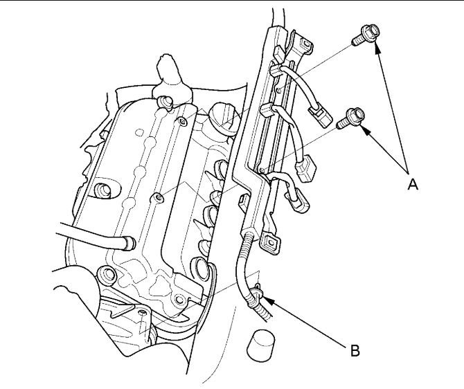

Front Cylinder Head Cover
4. Remove the two bolts (A) securing the harness holder, and remove the harness clamp (B).

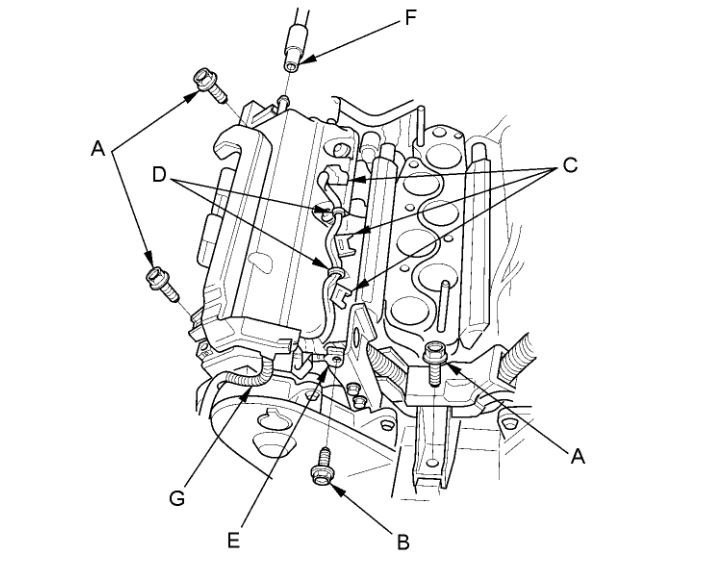

Rear Cylinder Head Cover
5. Remove the drive belt See: Drive Belt > Removal and Replacement > Drive Belt Replacement (J35A6).
6. Remove the power steering (P/S) pump and the P/S hose bracket See: Cylinder Head Assembly > Removal and Replacement > Cylinder Head Removal (J35A6) with its hoses connected.
7. Remove the harness holder mounting bolts (A) and the engine ground cable bolt (B).
8. Disconnect the injector connectors (C) and the two harness clips (D).
9. Remove the engine ground cable (E) and disconnect the breather hose (F).
10. Remove the harness (G) from the upper cover.

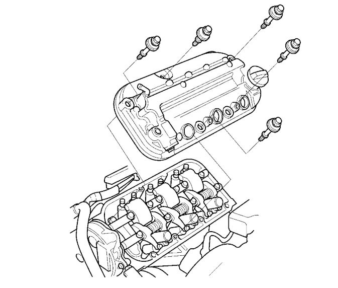

11. Remove the cylinder head cover.
