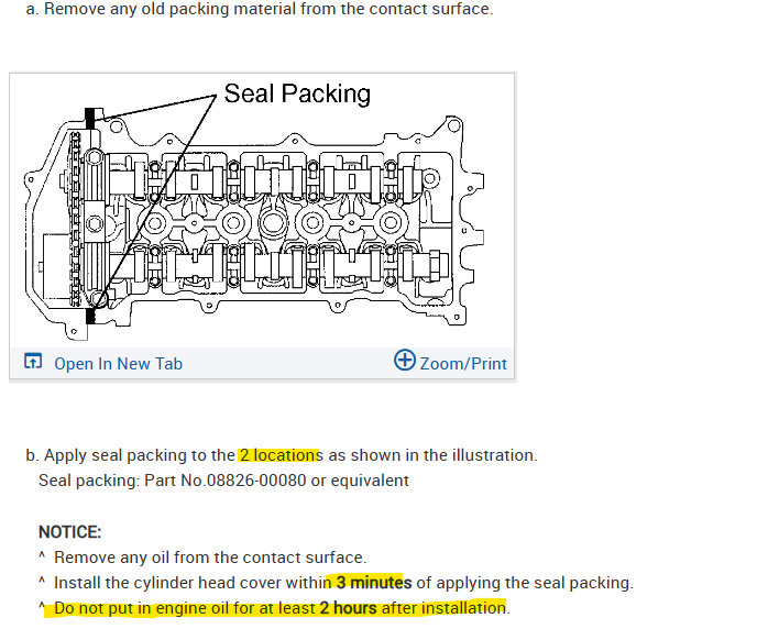

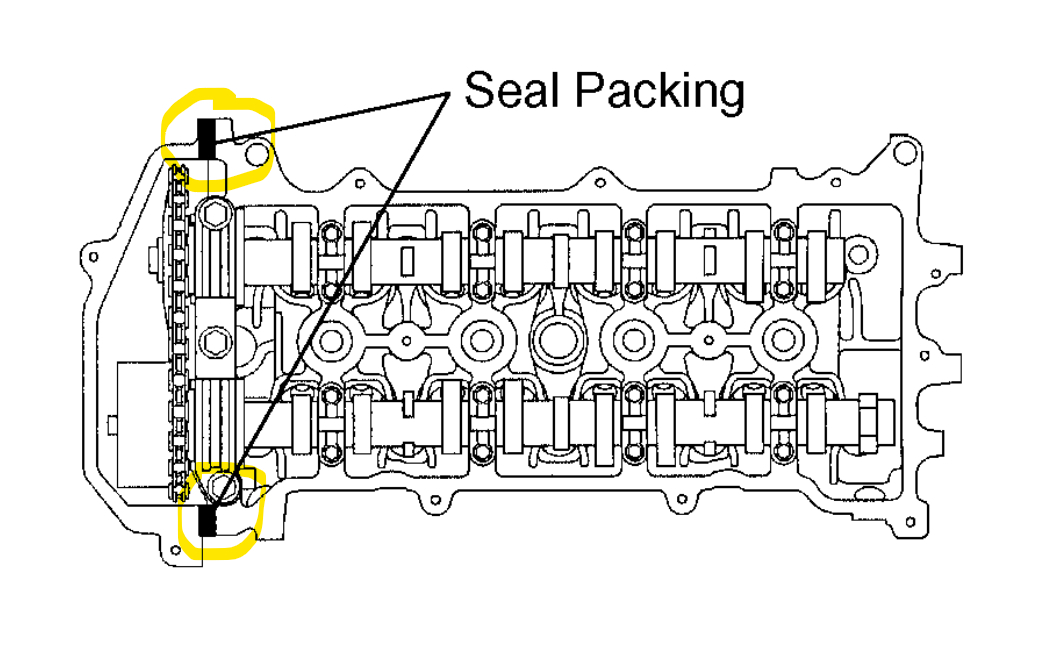

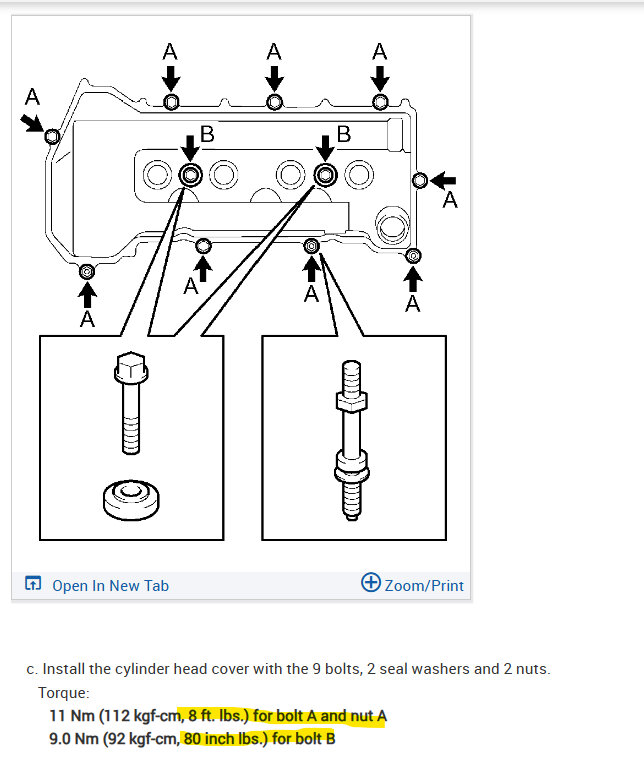

I understand there are two areas under the valve cover that you need to put two dabs of silicone when camshaft area meets the flat cylinder head with a special RTV. Toyotas sealant is very expensive and was wondering if you could provide an oil resistant equivalent compound that would do the same thing. Don't understand why valve cover gasket would not seal it by itself. It looks like maybe a Permatex or some other sealant would do them sand thing. Would you have a name and part #. Thanks
