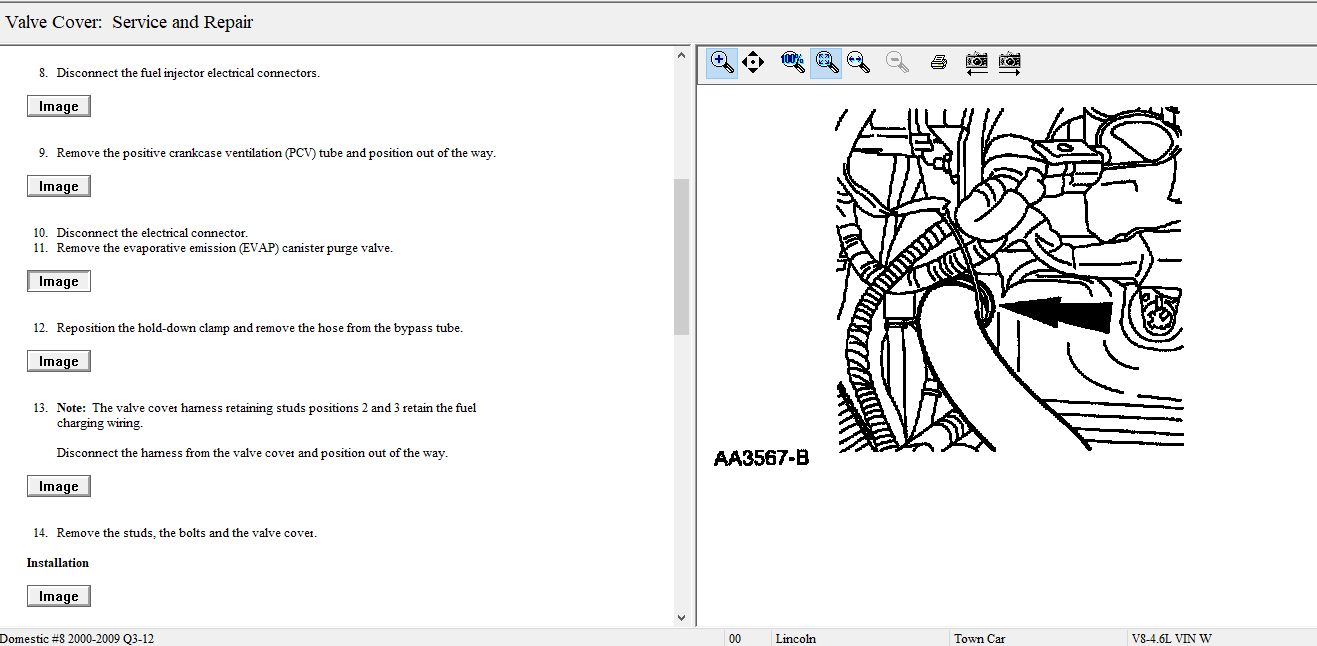

What is the procedure for changing the valve cover gasket?

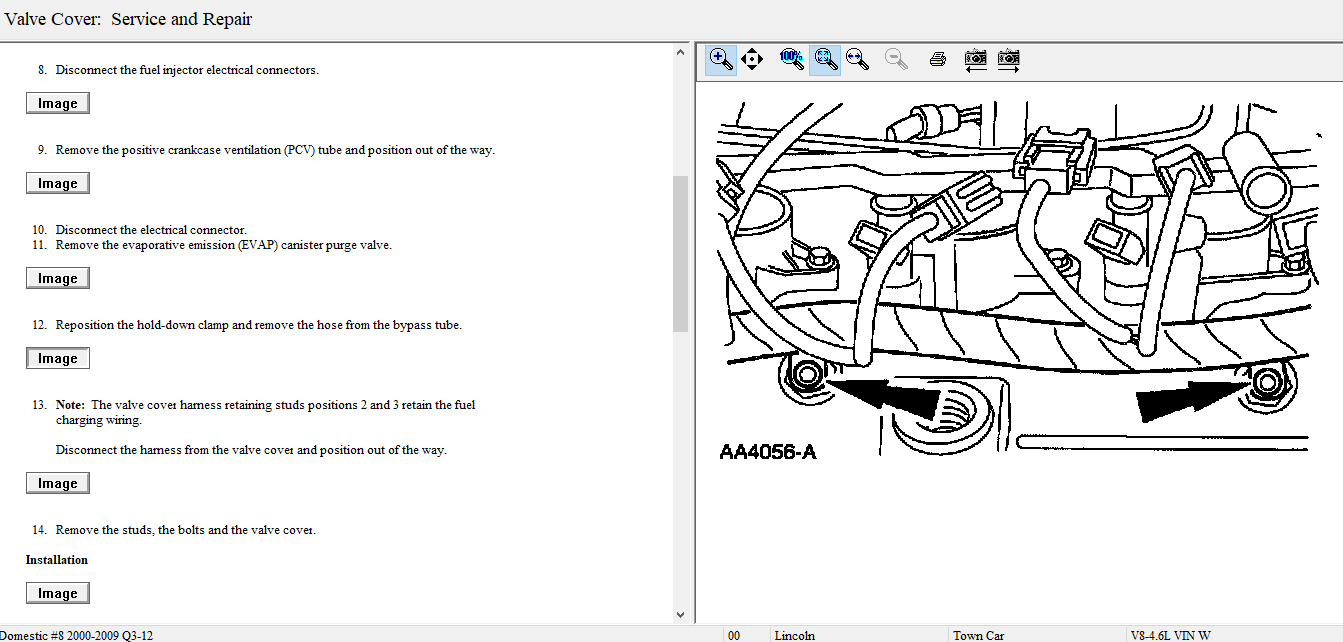

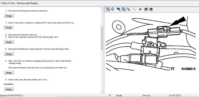

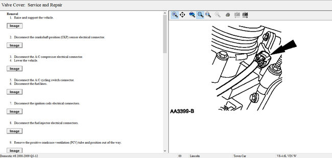

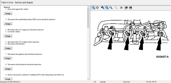

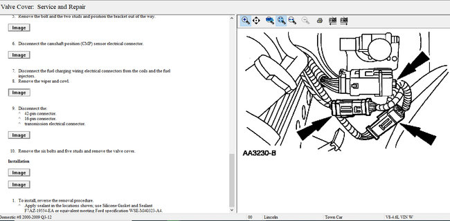

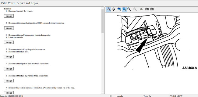

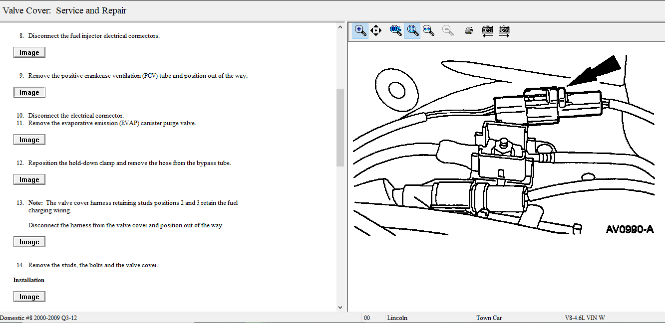

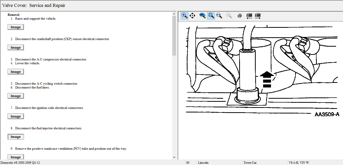

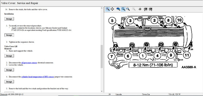

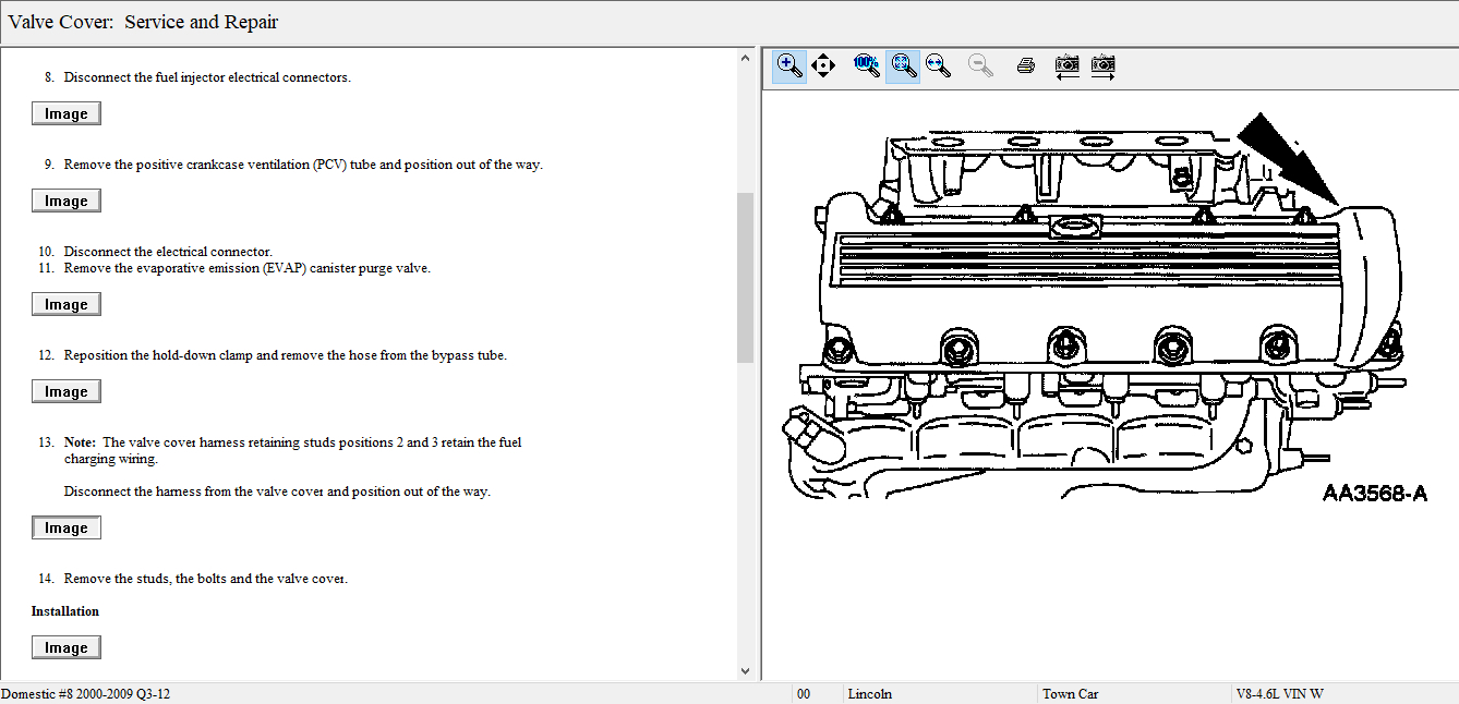

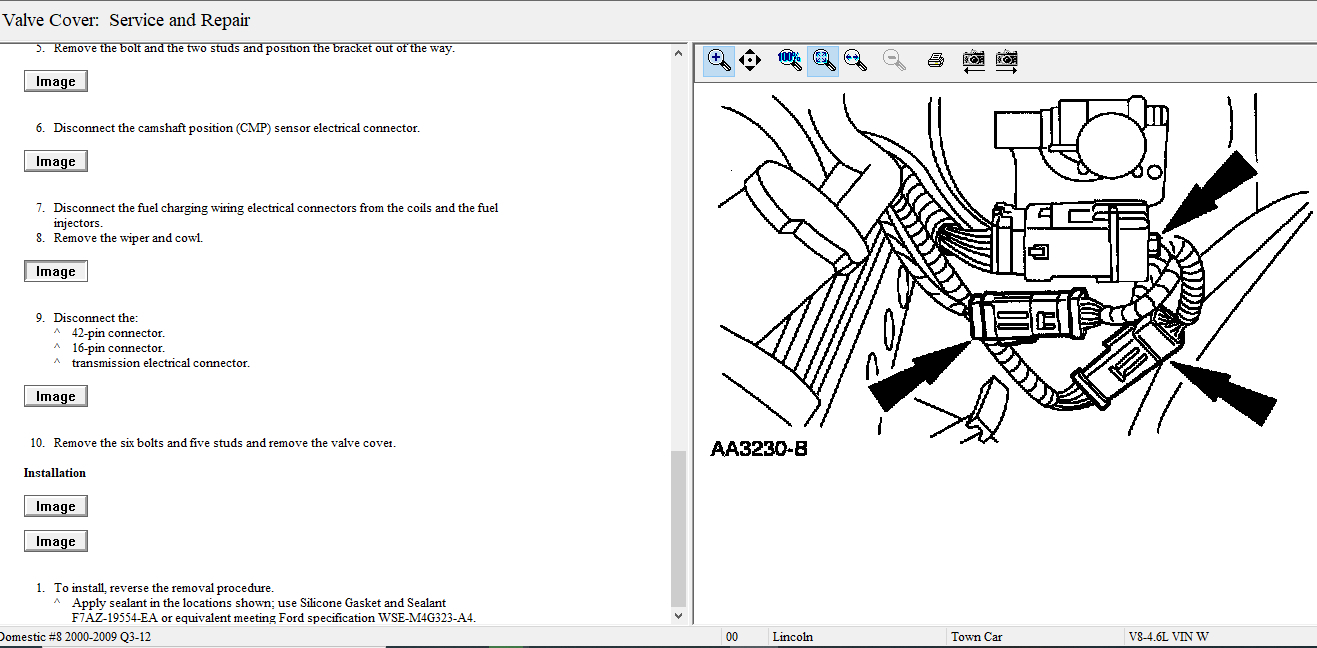

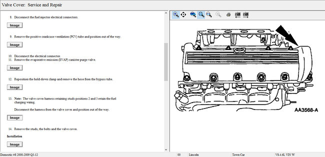

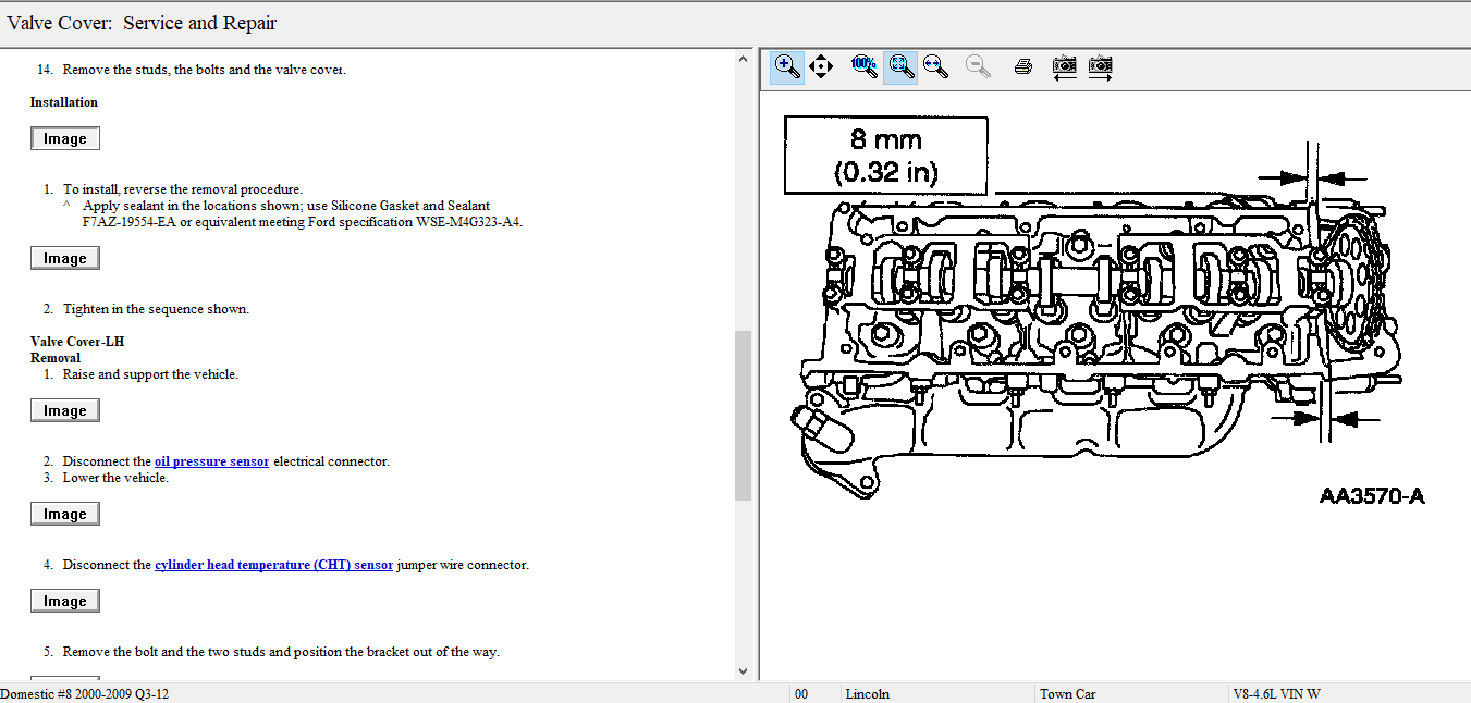

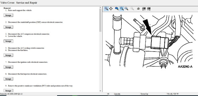

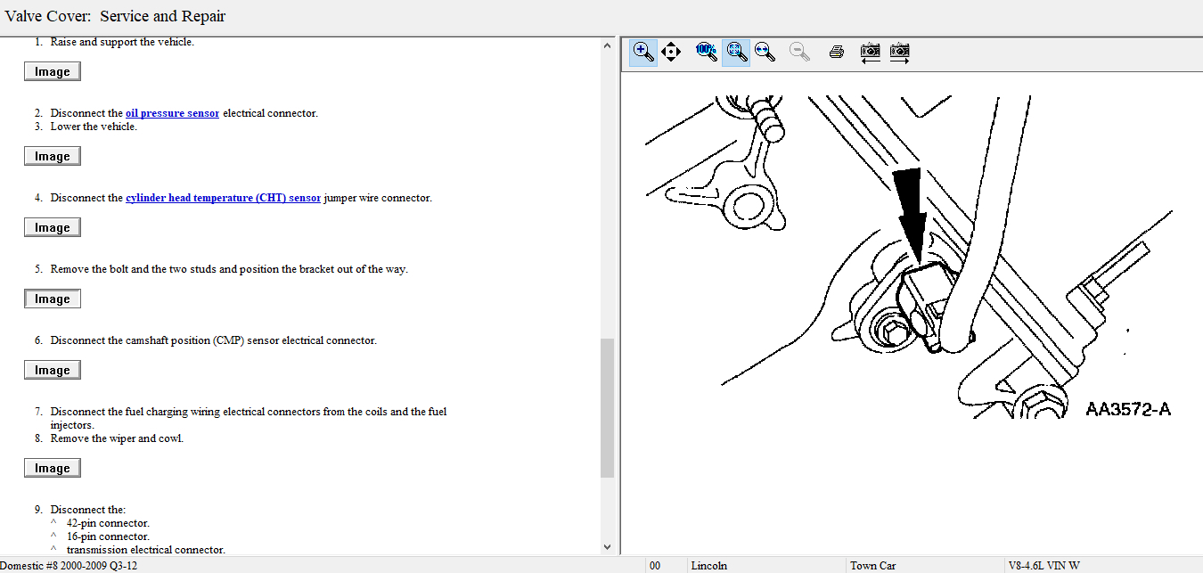

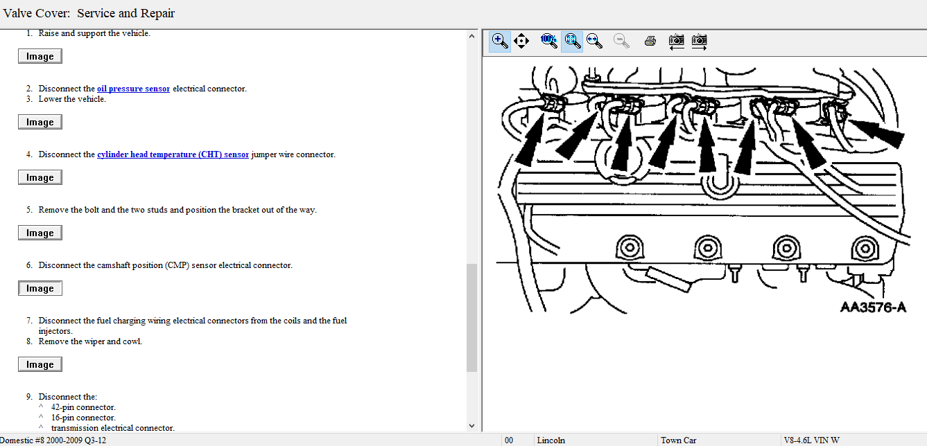

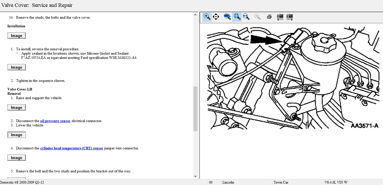

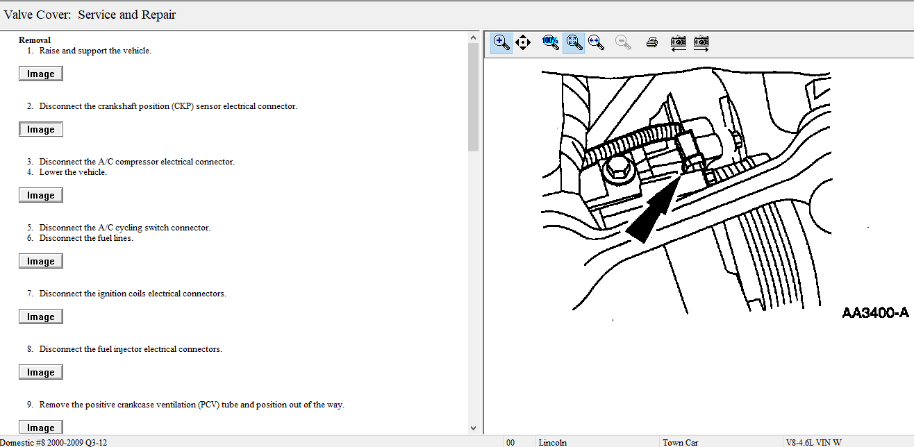

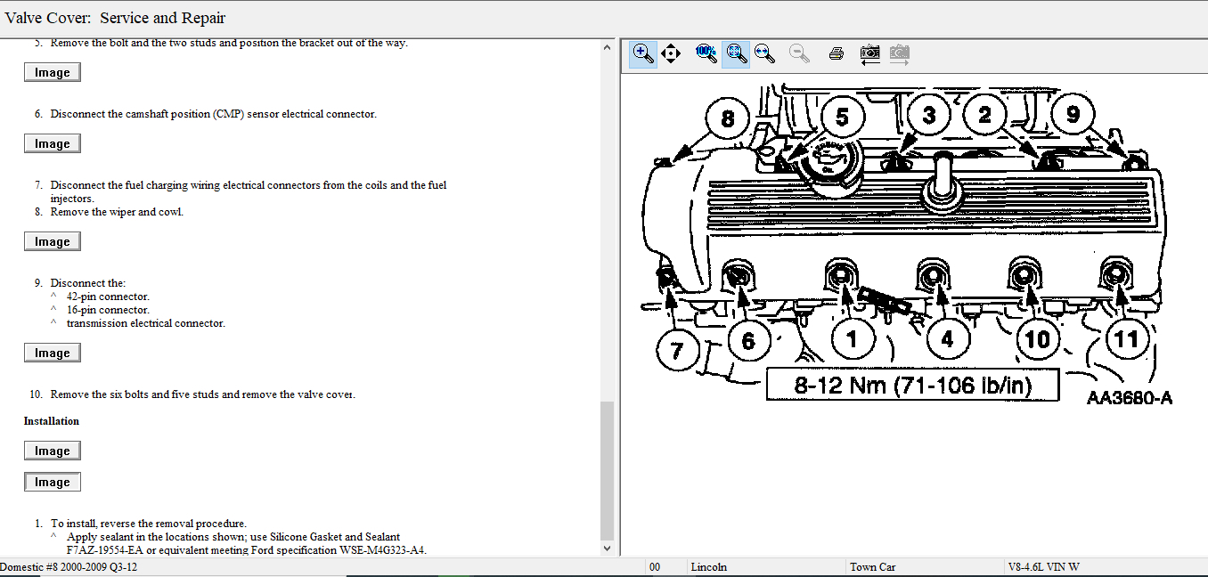

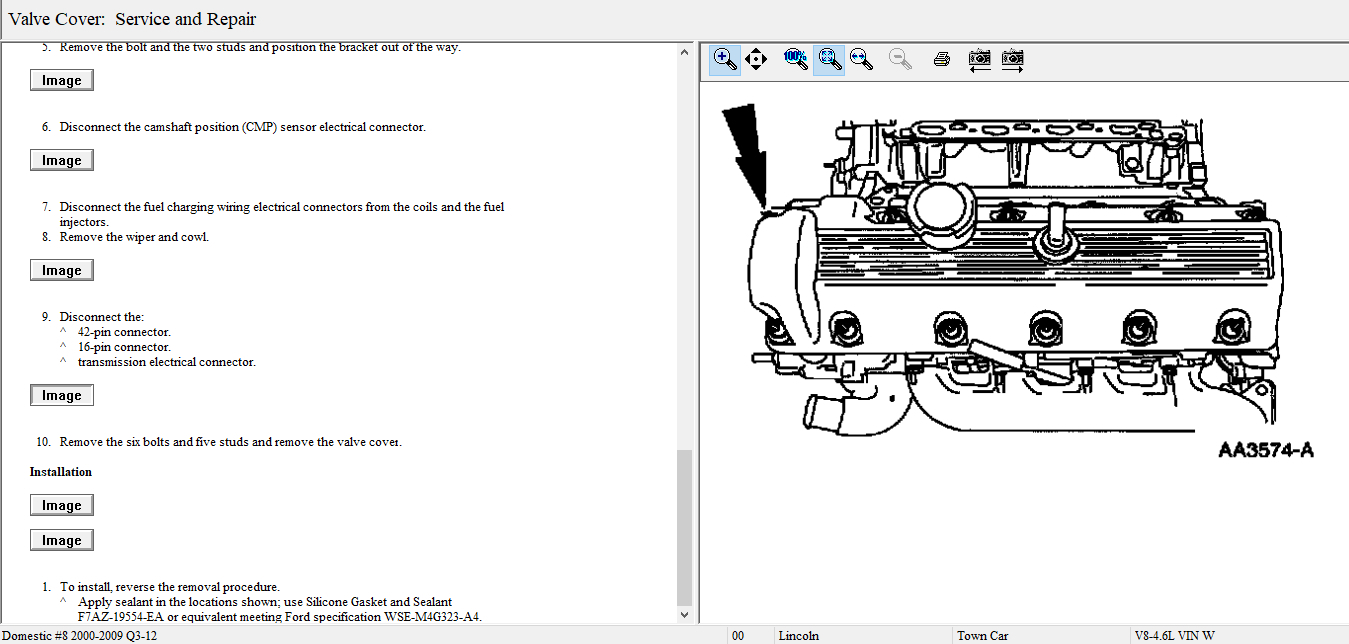

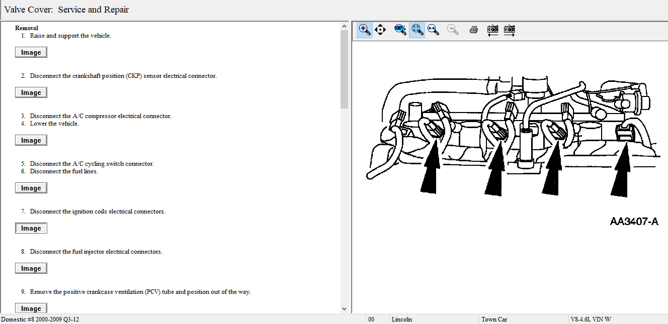

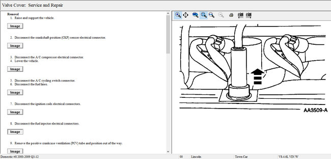

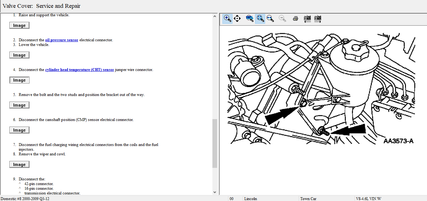

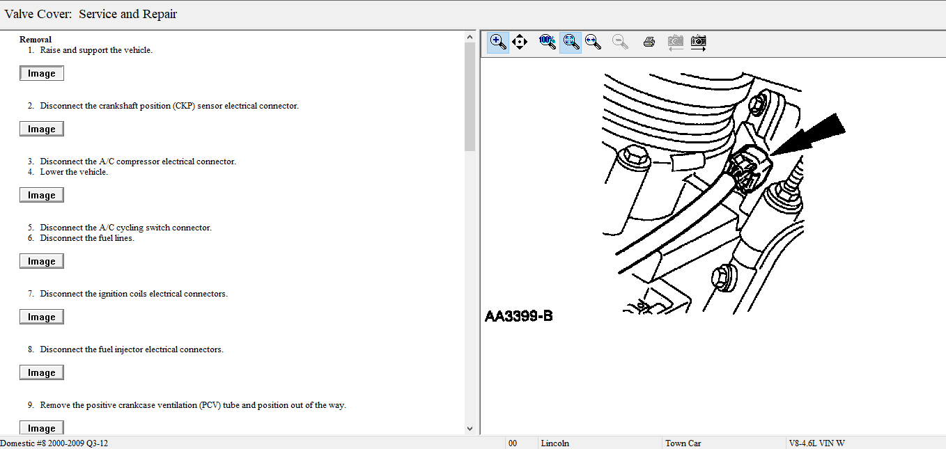

hello.

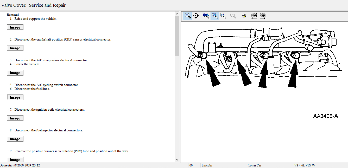

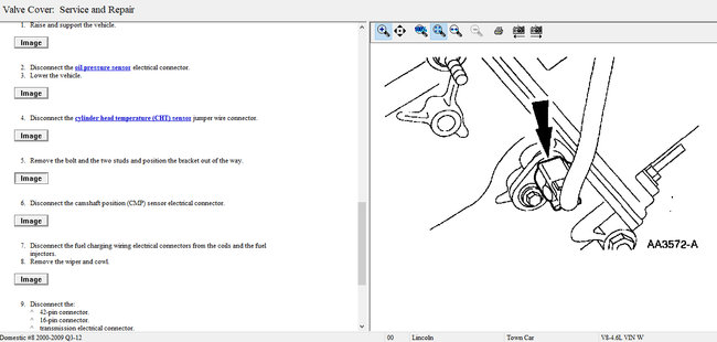

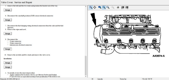

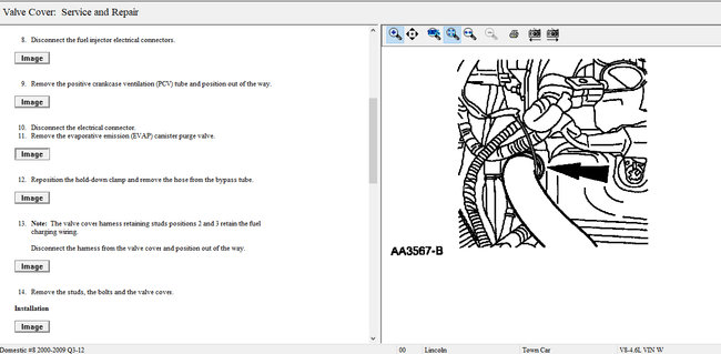

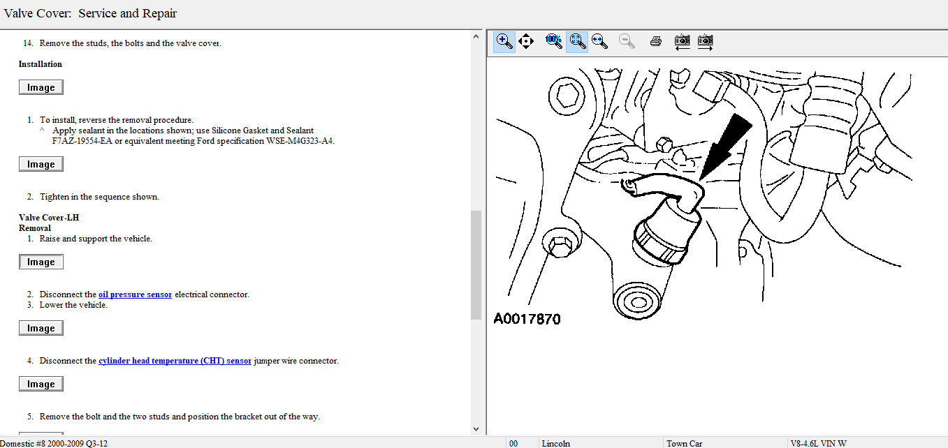

check our link below how to remove and reinstall valve covers.
https://www.2carpros.com/articles/replace-valve-cover-gasket
Check the diagrams below procedure step by step specific to your engine valve cover remove and reinstall.
let us know if you need more help.
