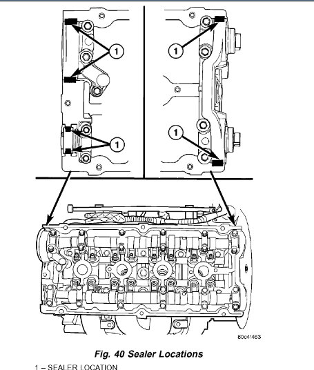

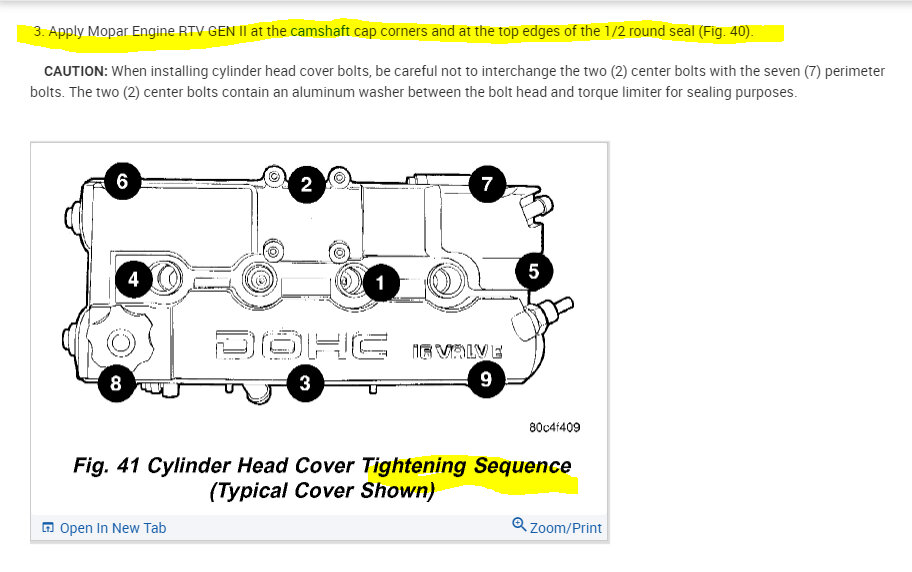

You will need an RTV gasket maker when doing this job. It is only required at certain parts of the valve cover. Make sure all surfaces are clean and dry before you install the gasket.

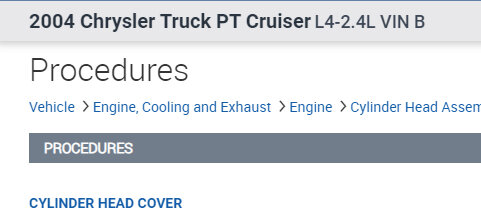

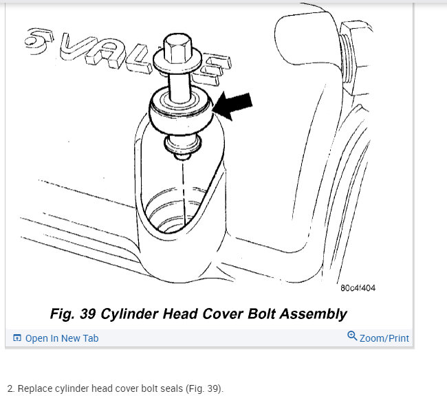

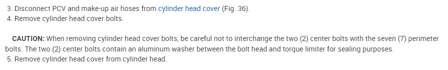

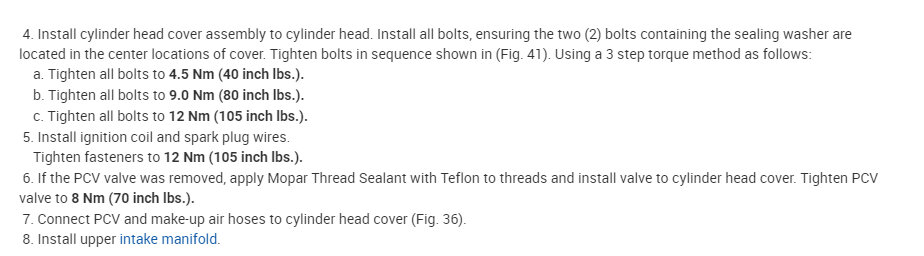

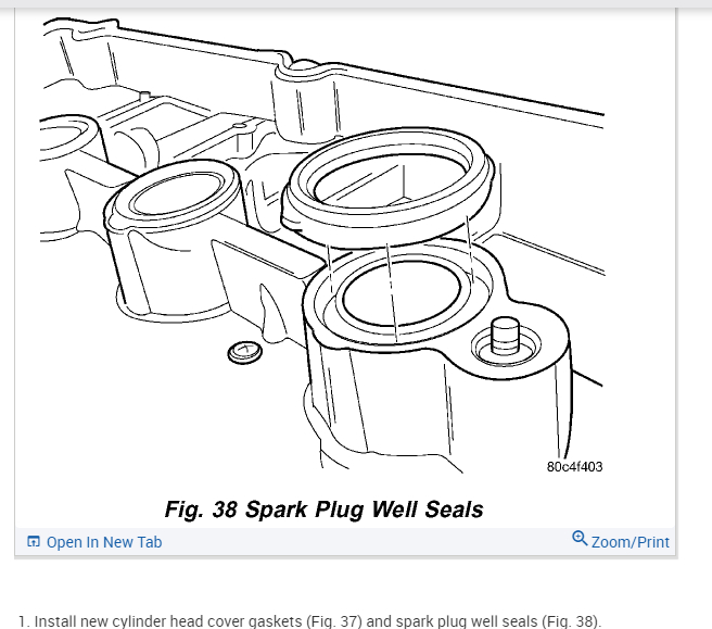

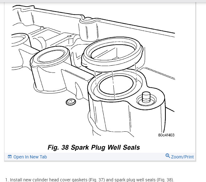

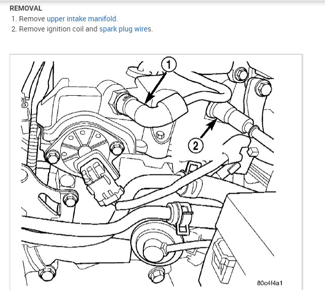

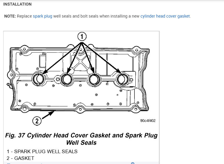

If you look below, I attached the directions for the removal and replacement of the cover. The directions include torque sequence and the manufacturer's torque specifications. Additionally, it shows where to put the RTV.
