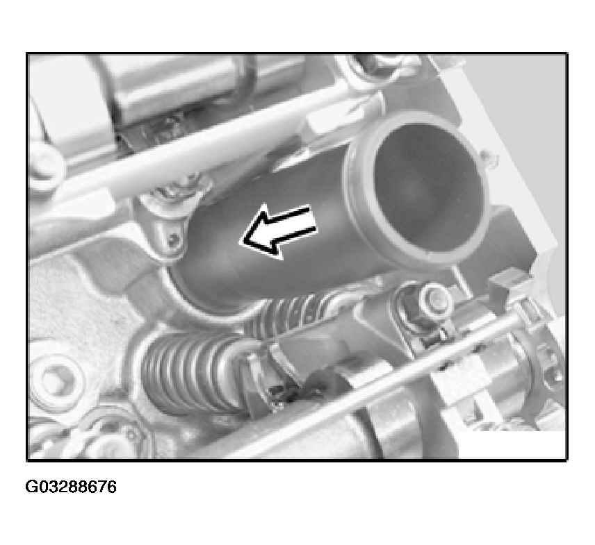

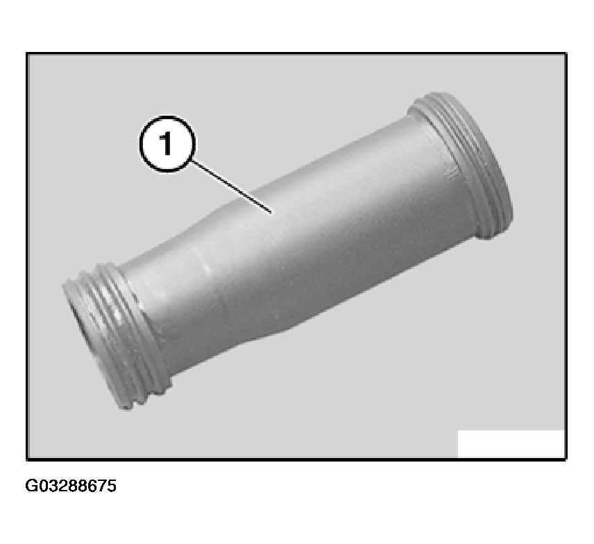

Are the spark plug tubes installed with new seals and sitting fully in the recess? and do you have new top spark plug tube seals? Make sure all are lubed slightly so nothing binds while fitting the rocker cover.

MHPAUTOS
  • 31,937 POSTS
see pics

No I did not put new spark plug tubes in but the old ones are fully seated, every time the valve cover is remove you have to put in new spark plug tubes in
Mar 15, 2016 at 6:51 AM
MHPAUTOS
  • 31,937 POSTS
only if they are compressed and look like leaking, but it is good practice to replace anyway as they do become hard and brittle and will leak at some stage before you need to do the R/C cover again
