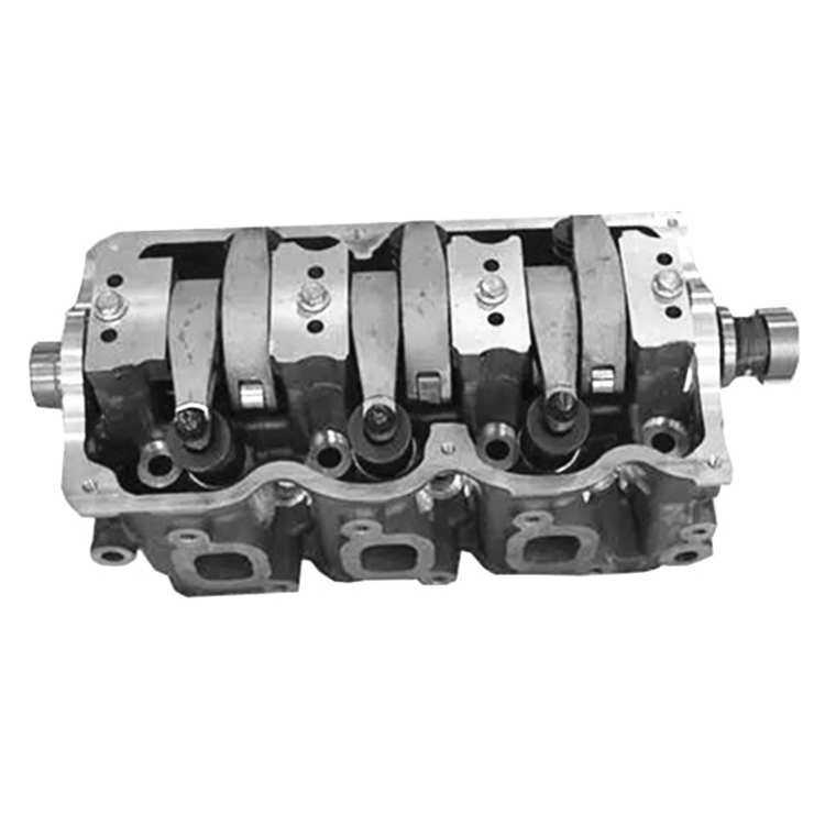

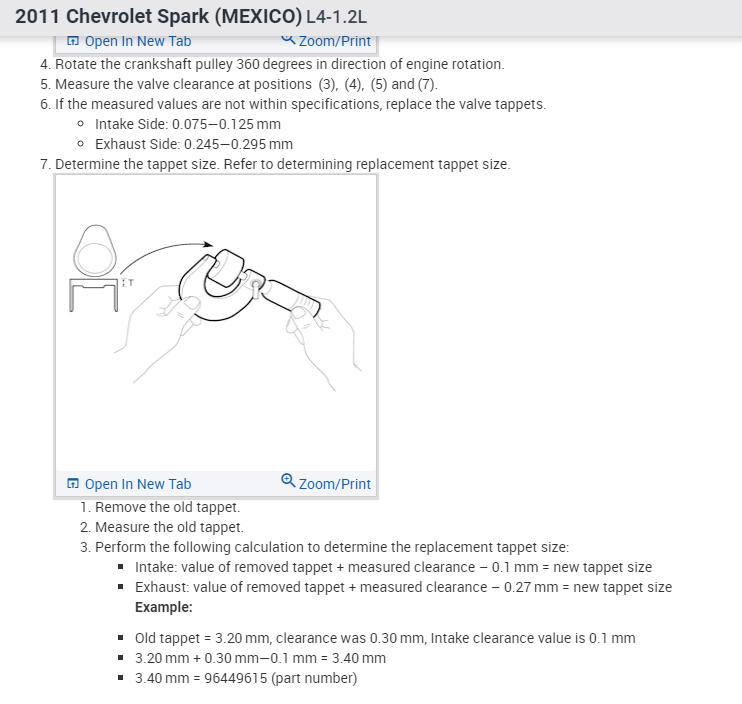

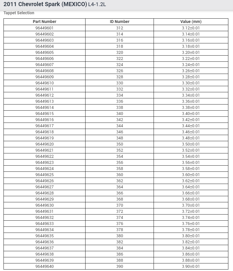

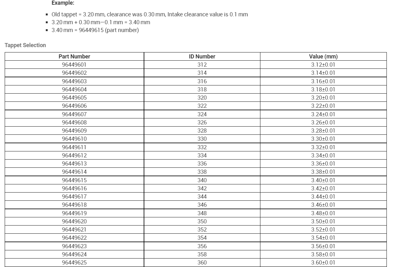

Hi, please provide me with the valve clearance settings and steps. My cylinder head only has one rocker shaft.
May 30, 2022 at 7:44 AM
SQM
CERTIFIED EXPERT
6,383 POSTS

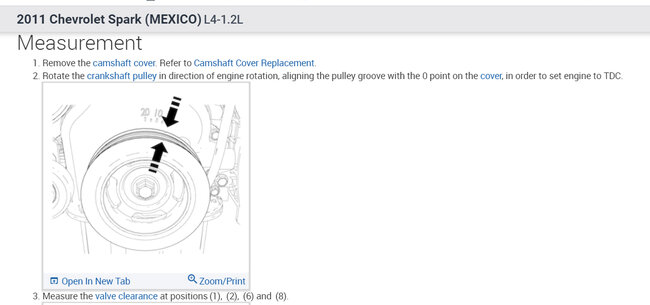

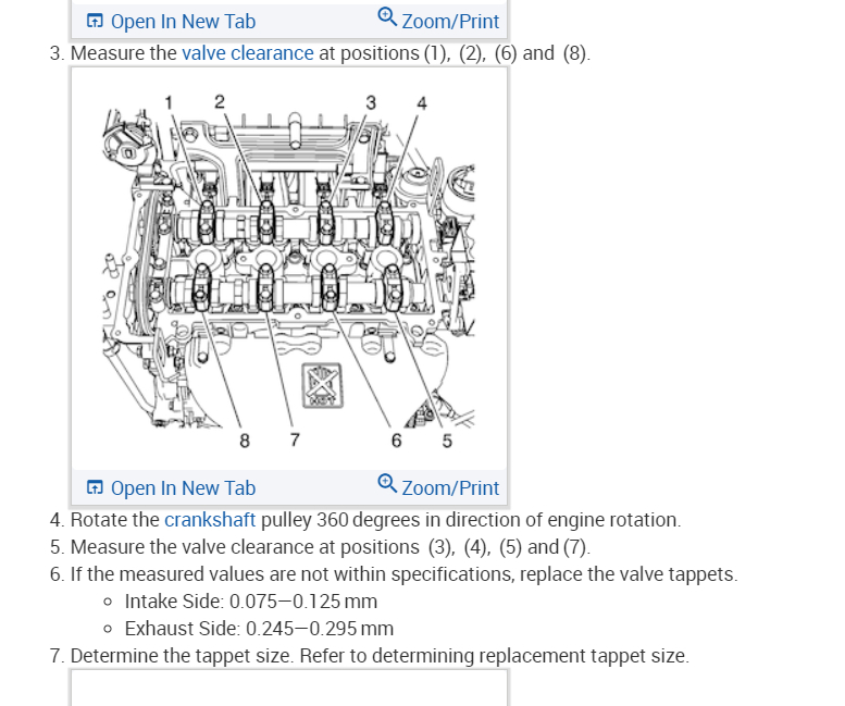

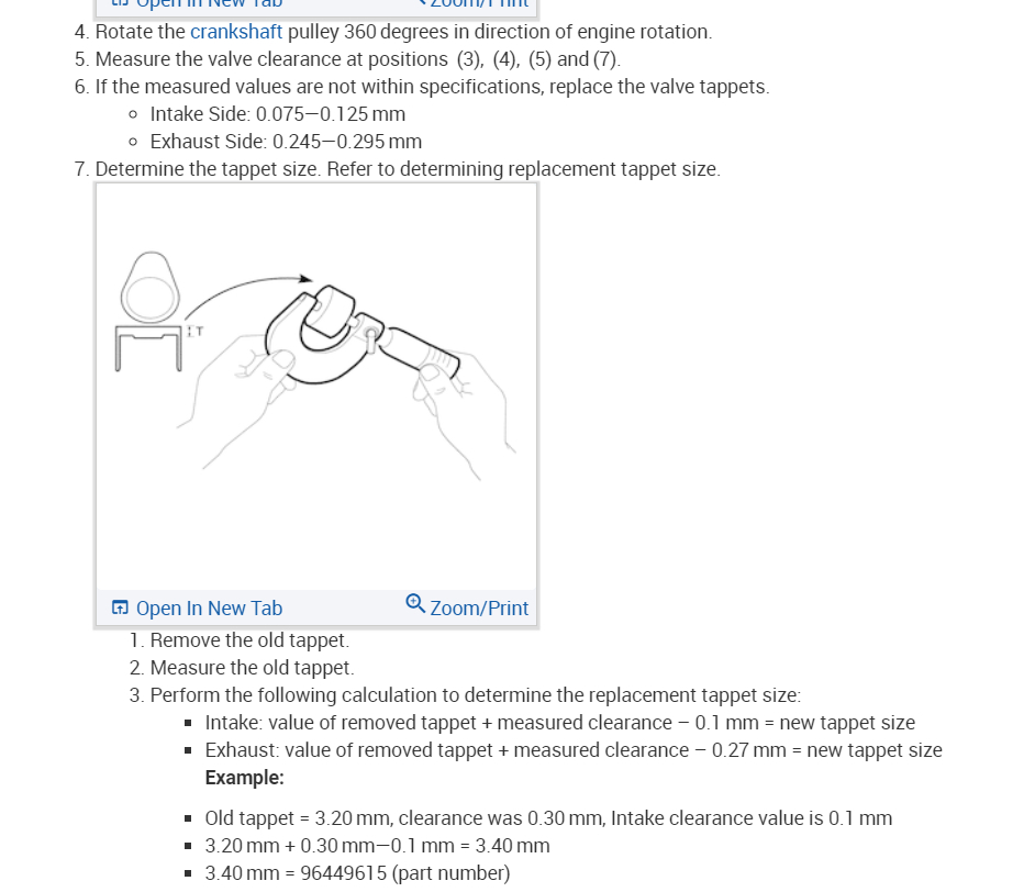

See attached for the valve adjustment procedure.
Let me know of any questions.
Thank you.

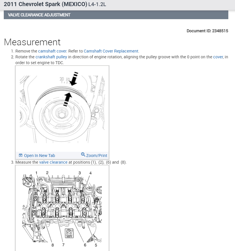

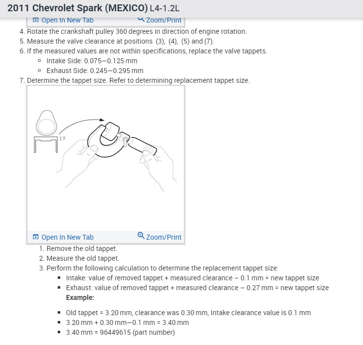

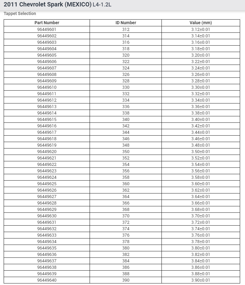

Hi, please provide me with the detailed valve clearance setting. I got the clearance on this platform, but it was for the cylinder head with the 2 rocker shafts. Mine only has 1 rocker shaft.
Image (Click to enlarge)
Jan 8, 2023 at 3:45 PM
(Merged)
CERTIFIED EXPERT
53,854 POSTS

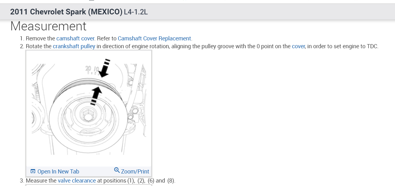

We only show two camshaft engines for this car, can you double check the year and engine type please? Here is what they show in the images below.

Thanks for your response. As for the type of engine, mine is the F8CV COIL PACK engine. Your one is the Carburetor. I'm including my VIN number as well.
