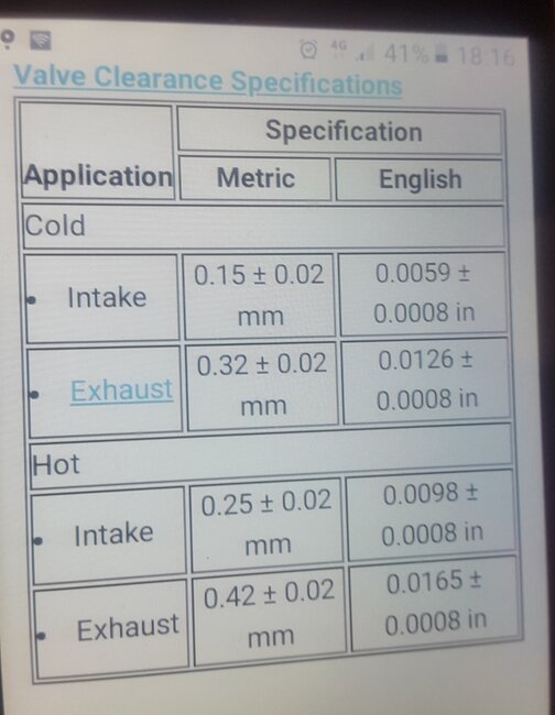

I finally got the correct steps to do my valve clearance. But my problem is that when I accelerate it is quite noisy as if the valve clearance needs to be done. However, it is totally quiet when idling. Does it mean that I have to go lower with the measurements?
I am attaching the measurements I have used.
