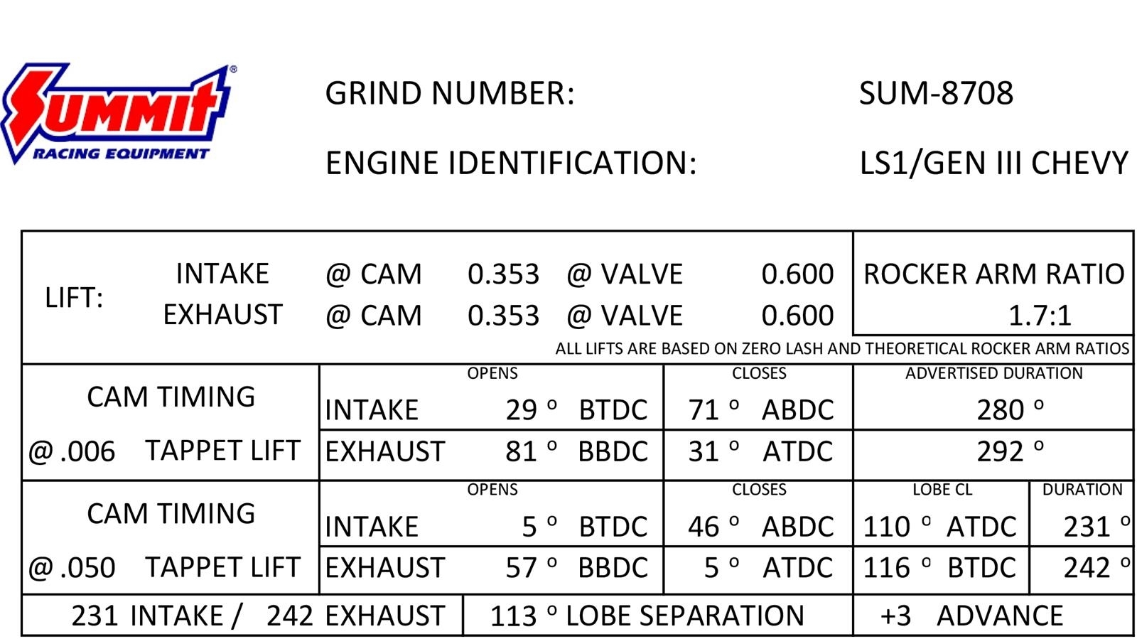

Yeah, should be all good. If you are really nervous about it, you can assemble the valvetrain on one piston with playdoh on top of the piston, rotate the engine over by hand slowly. Then remove the playdoh cut it in half to see how close the valve gets.
Here is our camshaft card so you can directly compare.
