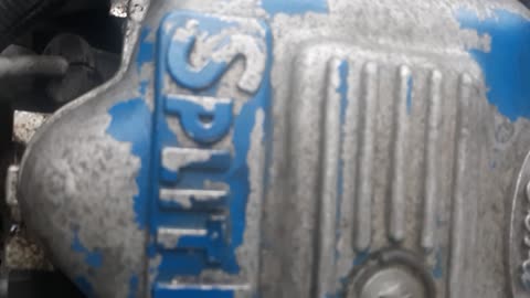

Here is the video you requested:

Thanks. It is still there at higher RPM.
I would pull the valve cover. They had issues with this engine with the number 4 cylinder rockers. See if they are loose.
