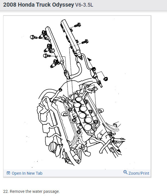

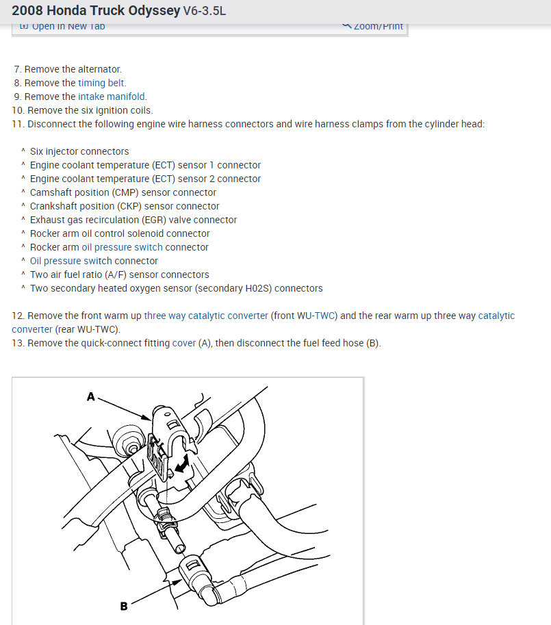

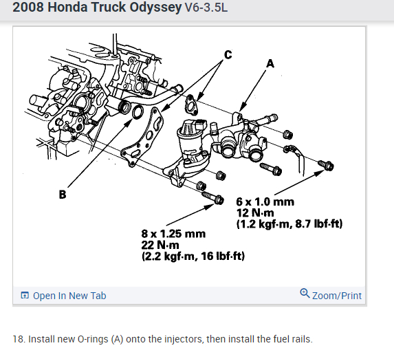

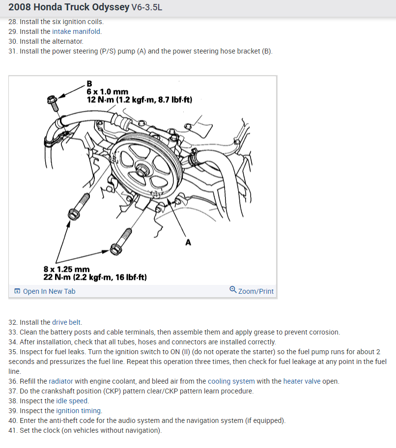

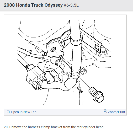

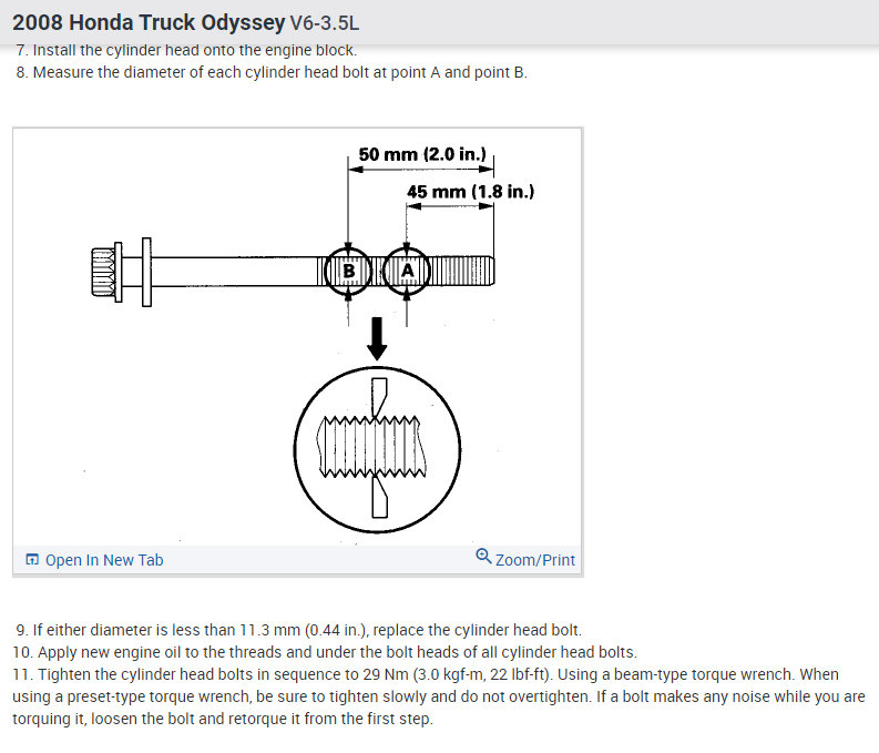

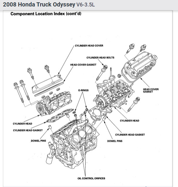

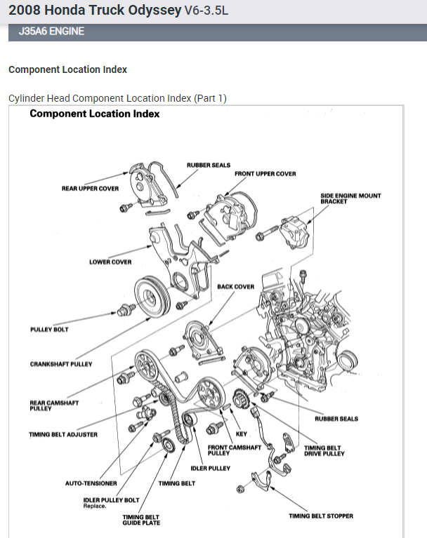

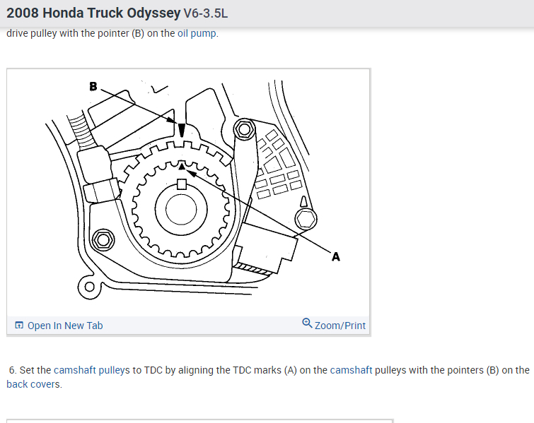

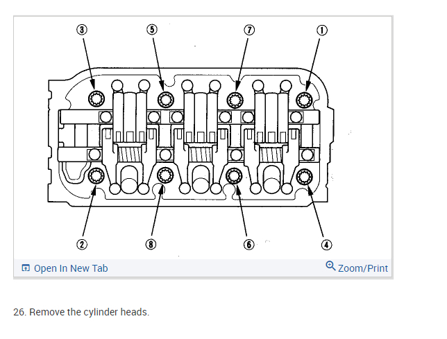

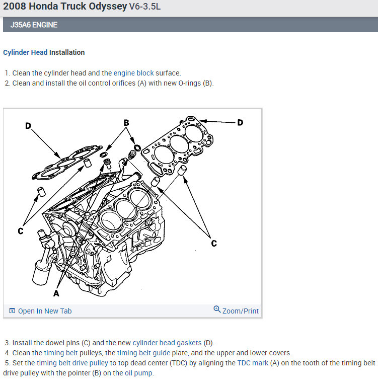

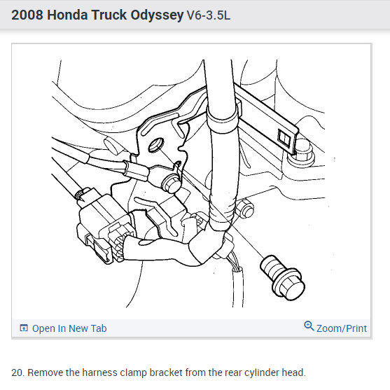

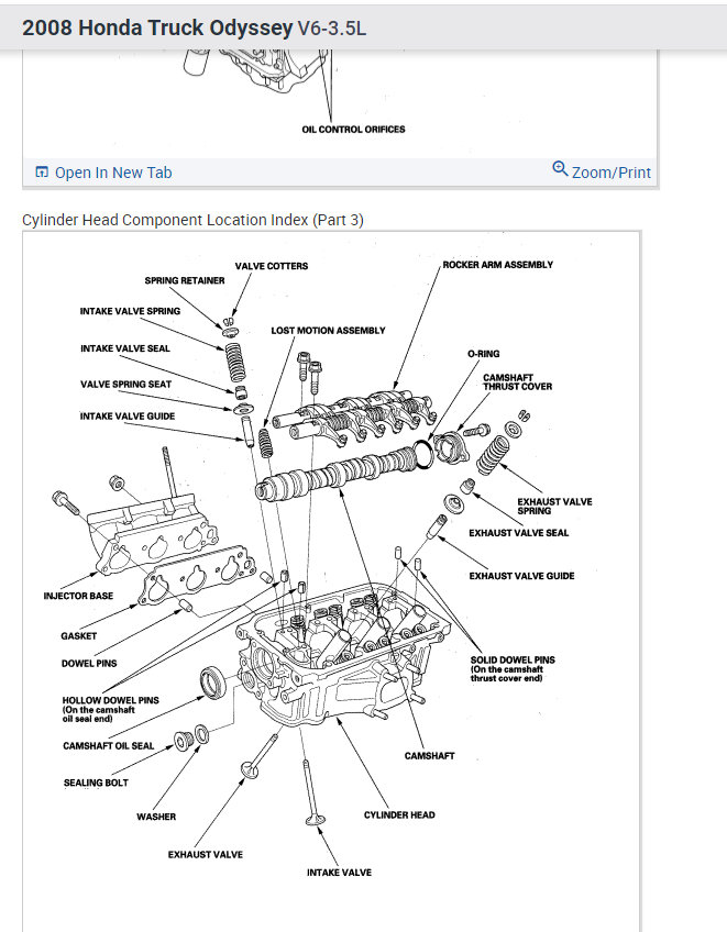

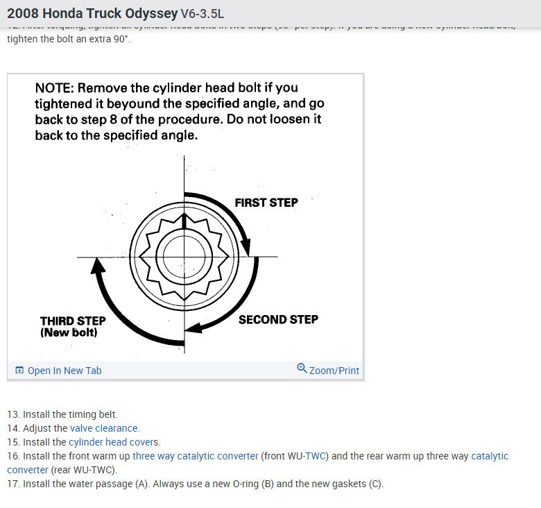

First step would be to get the cylinder head off the vehicle. Then you will have better access to the valves. Keep in mind that in some cases the valves can strike the top of the pistons and damage that as well.
After removing the head if there is damage to the valves you will have to get new valves and have the cylinder head inspected by a machine shop. They can use specialized machines to perform that task.
https://www.2carpros.com/articles/how-a-cylinder-head-works

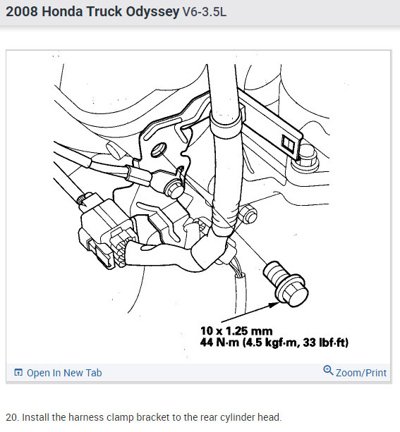

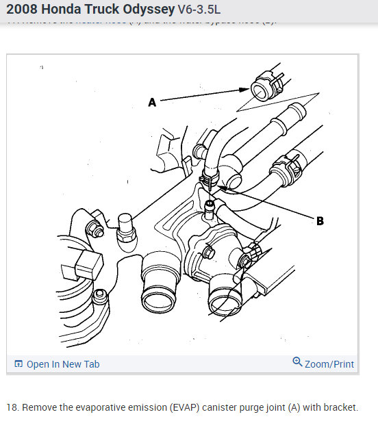

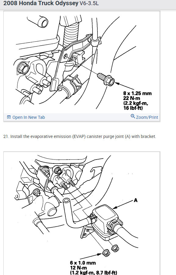

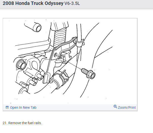

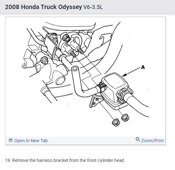

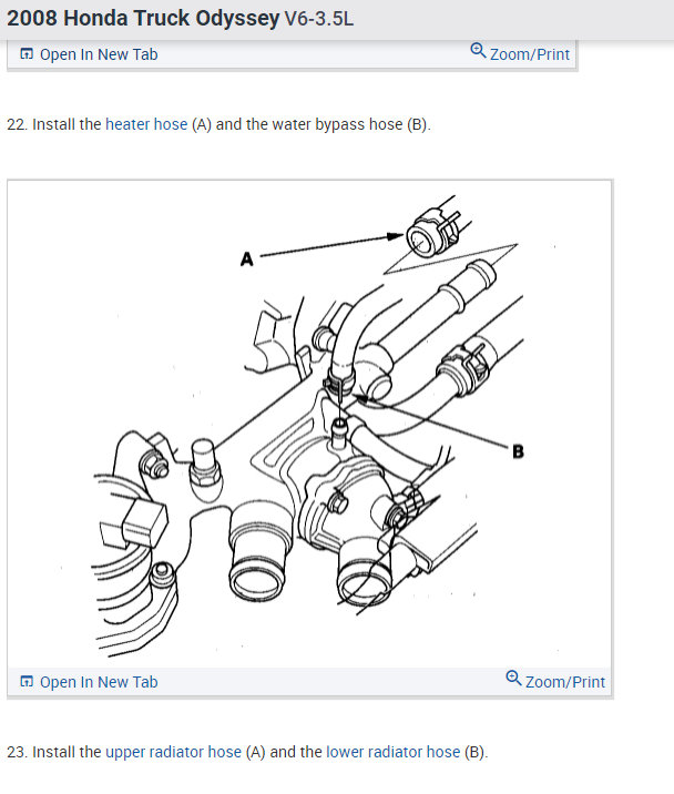

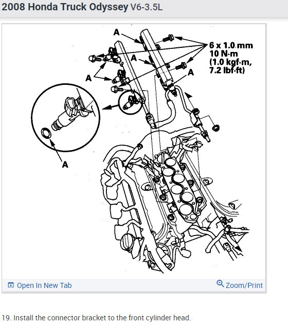

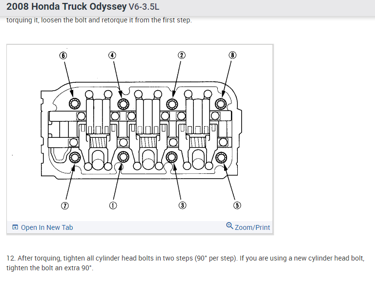

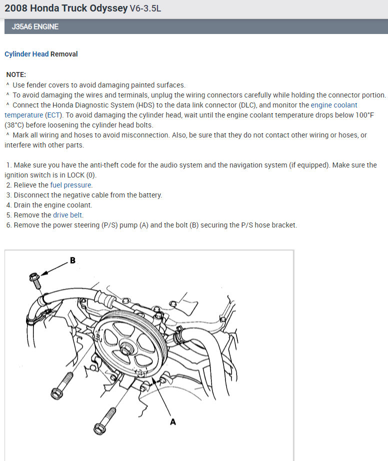

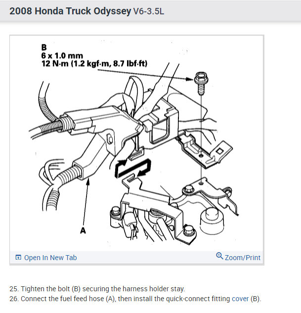

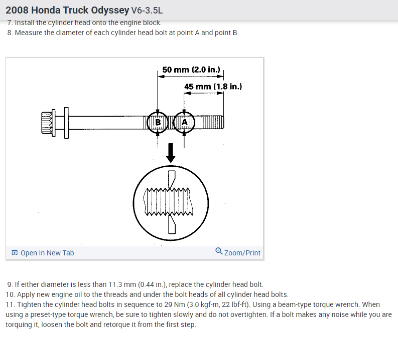

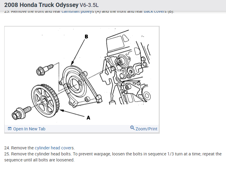

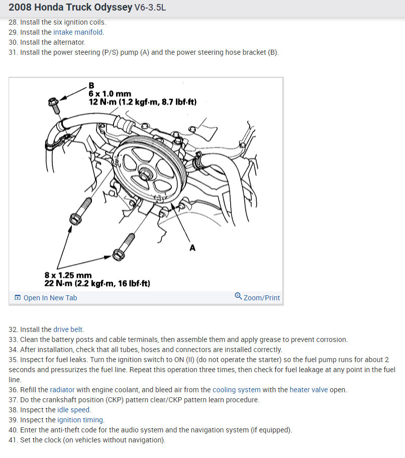

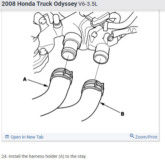

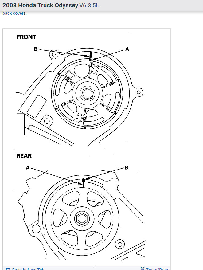

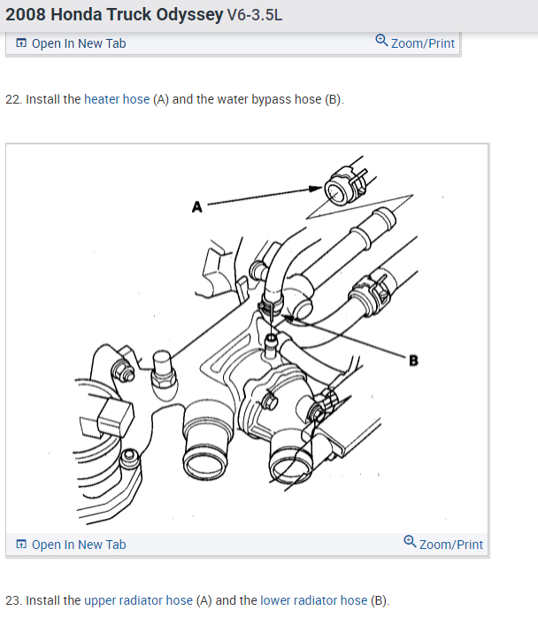

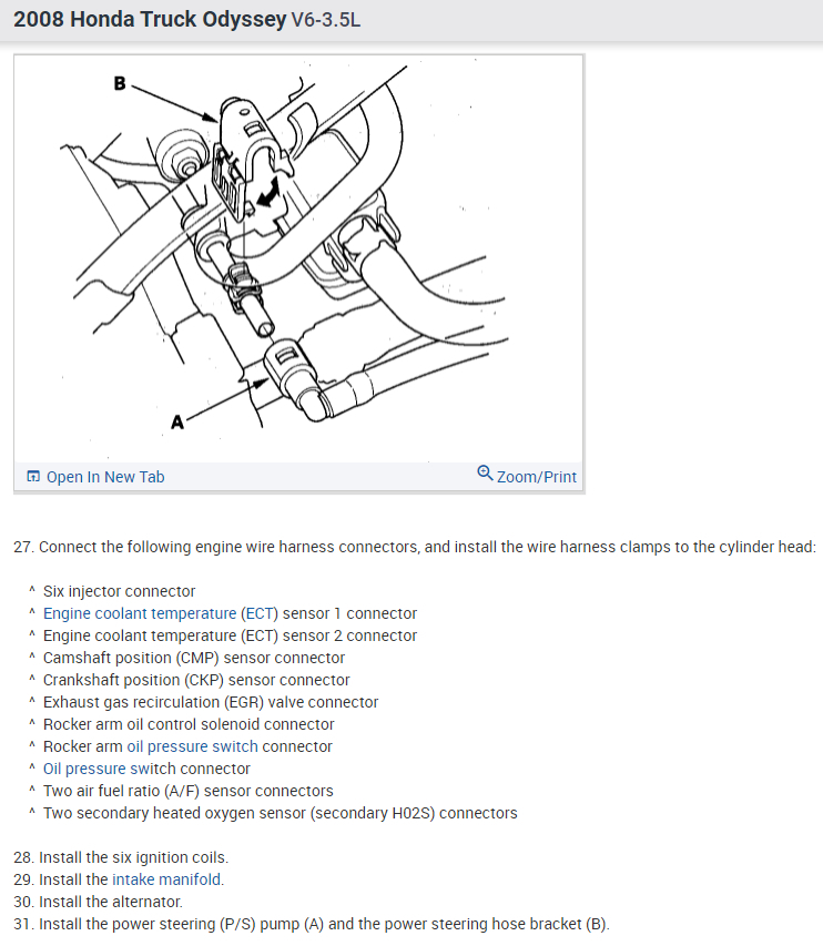

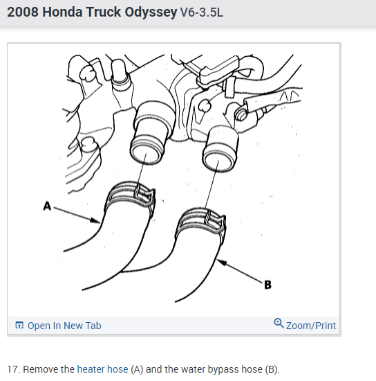

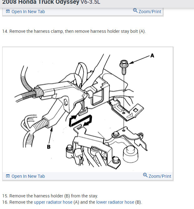

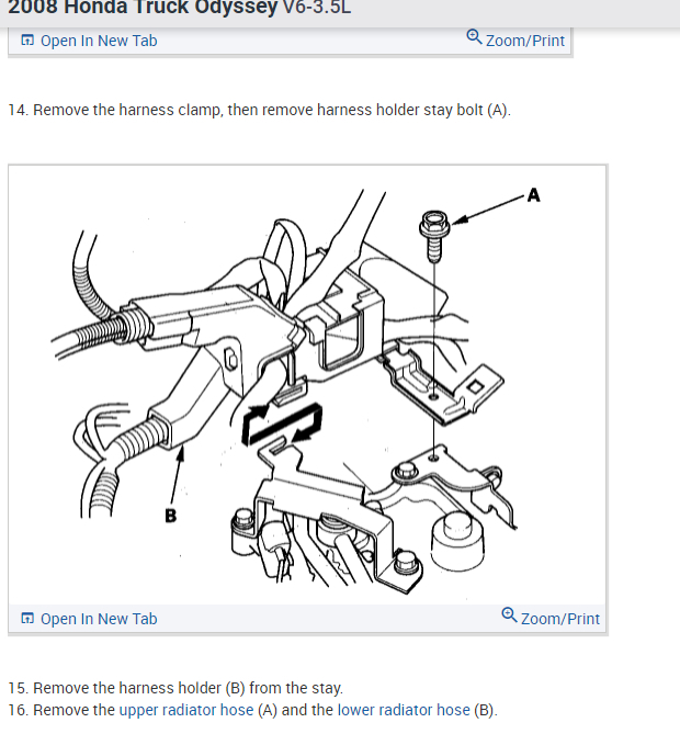

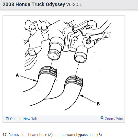

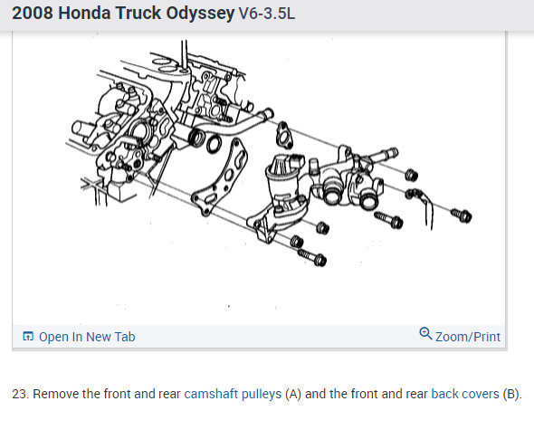

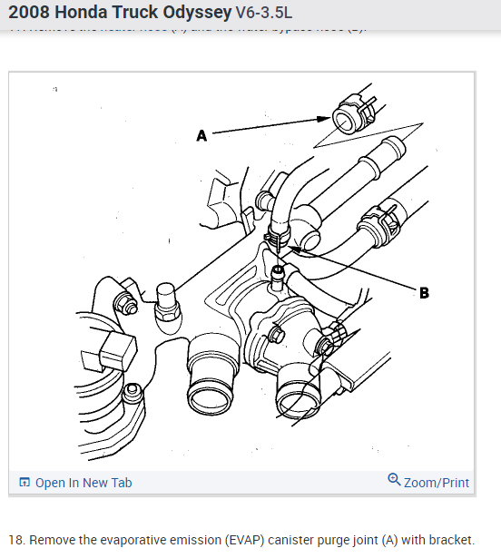

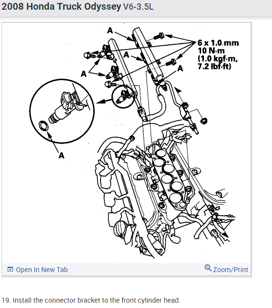

I have attached the cylinder head replacement procedure below.
Let me know what you find.
Thank you.
