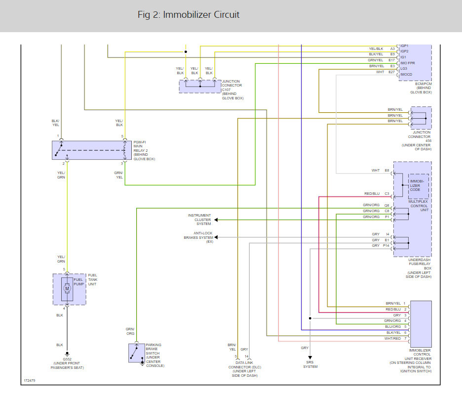

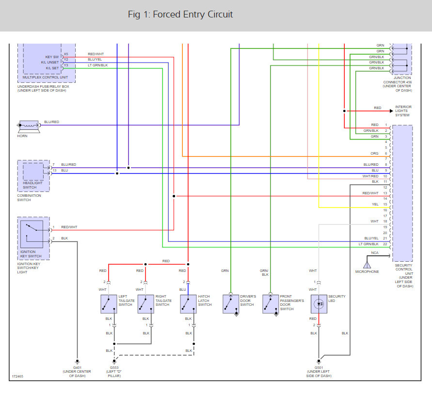

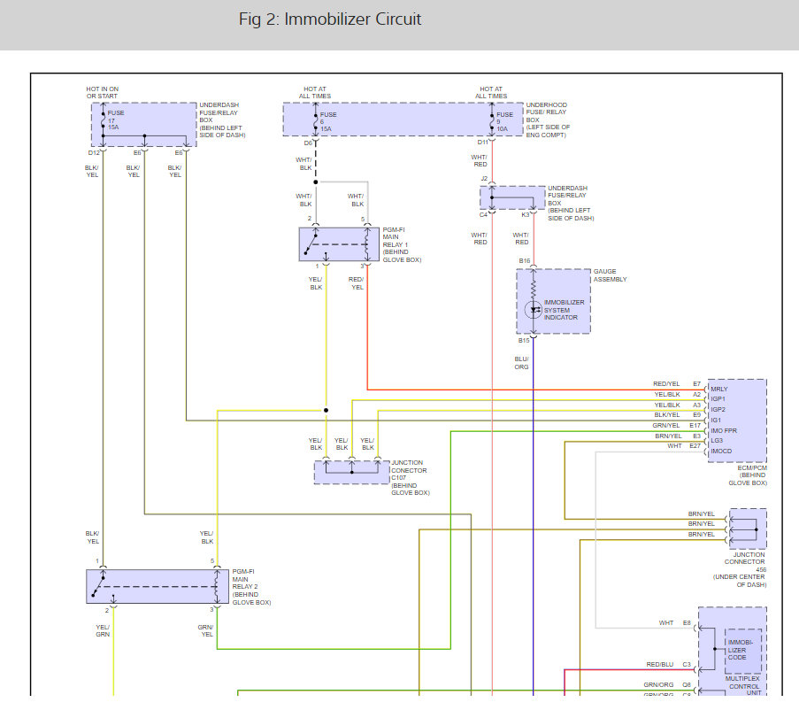

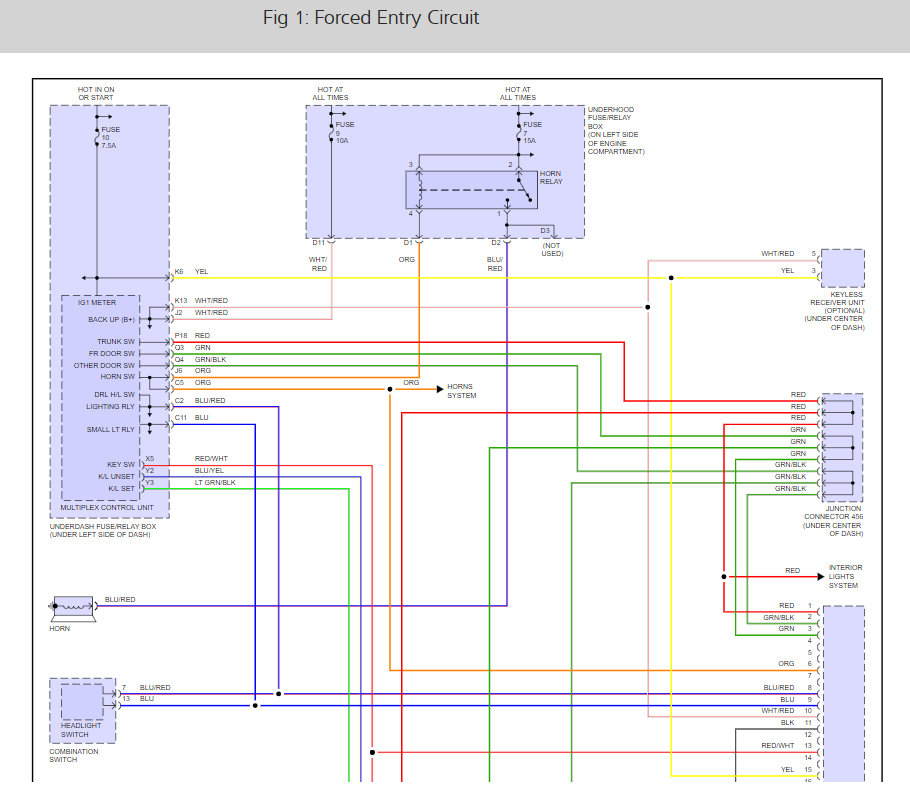

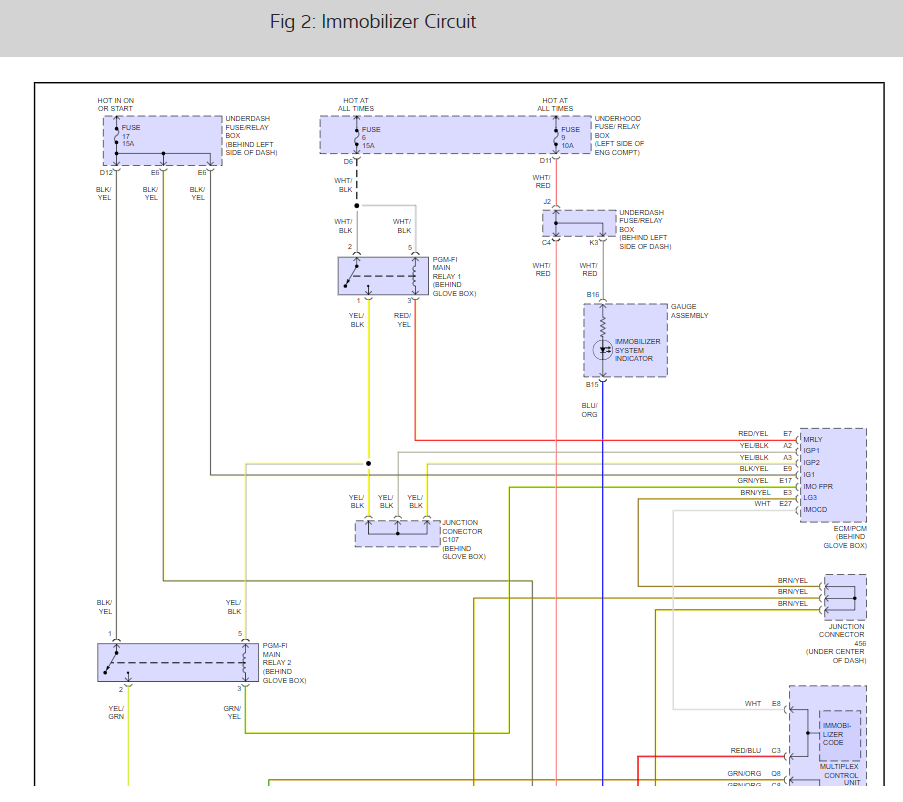

Can I ask if the engine is turning over and not starting or the starter is not working? Also is the security light flashing? There is no hidden switch. Here are the security system wiring diagrams so you can see how the system works. Check out the diagrams (below). Please let us know what happens.
