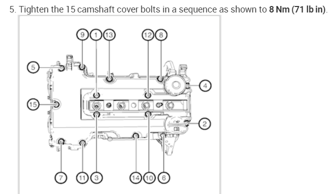

What are the torque specs for the car listed above's valve cover?
Aug 6, 2020 at 9:47 PM
DANNY L
  • 5,648 POSTS
Hello, I'm Danny.
Here is the information you requested.The torque specification is 8 Newton Meters or 71 Inch Pounds. I've attached a picture below showing the proper torque sequence of the bolts. Here is a valve cover replacement tutorial:
