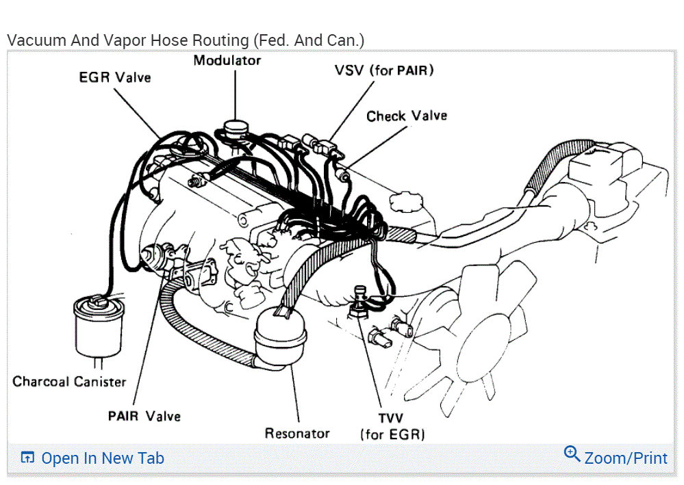

Have the truck listed above with a 1993 22R-E. Had a mechanic has put on a new carburetor and it's still flooding. He told me that a vacuum line can cause it to flood. where can i get copy of the diagram that shows' how the vacuum lines go on a 1993 22R-E.

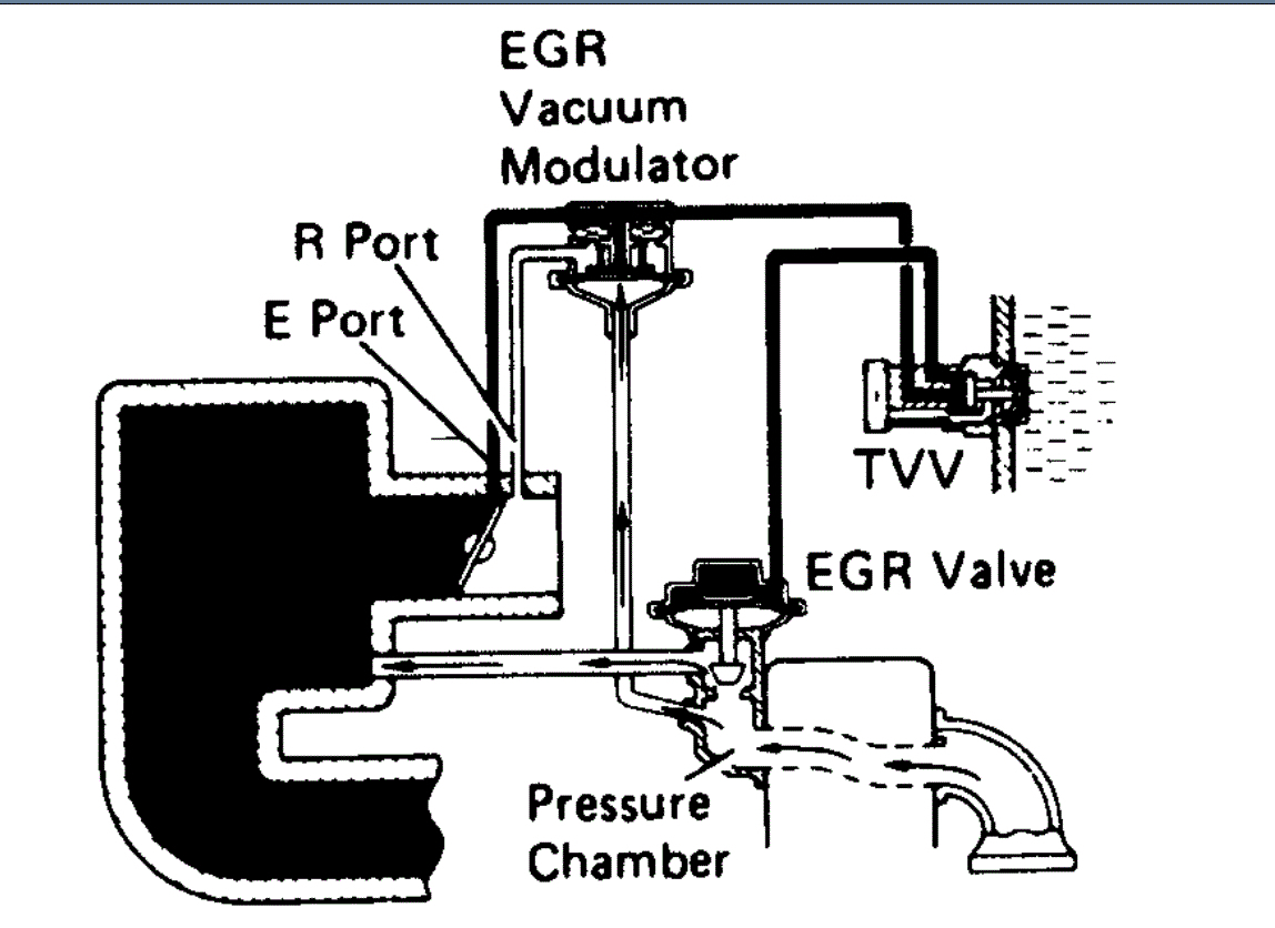

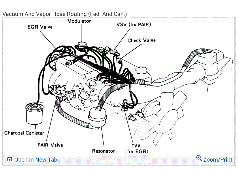

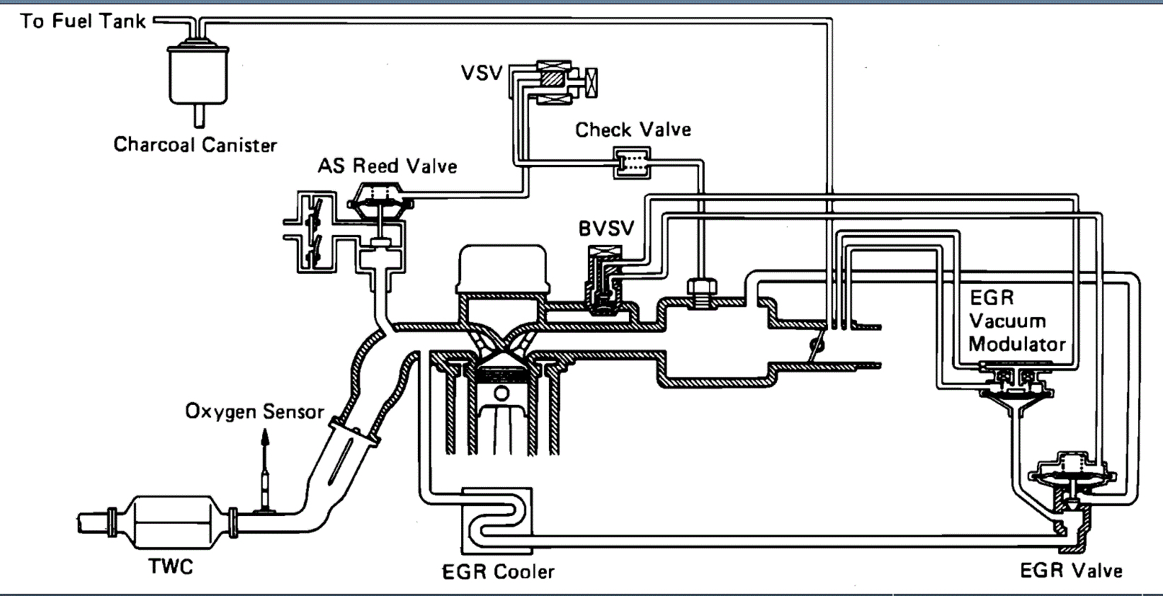

Hi Larry,
Since the 1987 was carbureted and the 1993 is fuel injected, this is going to be a tricky one for me.
I attached the vacuum schematics I have for the 1993. I don't see how a vacuum leak is causing flooding. Are you sure the float is set properly in the carburetor? Is the choke fully opening? There is a vacuum fuel shut off that is actuated when decelerating, but that shouldn't cause a problem at idle. Also, that is a standard on the 1987. LOL
Tell me as much as you can about what is happening and what has been done. What has been changed on the 1993 engine to make it work in the 1987? I'll try my best to help.
