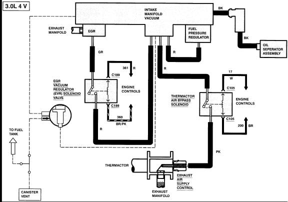

Need to know where the vacuum lines hook up coming out of the intake manifold. Specifically there is an elbow that has three connections that hooks to the manifold. Need to know where they go to.

This diagram is for the dual-cam 3.0L engine. Check out the diagrams (Below). Please let us know if you need anything else to get the problem fixed.
