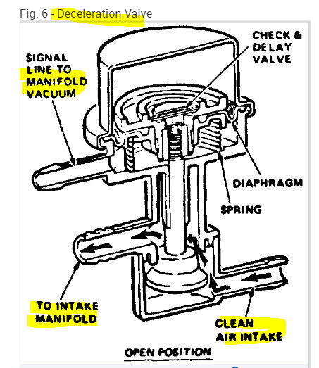

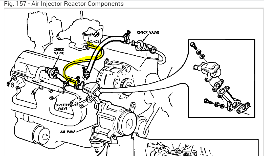

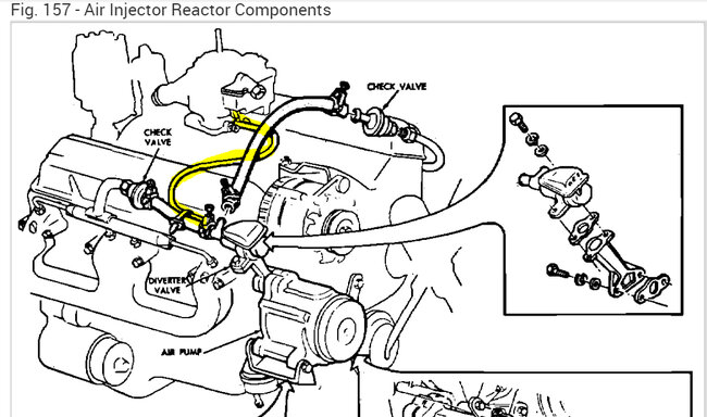

Because of the model year, I basically have little to nothing. I attached what I was able to find for the air injection and the deceleration valve. I know there has to be one for the vacuum advance. Usually, that is a ported vacuum and comes from the carb.
Take a look at what I attached. Let me know if you have any specific questions, I'll try my best to help.

I believe what you are showing is from a 73 that we used to call a smog pump. I do not have that.
Sep 9, 2023 at 3:43 AM

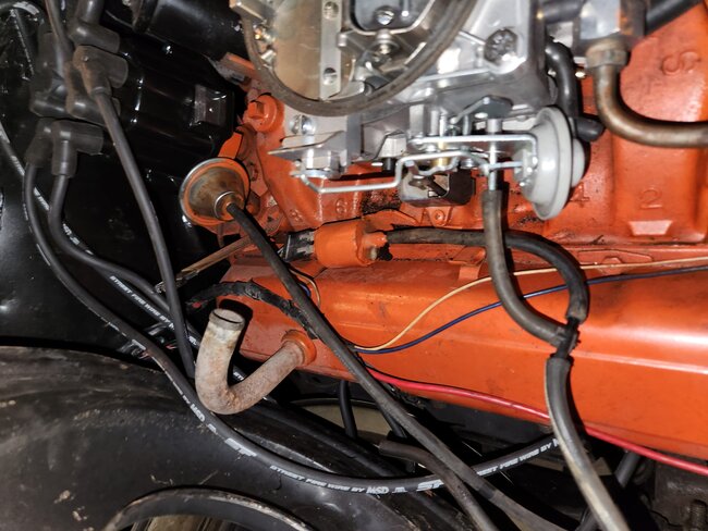

Wow, that looks great!!! Most hoses looked connected. Are there certain ones you are having an issue with?

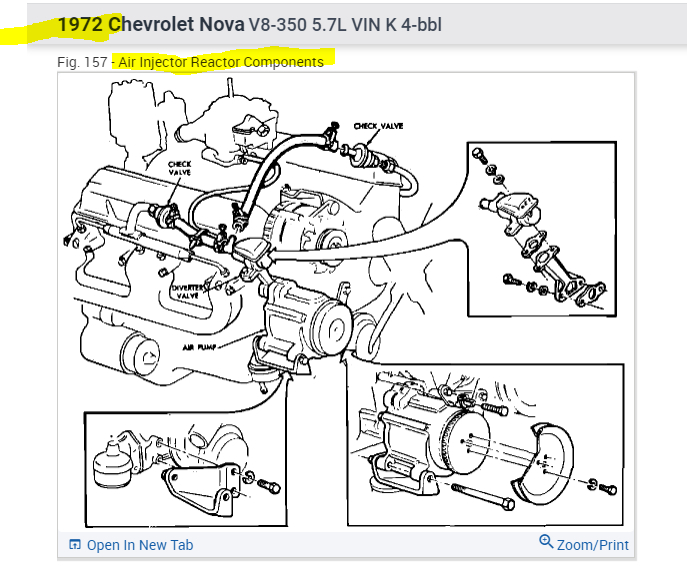

Also, the pics I sent indicated 1972, so I'm not sure. See pic 1 below.

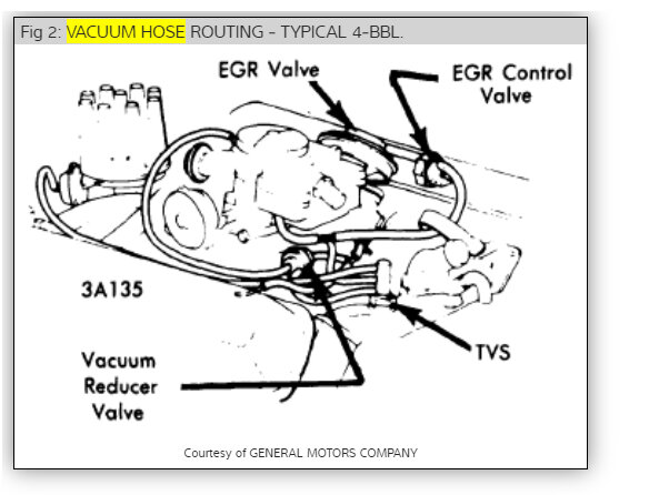

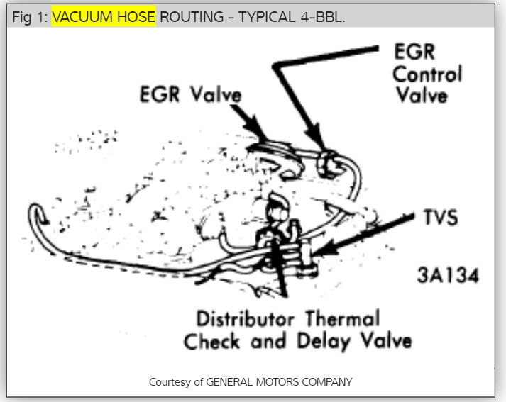

I was able to find two more schematics in a different manual. One is for the vacuum advance and the other is for the EGR. (see pics 2 and 3)
Let me know if they help at all.
