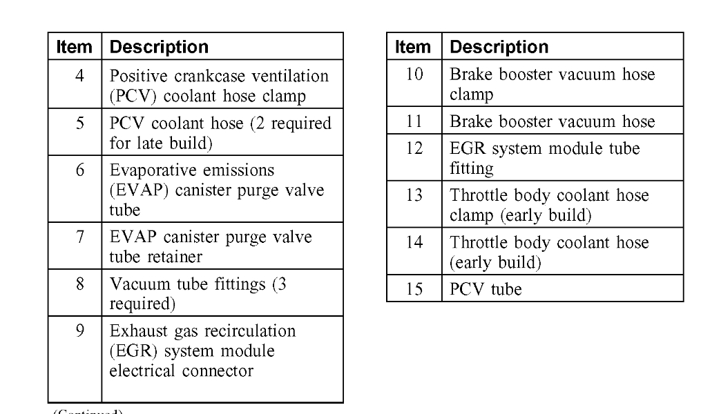

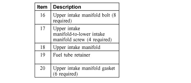

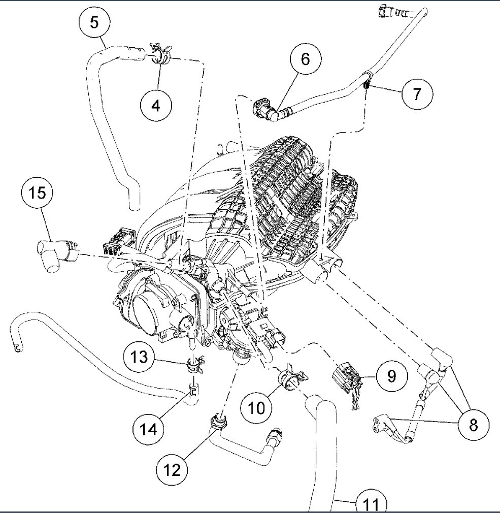

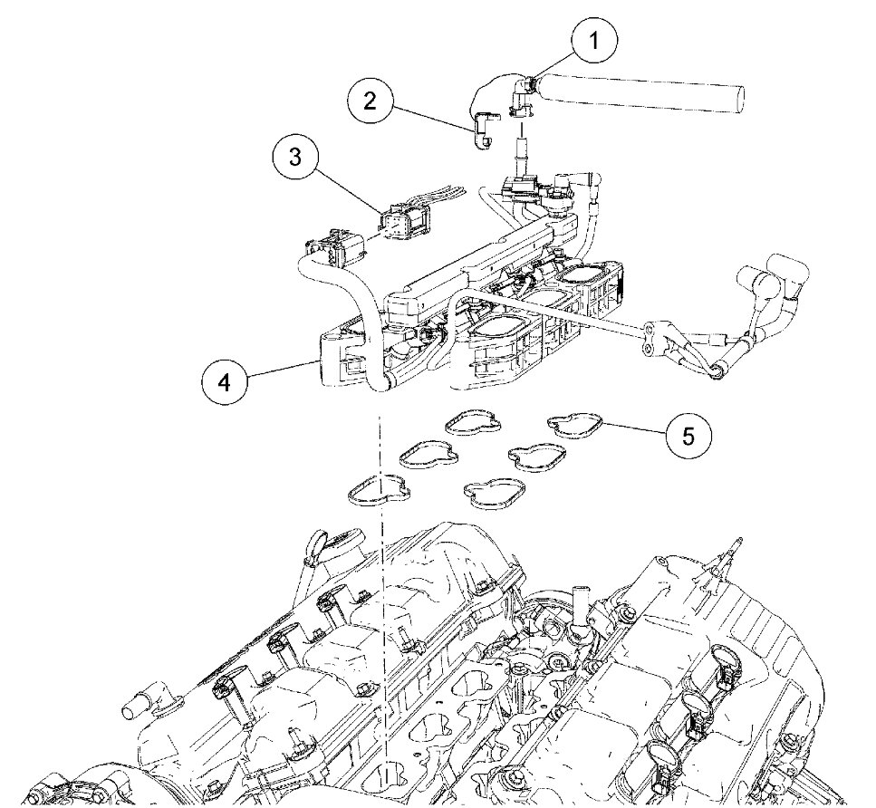

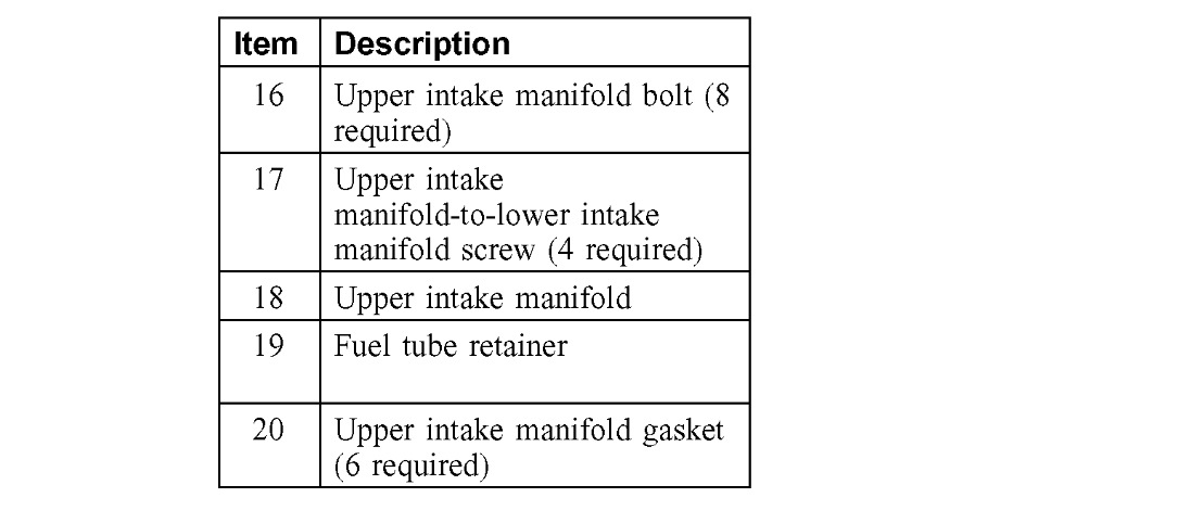

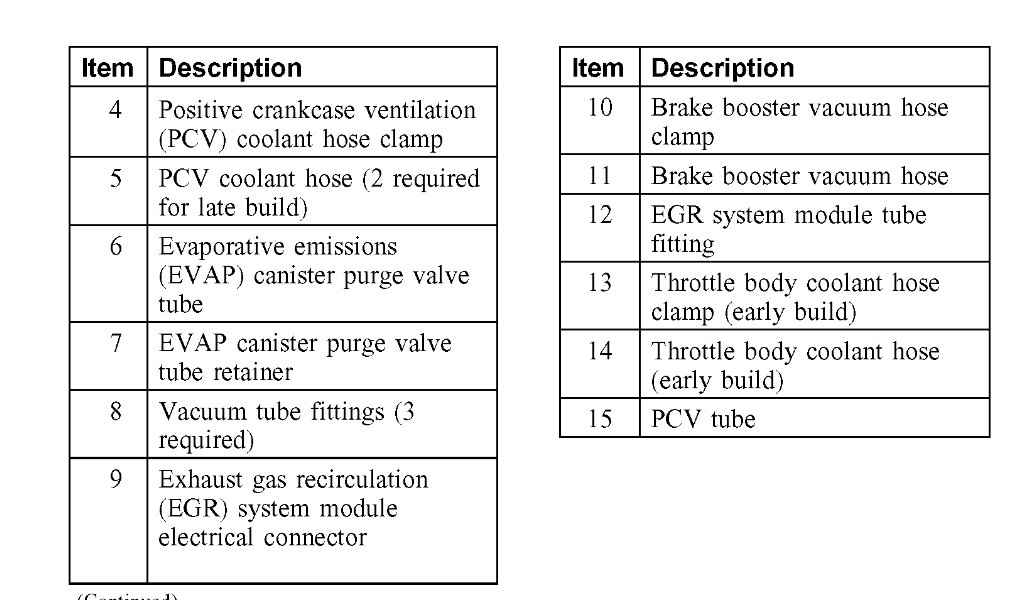

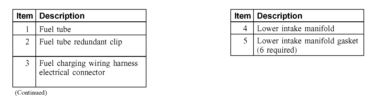

The 1st and 2nd diagrams are the Lower section of the Intake manifold, it rests between the two valve covers in the valley of the V6 engine.

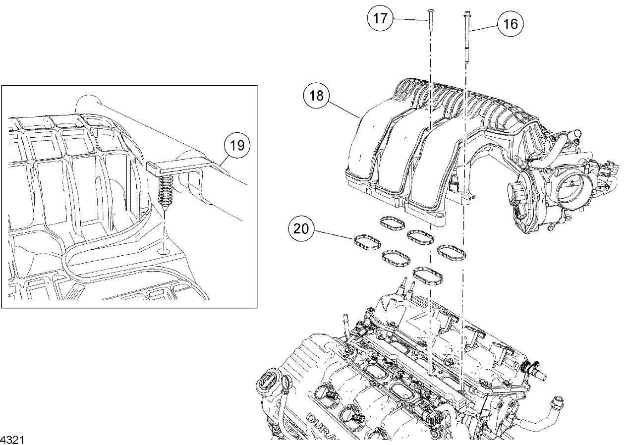

Diagrams 3 and 4 are the Upper Intake Manifold (plastic) from more of a front view, at the bottom of the picture you can see the oil fill cap and oil dipstick.
Diagrams 5 and 6 are a side view of the Upper Intake manifold. This is where most of the vacuum hoses, hose to the Brake Booster (11), the Throttle Body just above the number 13 is where the air intake tube from the air filter box will come to.
