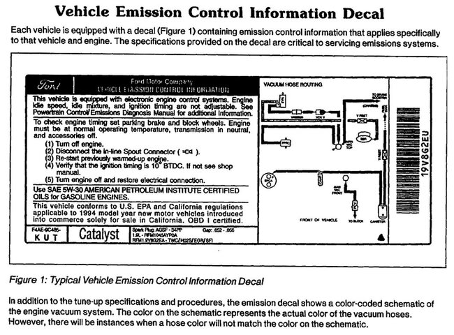

i have the truck listed above stock i want to change out the vacuum line's is there a diagram anywhere? i see the one under the hood but I'm just a little confused I'm unsure how to read it. It is color coded but the issue for me is some things have splits and so on. thanks, take care.
