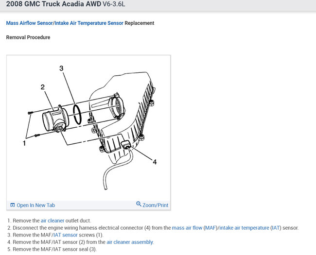

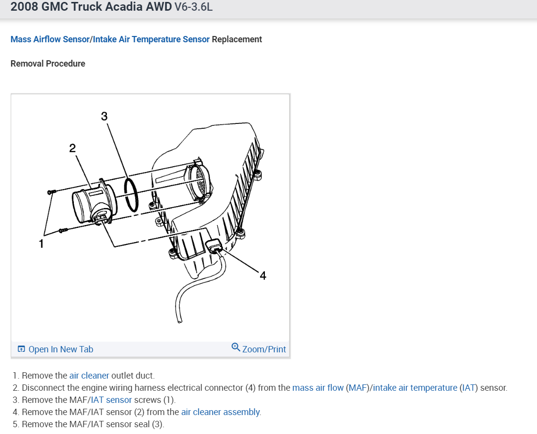

I would check the fuel pressure because you may have a weak fuel pump or the MAF sensor needs to be replaced.
Fuel Pressure (Key ON, Engine OFF) .................... 384-425 kPa (56-62 psi)

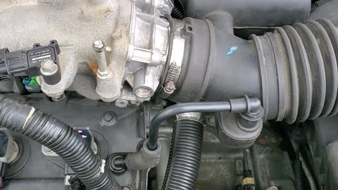

You can get a fuel pressure test kit from the auto parts store, they rent them for cheap or free. Here is the location of the MAF sensor so you can change it out. Can you please shoot a quick video with your phone so I can hear the engine running? That way I can tell for sure what's going on. You can upload it here with your response. Check out the images (below). Please let us know what happens.
