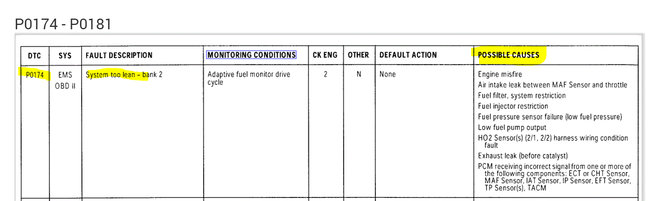

If you are standing in front of the vehicle with the hood open, bank two of the engine is in the right side. See pic 1 below.

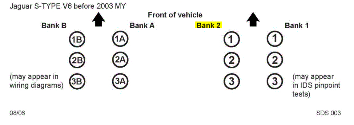

As far as the code, when you only have one side of the engine with a lean mixture, it limits possibilities. See pic 2

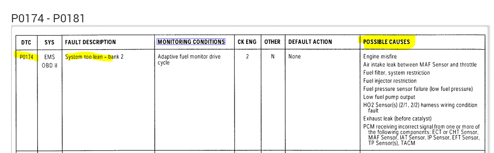

See pics below.
