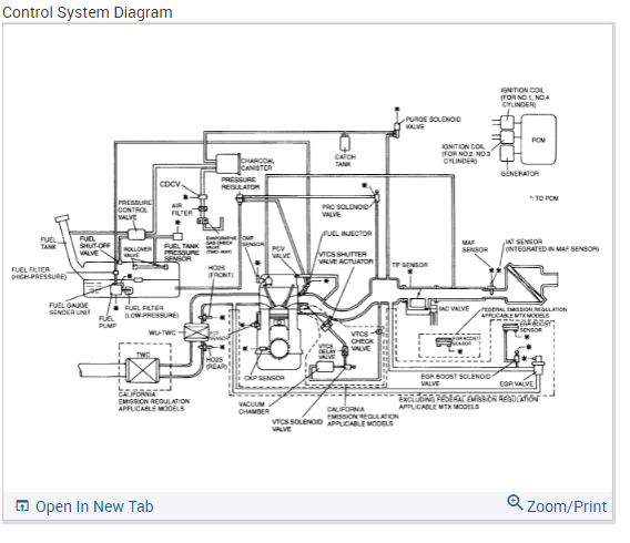

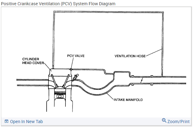

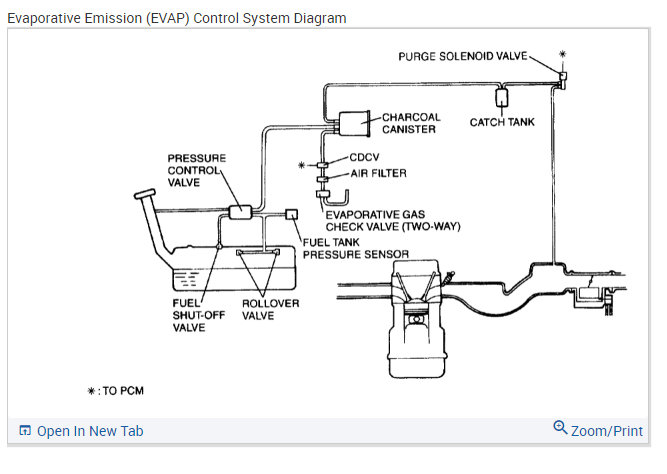

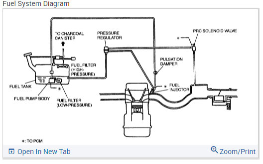

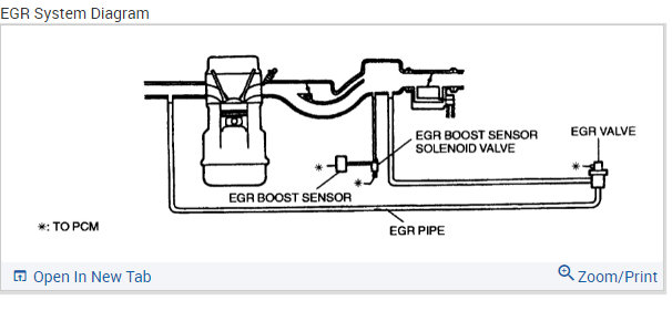

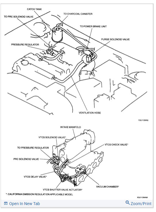

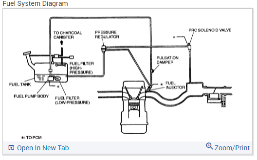

Can someone send me a clear diagram of the vacuum routing?
Jul 5, 2021 at 10:41 PM
SQM
  • 6,383 POSTS
Please attached for various vacuum diagrams.
Let me know if you have any questions.
Thank you.
