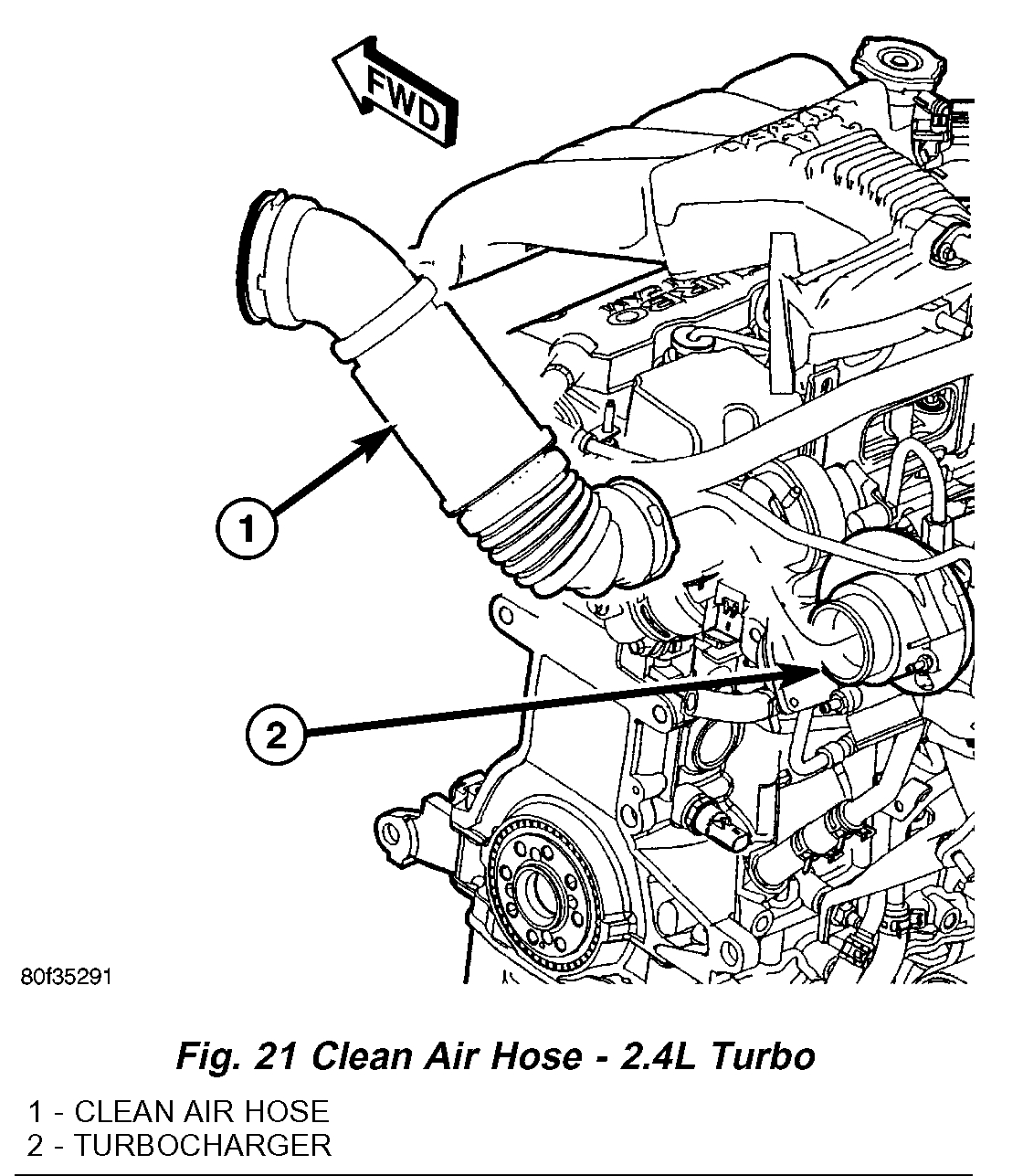

4. Disconnect clean air hose from turbocharger (Fig. 21).

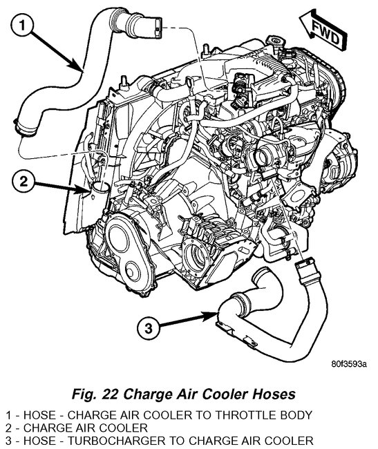

7. Disconnect air inlet hose at throttle body (Fig. 22).

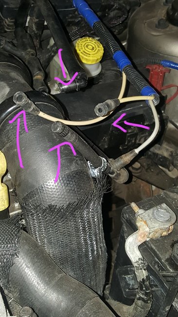

8. Disconnect vacuum hoses at throttle body and upper intake manifold.

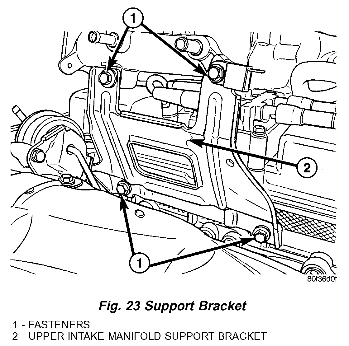

9. Remove upper intake manifold support bracket (Fig. 23).

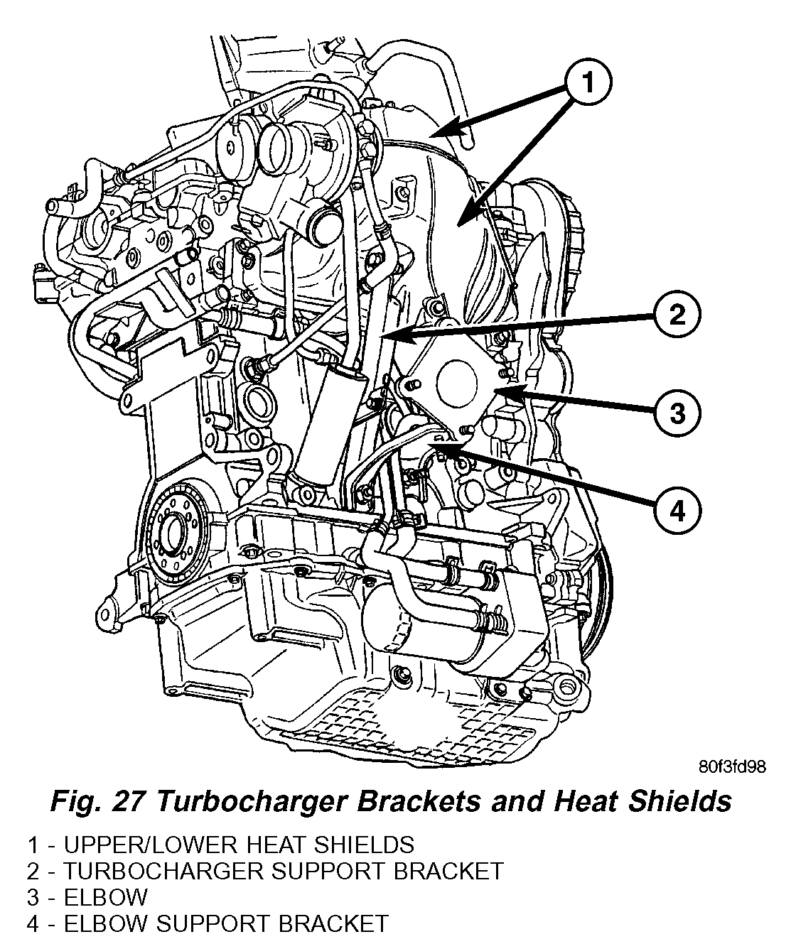

11. Remove turbocharger upper heat shield (Fig. 27).

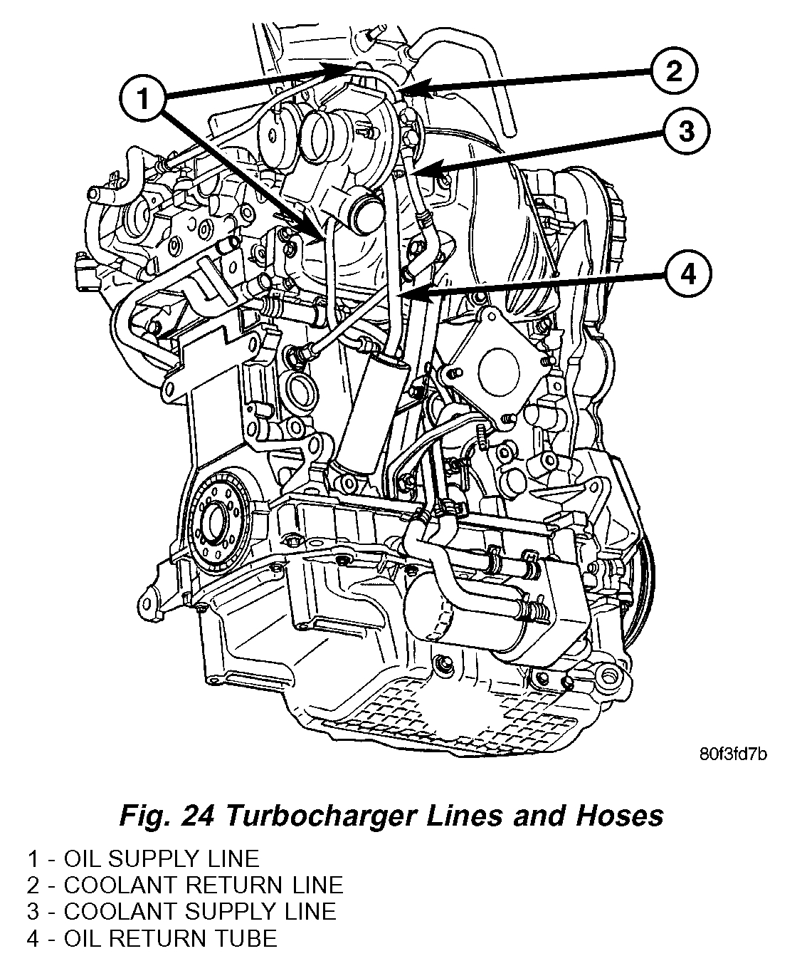

12. Disconnect oil supply line at turbocharger (Fig. 24).
13. Remove coolant return line (Fig. 24).

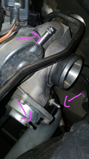

14. Disconnect vacuum hoses from turbocharger.

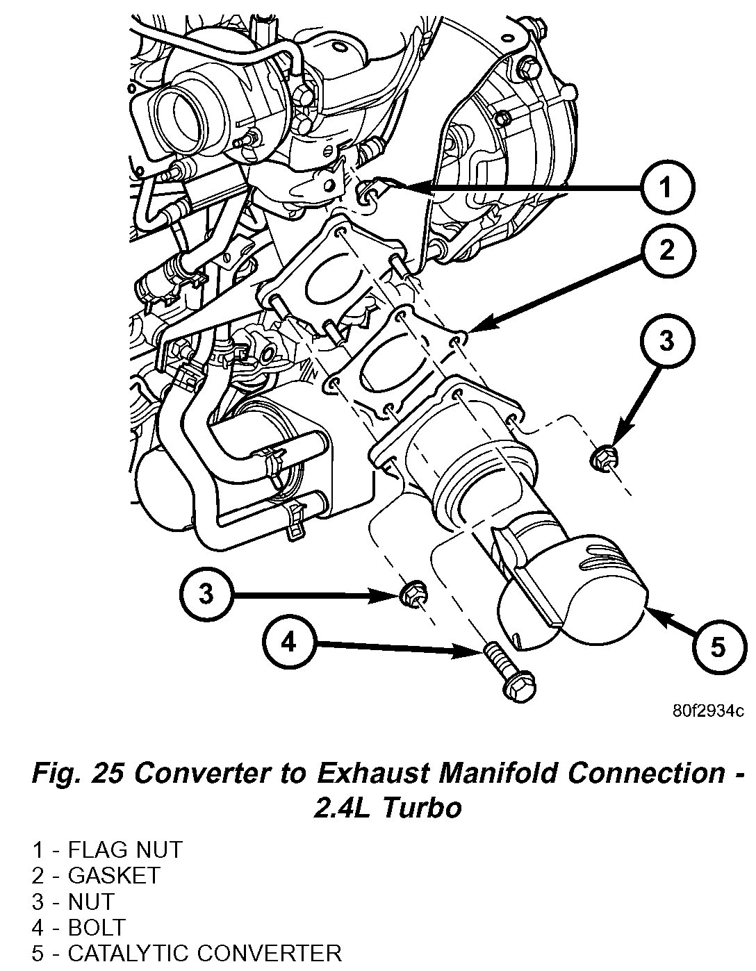

18. Remove fasteners securing catalytic converter to exhaust manifold (Fig. 25).
19. Remove catalytic converter and intermediate pipe as an assembly.

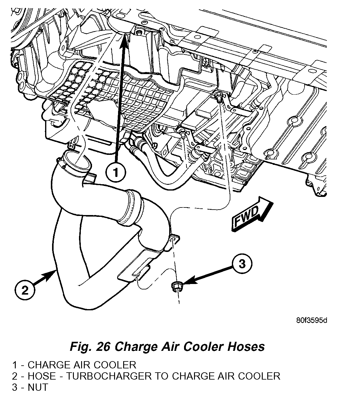

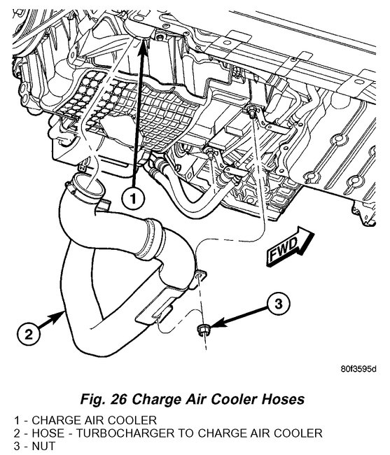

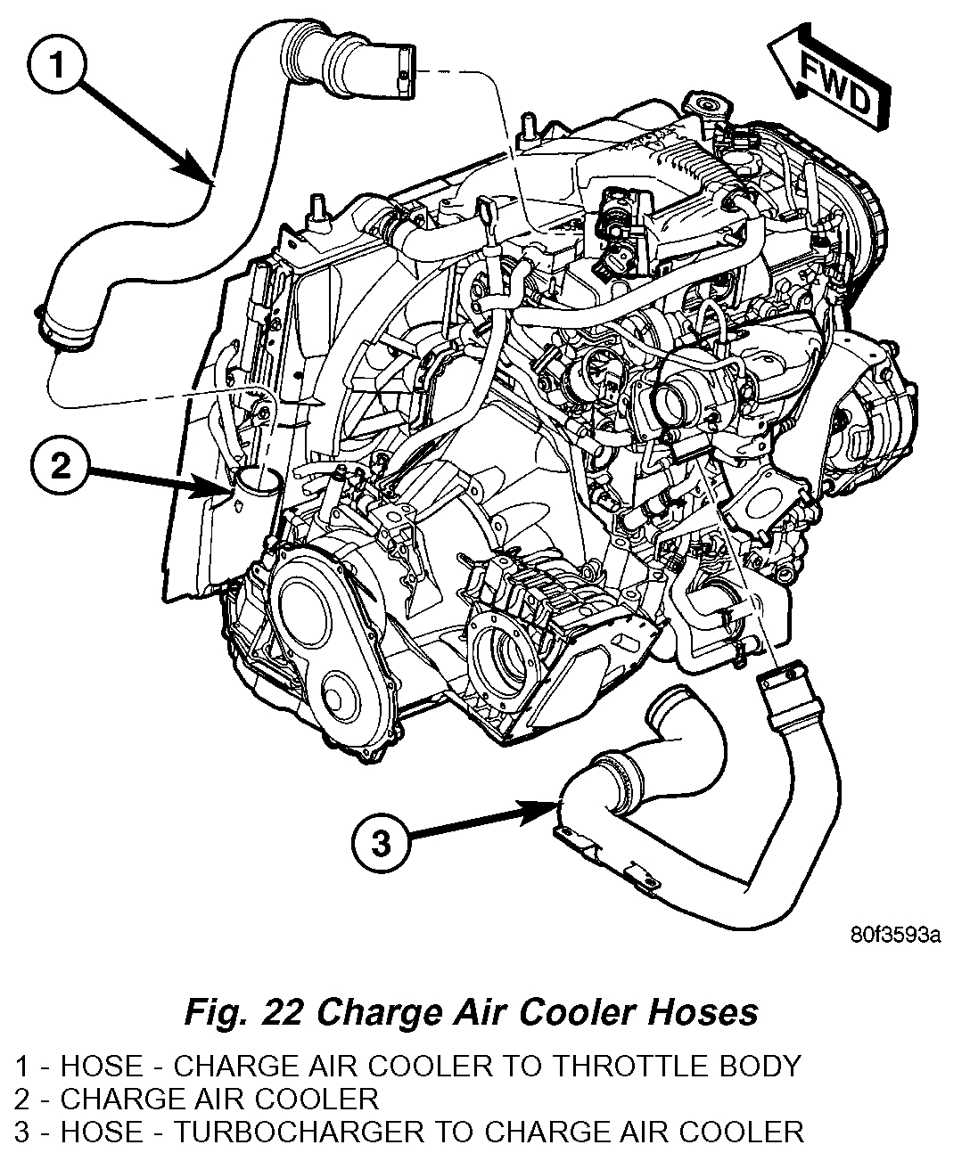

20. Remove turbocharger to charge air cooler hose assembly (Fig. 26).
21. Remove turbocharger elbow support bracket (Fig. 27).
22. Remove turbocharger support bracket (Fig. 27).
23. Remove oil return tube (Fig. 24).
24. Remove turbocharger coolant supply line (Fig. 24).
25. Remove turbocharger lower heat shield (Fig. 27).
26. Remove turbocharger elbow (Fig. 27).

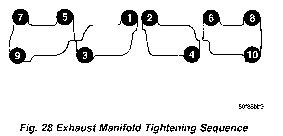

3. Position turbocharger/exhaust manifold assembly in place. Gradually tighten fasteners, starting at center and progressing outward in both directions to 28 Nm (250 in. lbs.) (Fig. 28). Raise and lower vehicle for fastener access as necessary Repeat tightening procedure until all fasteners are at specified torque.
4. Install turbocharger elbow. Torque fasteners to 28 Nm (250 in. lbs.) (Fig. 27).
5. Install turbocharger lower heat shield. Torque fasteners to 28 Nm (250 in. lbs.) (Fig. 27).

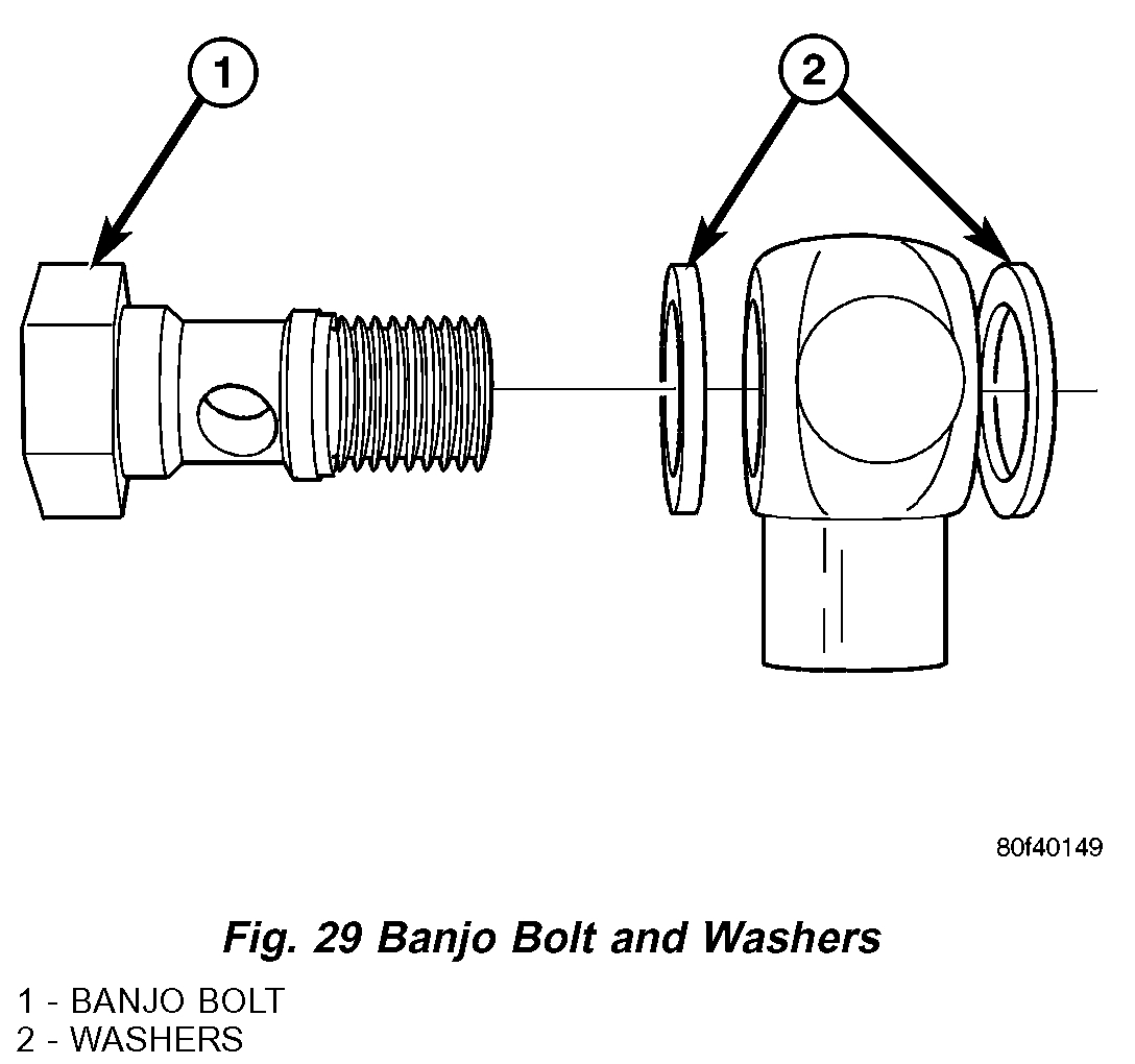

6. Install turbocharger coolant supply line. Install NEW washers (Fig. 29). Torque banjo fitting bolt to 30 Nm (22 ft. lbs.). Torque flared fitting to 31 Nm (23 ft. lbs.) (Fig. 24).
7. Replace oil return tube gasket. Install oil return tube. Torque fasteners to 12 Nm (105 in. lbs.). Make sure heat shield for oil return line is properly installed (Fig. 24).
8. Install turbocharger support bracket. Torque M8 fasteners to 28 Nm (250 in. lbs.) and M10 fasteners to 54 Nm (40 ft. lbs.) (Fig. 27).
9. Install turbocharger elbow support bracket (Fig. 27).
10. Install turbocharger to charge air cooler hose assembly (Fig. 26).

12. Install fasteners securing catalytic converter to exhaust manifold (Fig. 25). Torque fasteners to 28 Nm (250 in. lbs.).

17. Install coolant return line. Install NEW washers (Fig. 29). Torque banjo fitting bolt to 30 Nm (22 ft. lbs.) (Fig. 24).
18. Connect oil supply line at turbocharger. Torque flared fitting to 31 Nm (23 ft. lbs.) (Fig. 24).
19. Install turbocharger upper heat shield. Torque fasteners to 28 Nm (250 in. lbs.) (Fig. 27).

21. Install upper intake manifold sup port bracket (Fig. 23).

23. Connect air inlet hose at throttle body (Fig. 22).

26. Connect clean air hose to turbocharger (Fig. 21).
