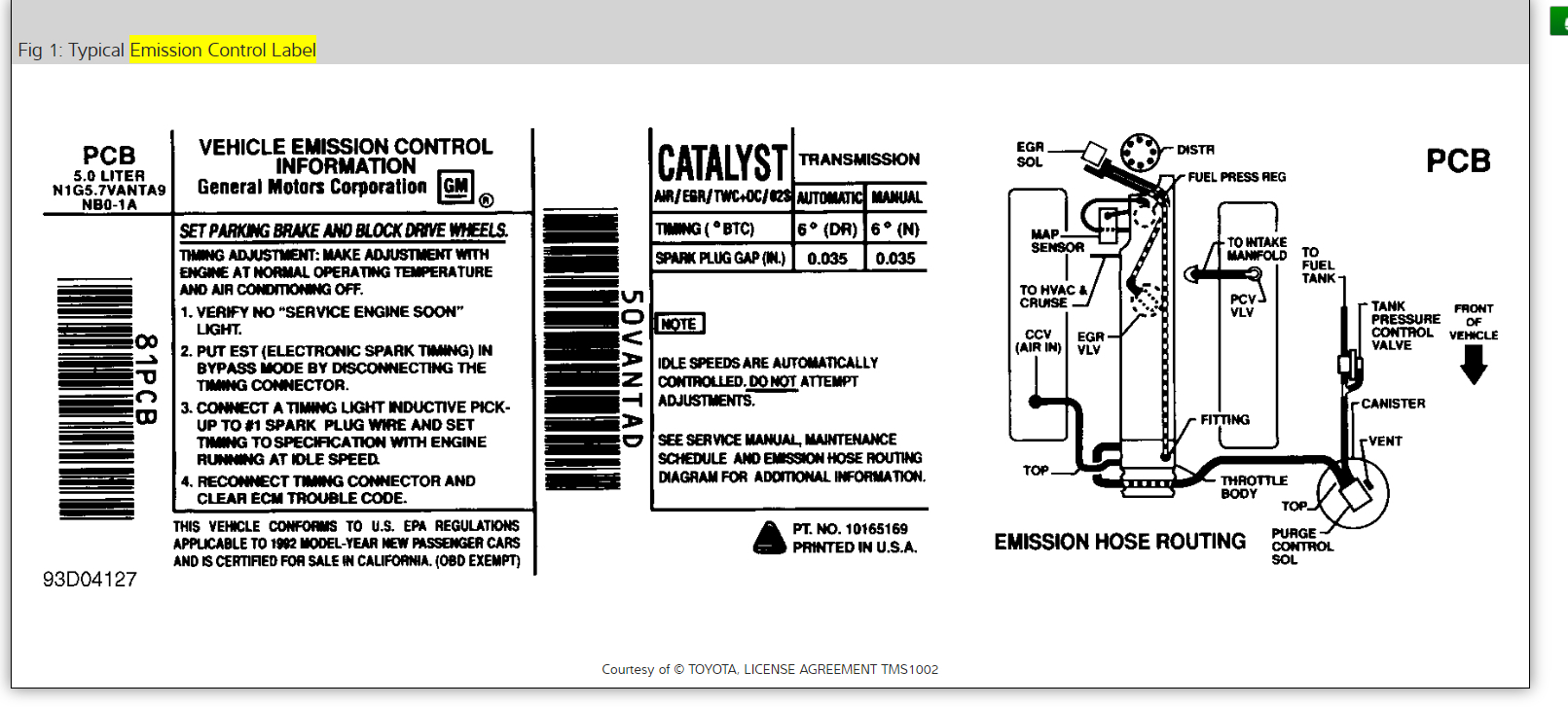

Can you provide a complete vacuum diagram for the vehicle listed above?

Here is the engine vacuum line routing diagram below. Check out the diagrams (below). Please let us know if you need anything else to get the problem fixed.

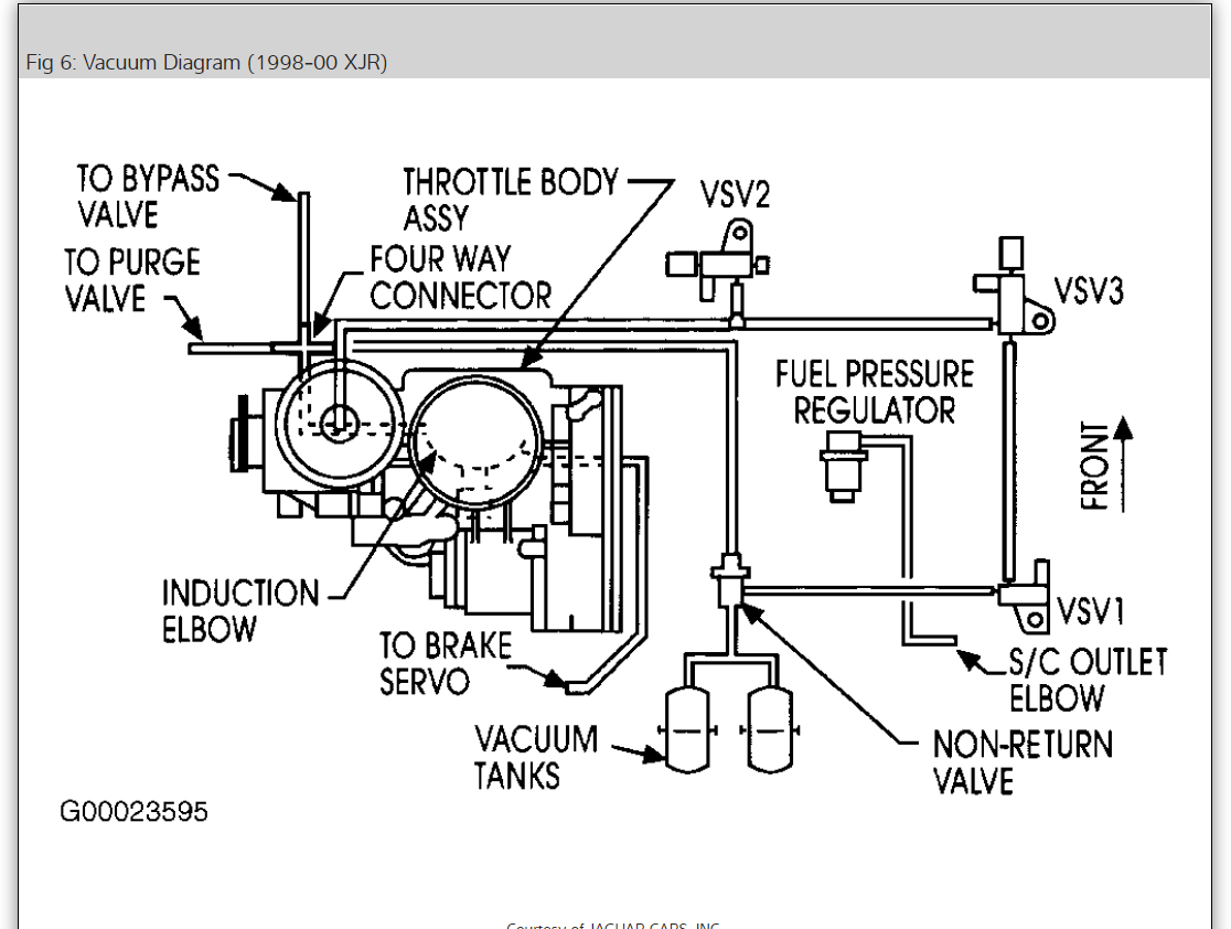

Ken, can you put your hands on the one for the 1998-2003 Jaguar XJ8 4.0LV8?

Yep got the vacuum line diagrams for you. Check out the diagrams (below). Please let us know if you need anything else to get the problem fixed.
