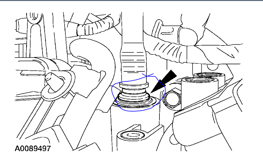

To the best of my knowledge, which is just a connector and serves no other purpose. You may need to find one in a salvage yard.

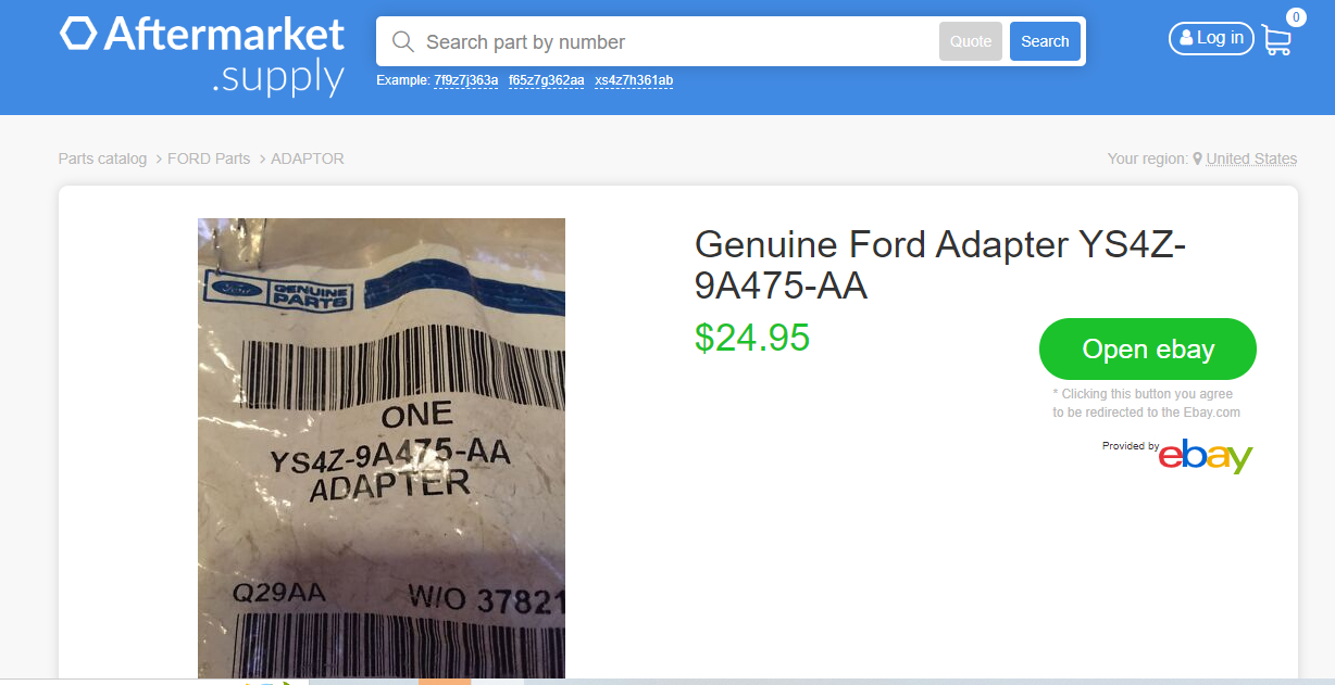

I tried finding one for you and the best I found is attached below. If you go to their page, there is contact info at the bottom of the page.
Here is the link:
https://aftermarket.supply/ford/ys4z9a475aa.html
Also, please confirm I'm looking for the correct part. See pic 2. If you are unable to find one, take a pic of what you are dealing with and upload it for me to see. Maybe I'll come up with a solution.
See pics below.
