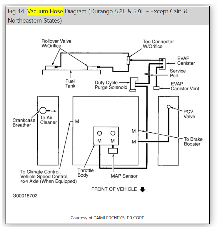

I need a vacuum diagram. I blew my motor didn't have time to do the work myself to replace. After buying a motor in paying the habit put in have spent $1,500.00 including extra parts got the truck back Mrs. Bad on 7 cylinder and doesn't runs badly. Several of the vacuum lines of been plugged or moved from what they were originally a suspect that problem. Does anyone have a diagram for this motor?

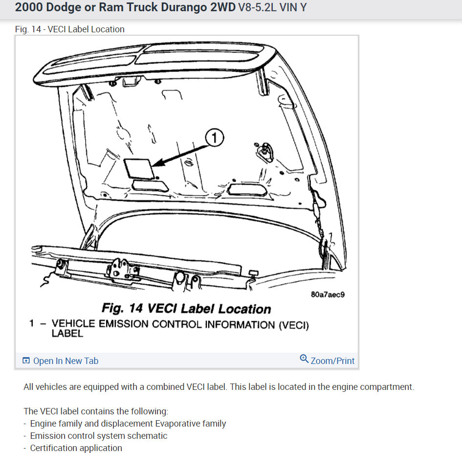

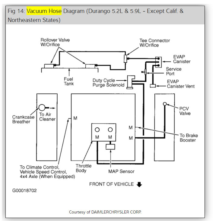

They say the vacuum hose label is under the hood but I found one too. Check out the diagrams (below). Please let us know if you need anything else to get the problem fixed...................................................
