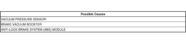

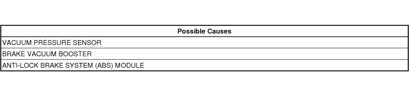

below is a description of the code and possible failures.
Has anyone checked this out and given you suggestion? I looks like a vacuum issue. are there any broken or missing hoses from the engine?
C1082-02-VACUUM PRESSURE SENSOR - GENERAL SIGNAL FAILURE
