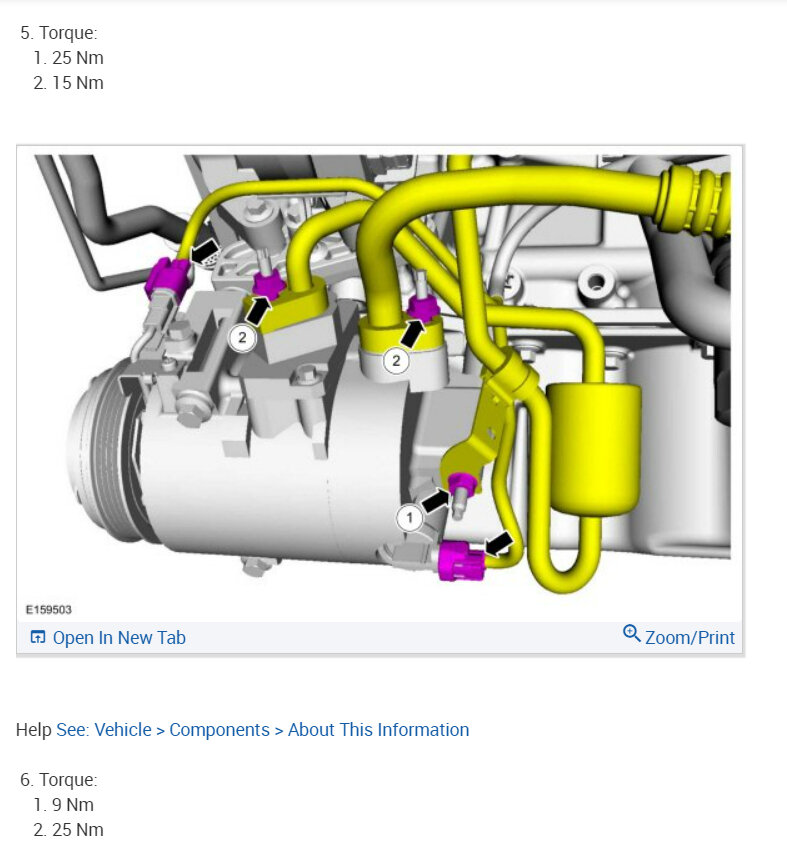

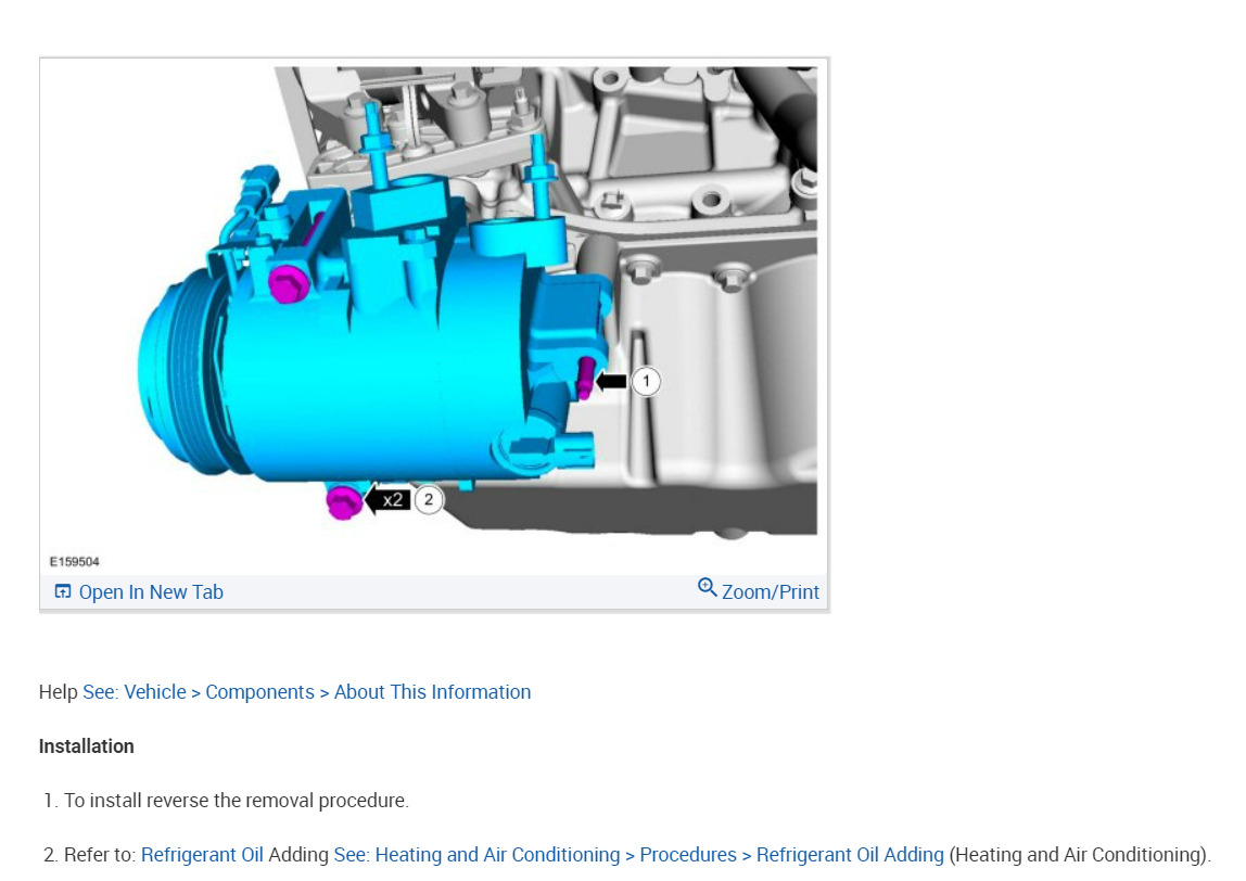

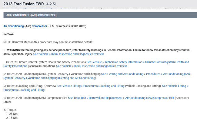

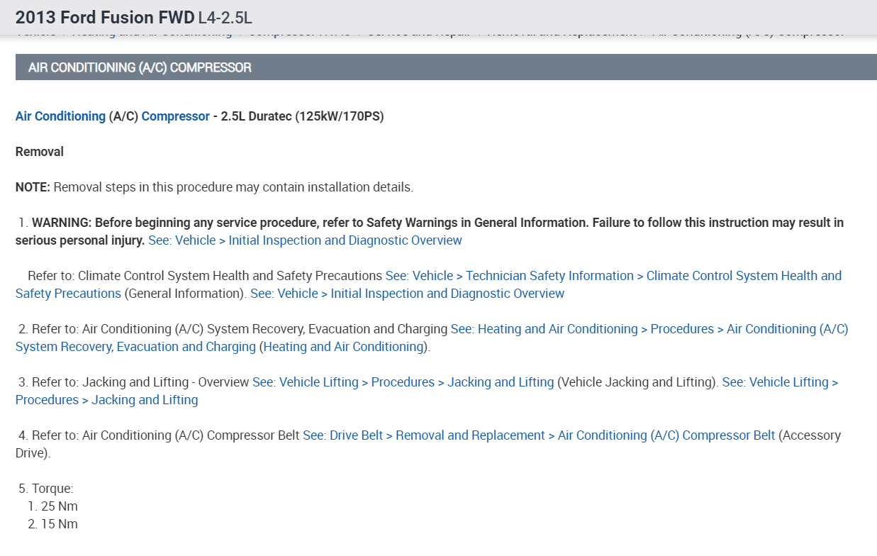

If the pressure is about the same form high to low side the compressor is bad. Here is a generic guide to help you step by step with instructions in the diagrams below to show you how on your car:
https://www.2carpros.com/articles/replace-air-conditioner-compressor
Check out the images (below). Let us know what happens and please upload pictures or videos of the problem so we can see what's going on.
