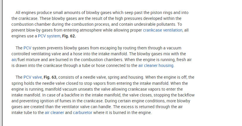

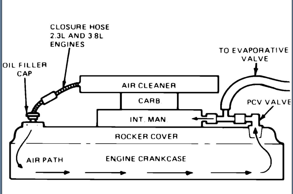

Take a look at this diagram below. I suspect you are talking about the hose from the air filter housing to the oil fill cap or valve cover?
If that is the case, then this is part of the PCV system.
Basically, it takes fresh air from the air filter housing and the negative pressure (vacuum) from the intake manifold pulls any crankcase vapor out of the crankcase and puts in back in the engine.
