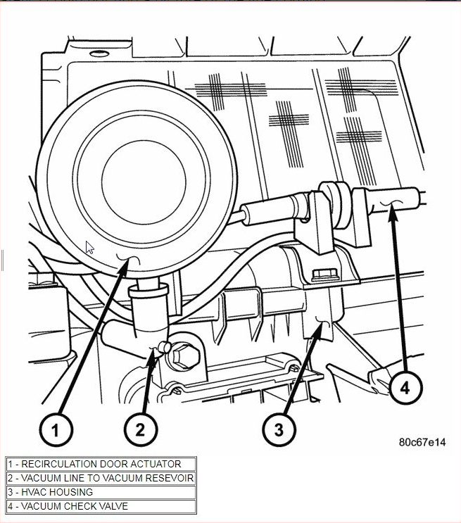

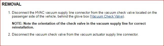

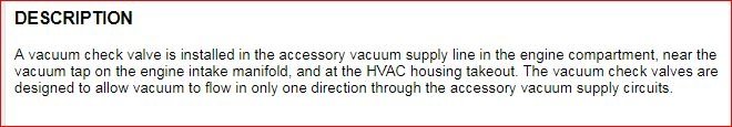

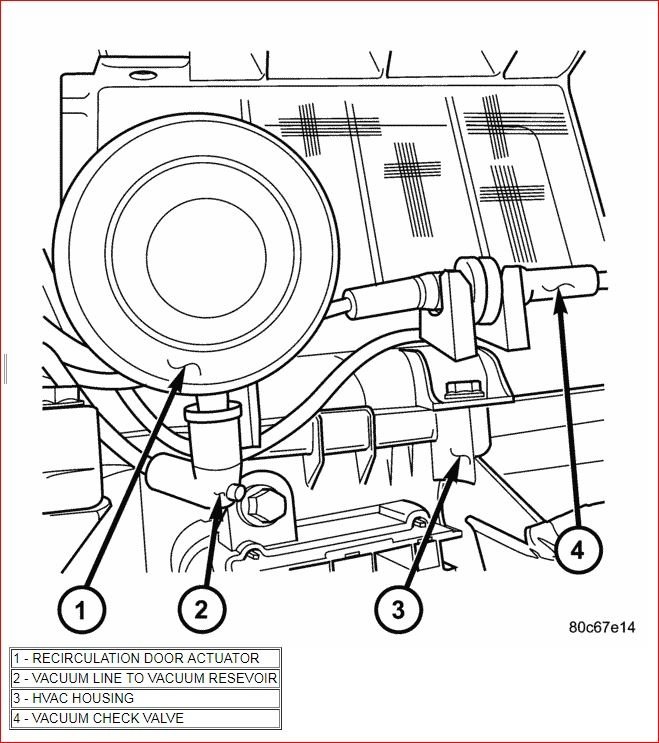

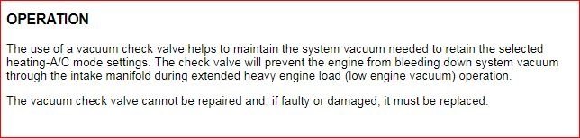

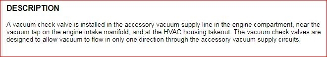

Hi Troy,
Unfortunately, I could not find a picture of the line coming through the firewall but I have attached documents that will locate both ends of it. You will need to locate that and then just trace it. It is relatively easy to do once you identify which line it is. This is an accessory vacuum line on the intake manifold that will obviously be routed in the direction of the firewall. Then you can follow it through and drop the glove box and see it come through to the reservoir.
Worst case, go to the reservoir and disconnect it and give it a small tug and have some look in the engine compartment to see which one moves.
Let me know if you can't find it and I will dig deeper.
