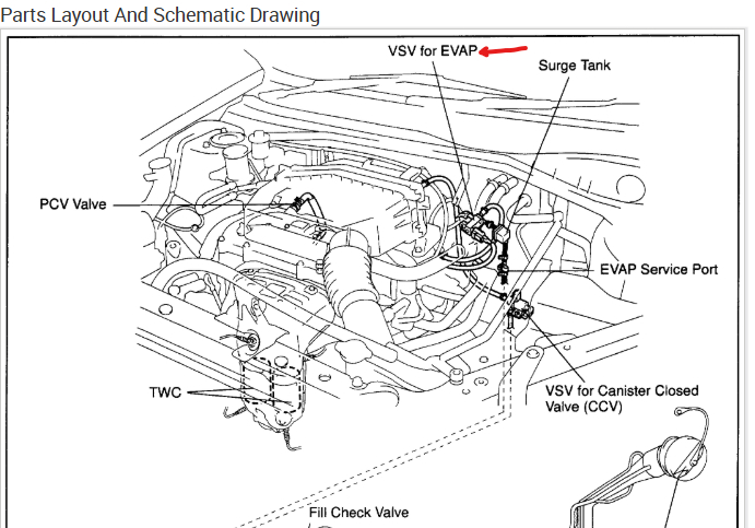

Yes, for sure check the air filter, also I would check the air pressure in the tires. Can you smell gas around the vehicle, if so, you have a leak. Also, I have seen the EVAP purge valve stick open and allow fuel to enter the engine. Here is the location of the valve, remove it and you should not be able to blow through it. If so, it is bad and needs replacement.
Please go over this guide as well:
