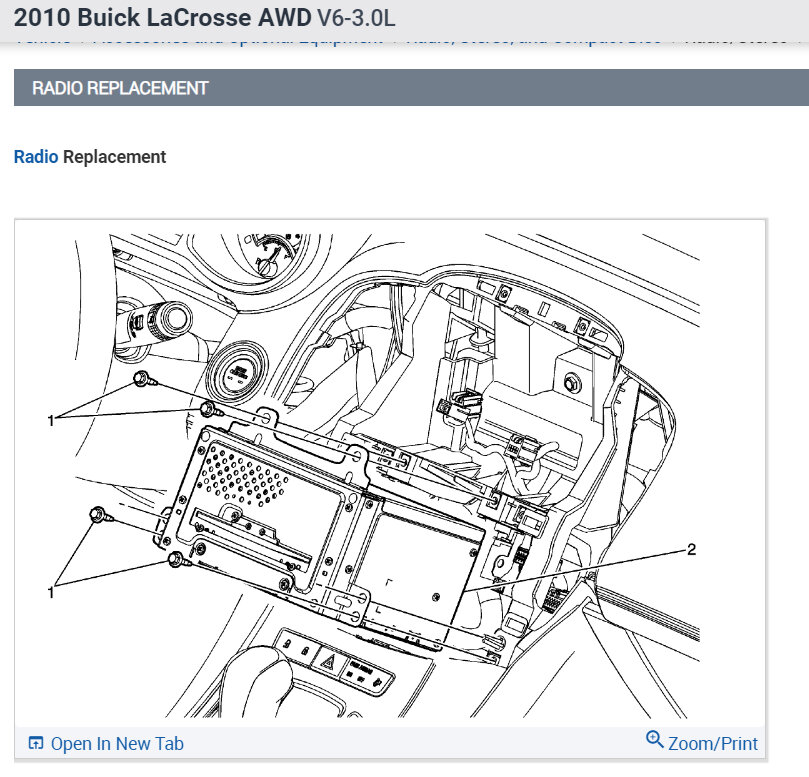

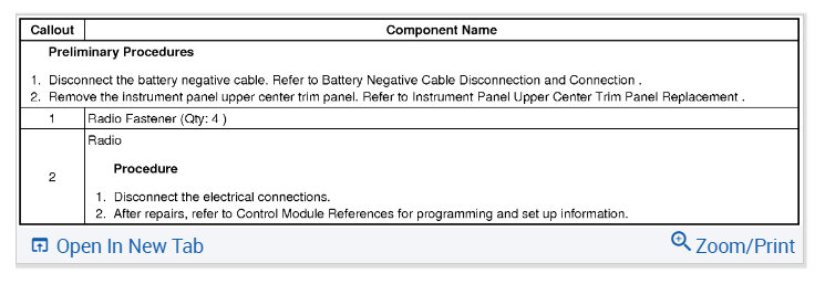

Inspect Wiring and Connections: There could be a loose or disconnected wire or connection related to the USB port. This might require disassembling some interior panels to access the wiring behind the port.
Check Vehicle Settings: In some cases, the USB port might need to be enabled through the vehicle's settings or infotainment system. Check the owner's manual or consult the vehicle's infotainment display to see if there are any settings related to the USB port.
Software Update: Some vehicles require occasional software updates to keep all systems functioning properly. Check if there are any available software updates for your vehicle's infotainment system.
Please go over these guides and get back to us.
