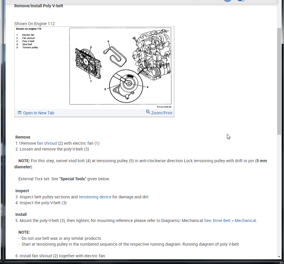

Attached is sample picture.

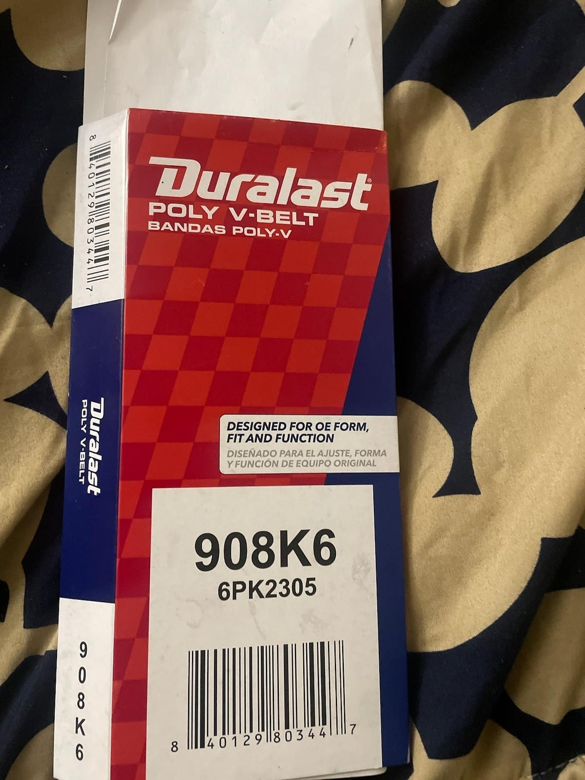

I deleted the A/C compressor this is the size belt needed for a 3.2 l V6 2003 Mercedes-Benz E320.
Nov 19, 2022 at 6:16 PM
LINDA ROSEN
I deleted the AC compressor this is the size belt needed for a 3.2 l V6 2003 Mercedes-Benz E320
