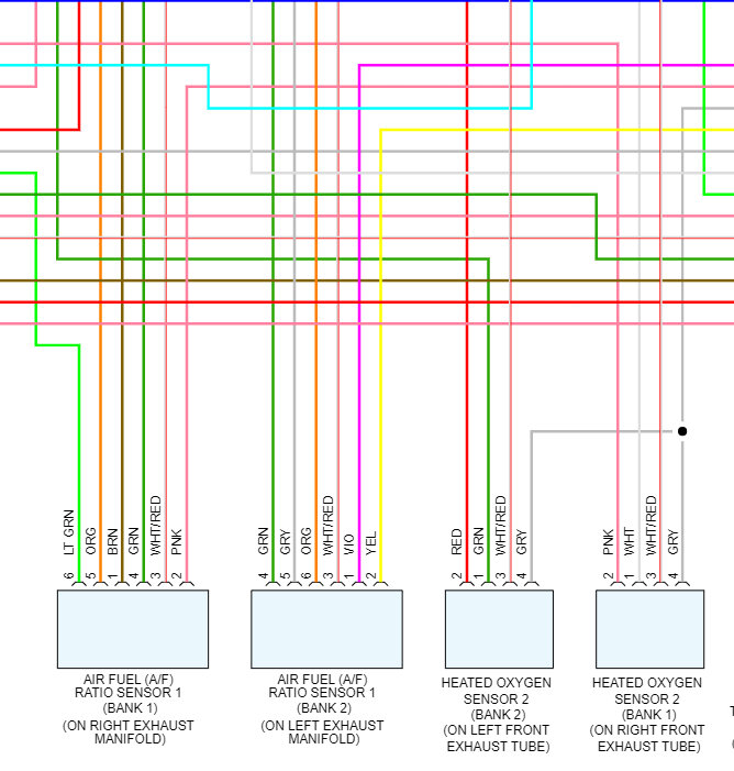

Need harness side of plug pin out identification to connect to upstream o2 sensor?
2005 NISSAN PATHFINDER
187,065 MILES • 4.0L • V6 • 4WD • AUTOMATIC
JEROMI73
Upstream sensor need info for wire colors on harness side only not sensor at plug connection truck never had harness side plug just taped wires.
Jun 16, 2023 at 4:36 AM

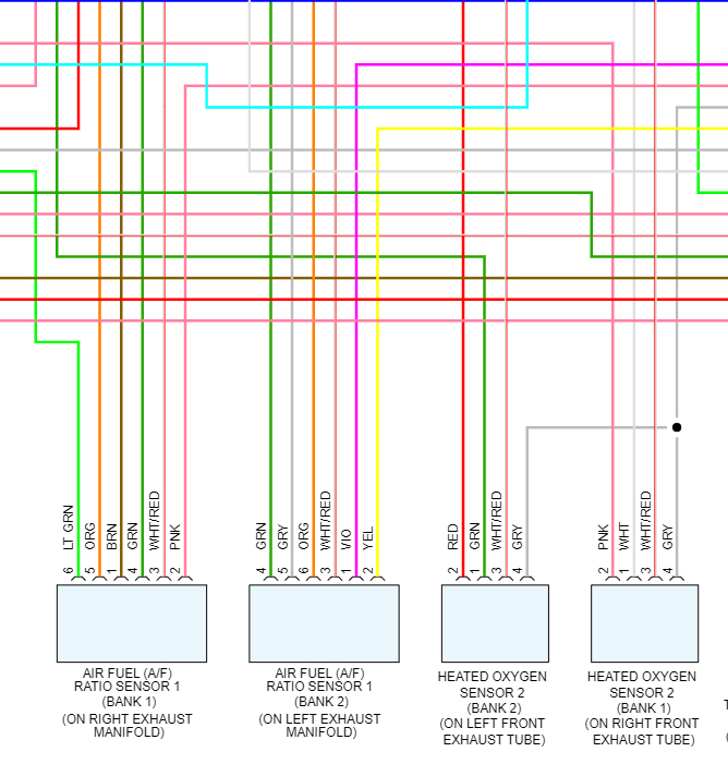

Sure, here is the information about the oxygen sensor wiring colors you have requested. Check out the images (below). Please let us know if you need anything else to get the problem fixed.
Jun 16, 2023 at 11:31 AM
