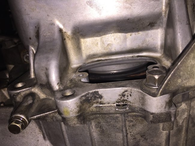

Trying to remove upper oil pan. It hangs down but it appears that a lip of the pan extends into the transmission bell housing and is caught there. Wondering if I have to create gap between engine and transmission to release upper oil pan. I hope not. Thanks

Pan bolts removed, pan separated from block. Pan hangs down but will not release from transmission side.

Sent photo, did you receive?

Crankshaft is housed in oil pan preventing any side motions only down and lip of pan extends into transmission bell housing prevents pan to drop.

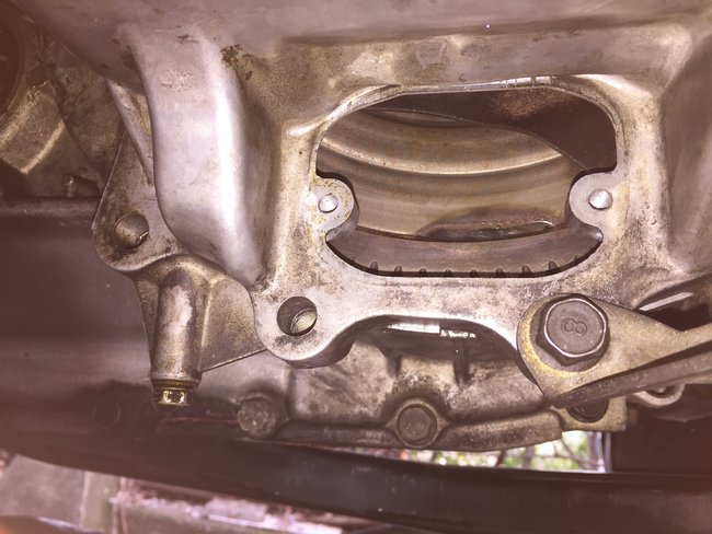

Okay, I see a bracket that looks like it is blocking it from coming down. remove that bracket.

The bracket in this case is actually the bottom of oil pan allowing it to bolt to transmission housing.
Apr 11, 2018 at 2:15 PM
In the photo it shows to be bolted to the bell housing?
Apr 11, 2018 at 2:16 PM
SLAB9
  • 23 POSTS
The two 10 mm facing down lock pan to block. Releasing them allows pan to separate from block. Pan drops half an inch or so but no further .

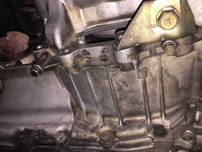

I will send a photo of it hanging .

Pinch point is created by angle of transmission to engine and by crankshaft bracket. Looks like creating gap between transmission and engine is only option. Thanks for your help.
