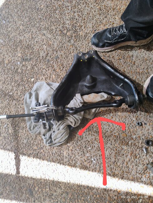

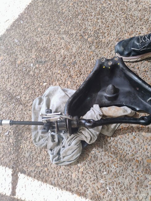

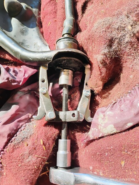

I've managed to get out the old bushings w a 3-jaw puller (I changed it to a 2 jaw see pic) then a big C clamp on 2nd one. I pressed in the new one with C clamp on one side but can't get 2nd one in with that middle bar. My tool is closed at the other end of c clamp. What technique can I use or tool to press in the 2nd one? That middle bar sure blocks a lot!

That's after pushing the rod hard with jaw puller it popped out. I put new one in with big C clamp rented for ball joint on 1 but can't get 2nd one seated due to bar. I got access to the AutoZone and O'Reilly tool rental also.

Normally I use a press with a bushing on it to press it in while supporting the arm right around the bushing. Lacking those you could put the arm in a vice with the bushing in the hole and use the vice as a support and then use a heavy hammer and a chunk of pipe to drive the bushing in. Or use this as an excuse to buy a press.

I can try a hammer and the sleeve around the bushing. Is there a technique I can try with the nut on bolt end, and a big metal washer or that cup in the kit -

You can't use the nut to pull it in as it will damage the rubber of the bushings. I use a press myself but there are folks who haven't got a press. The hammer method works but you need to support the arm to prevent damage.

Actually, I was able to get it on by renting both small and medium 3 or 2 jaw pullers an used the bigger grip teeth off little one on that big one and a hole saw worked great as the cup with a couple big flat washers.one side is a hair closer on that metal bushing but both sides of that 1 bushing is in ..I don't think it will factor ..Which way does that middle bar swing -.with the curve edge facing out or in? See last pic arrow.

I will feel the one on the other side. I think the curve faces in? can I get away with using a hydraulic ratchet to tighten all 4 Nuti. I know it's very high torque, but I plan to get an alignment. What's the ft lbs ?

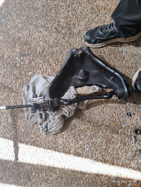

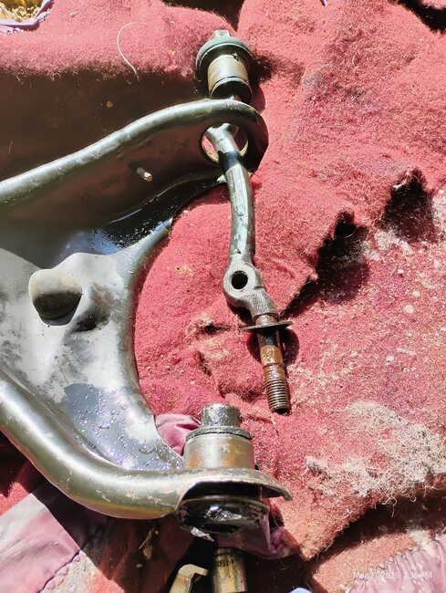

This is odd. But the other top control arm pivot bar in middle is straight across no curves. Is that normal? I'm assuming it is since the straight one I ordered won't fit passenger. So which way does that bar curve? Were these made like this with one side having curved bar?

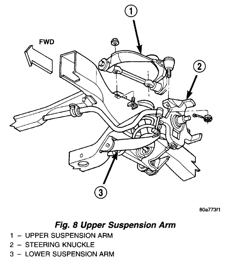

The curve usually faces away from the spring but in this case service information doesn't say. The only thing I find is an image on the part section that shows the pivot turned 180 degrees from where you have it in the attached image.

One side where the holes have a rough tic tack toe edge I think it goes on top.

The serrated area should be the side that hits the mounts. They are what bites the steel to help hold them in the correct position after alignment. Sort of a crude lock washer. They unfortunately don't show that in service info though, this is all they show for both sides. However, the serrations go toward the mount not where the nut is seated.
