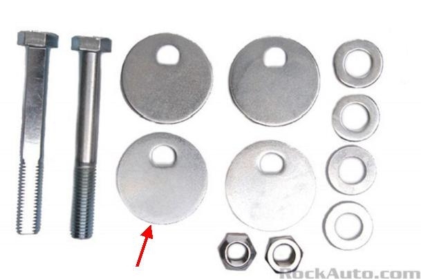

I was told there is to be some type of metal plates connected to the upper control arm to keep the front end in alignment and I was told mine are not there. Could you show me what I am looking for?

I suspect they are referring to the kit in the photo below. Ford's engineers have a history of not making the vehicles' alignments adjustable. They leave it up to you to buy the parts that let your mechanic modify the upper control arm mounting points to make them adjustable, like is done on many other vehicles. Square plates are removed and discarded, then these round, offset washers are installed with special bolts that key them together. These bolts are loosened a little, then as they are rotated with a wrench, the washers rotate too and push or pull the control arm to specs. Once in specs, they are tightened again. Rather than just sliding some bolts around, these round plates sit in a pocket that makes them hold the alignment tightly so it does not change when you bounce over pot holes and other bumps. The good news is you only install these modifications one time on each front wheel. They stay in there and can be reused over and over for the rest of the vehicle's life.

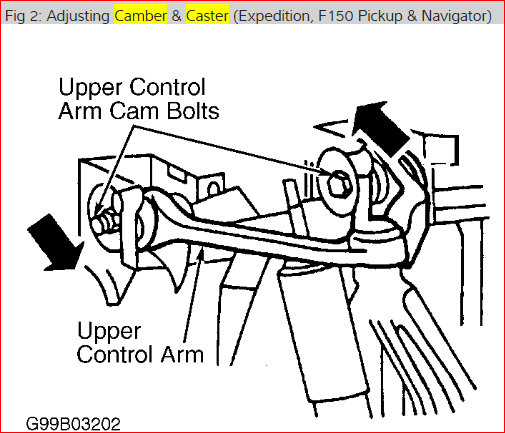

Your upper control arms are adjusted by moving the cam bolts in or out to adjust the alignment. This controls the caster and camber alignments for your vehicle. I have attached a picture showing what it looks like. Hope this helps and thanks for using 2CarPros.

Hi Danny L. Those are the parts in my photo, but they are not original. They came with square blocks in there to hold the control arm in place. The round eccentrics got installed to replace those square blocks the first time that control arm needed to be adjusted.
Some of these also came from the factory with a two-piece right upper control arm. Rather than jockeying them both around to try to match caster and camber on both sides, you set the left side first to get camber perfect and caster close enough, then it was easy to set just camber on the right side with the eccentrics, then tweak caster to match the left side by sliding the outer half of the control arm forward or rearward. Fine-tuning caster that way left camber alone. That made aligning the Ford trucks a real lot easier, so naturally Ford had to add a clinker to the job. In this case, when the upper ball joint had to be replaced, as it was built into the control arm, you could not buy just the outer half of the control arm from Ford. Only the standard one-piece arm was available. That meant we were back to running back and forth, readjusting the left and right sides over and over until we got caster and camber in specs, and matching on both sides. As anyone who has ever done it can tell you, that is real lot easier to describe than to do.
It seems to me the outer part of the right upper control arm might have become available from NAPA, but I am sure about that or if it applied to all the Ford truck models.

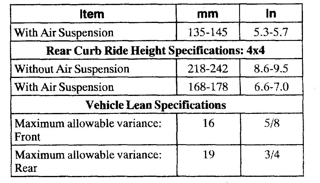

Next, all alignment specialists are very worried about correct ride height. Coil springs sag with age, and that changes the geometric angles of the suspension parts. Those parts hold the wheels in perfect alignment and they move through designed-in angle changes as the vehicle bounces up and down as it goes down the road. When the springs are sagged, all those geometric angles change. It is usually still possible to readjust the wheels to get them back to alignment specs, but it is critical to understand those numbers only apply to a vehicle that is standing still, not to one that is moving around while driving. The angle changes that occur while driving are designed to reduce tire wear to a minimum, but all that careful design goes out the window when ride height is wrong. Ford trucks are already very well-known for having poor tire wear, so maintaining correct ride height becomes even more critical. Some models use torsion bars, especially more so on four-wheel-drive trucks. Torsion bars are adjustable, so getting ride height back into specs is the first thing the alignment specialist will do before he starts adjusting the wheels. Other vehicles use coil springs. Those must be replaced when they become weak and sagged.

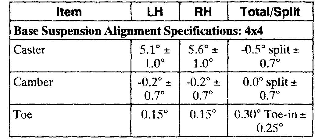

Most Ford vehicles call for rather unusual alignment specs to reduce uneven tire wear caused by the suspension system designs. Without air suspension, yours calls for -0.2 degrees. The minus means the wheels are tipped in on top. Also be aware we can set up our alignment computers to read one or two places after the decimal point. I always set mine for two places to get more accuracy. Getting settings perfect this way takes a lot longer, but I was lucky to work for a new-car dealer where I never once get yelled at for working too slowly. Some mechanics set their computers to read to just one decimal place. That makes the job go faster but you won't get the accuracy. This is what you'll typically find at franchise tire stores where they don't have an emotional involvement with any particular car brand. At the dealerships, we put more emphasis on your satisfaction, so we don't mind taking a little longer.

I know that's more wondrous information than you wanted, so to boil it down, here are the alignment specs for your truck with the standard suspension system:
Camber: -0.2 plus or minus 0.7 degrees
Cross Camber: 0.0 plus or minus 0.7 degrees
Caster, Left: 5.1 plus or minus 1.0 degrees
Caster, Right: 5.6 plus or minus 1.0 degrees
Cross Caster: -0.5 plus or minus 0.7 degrees
Toe: 0.15 degrees each wheel
Total toe: 0.30 plus or minus 0.25 degrees

No. As I mentioned at the beginning, Ford did not want the expense of installing those alignment parts. The first time they are needed, it is up to you to pay for them and the mechanic to install them. Those are what provides the ability to make the adjustments. Once a kit is installed on each front wheel, they stay there for the rest of the life of the vehicle. You do not need to buy them again at every future alignment.
