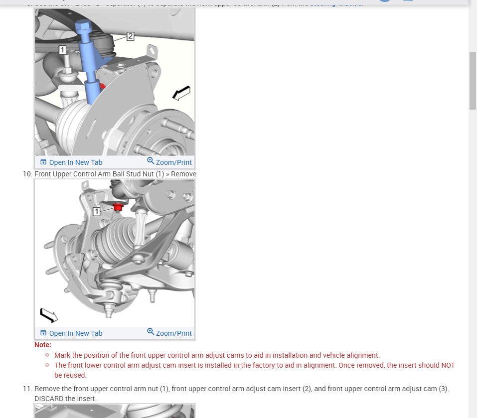

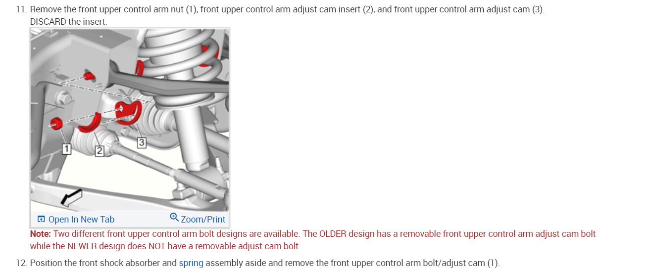

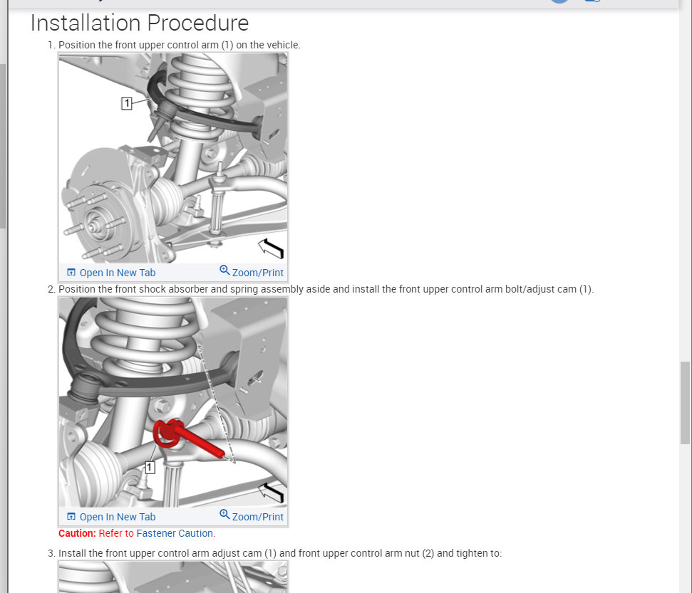

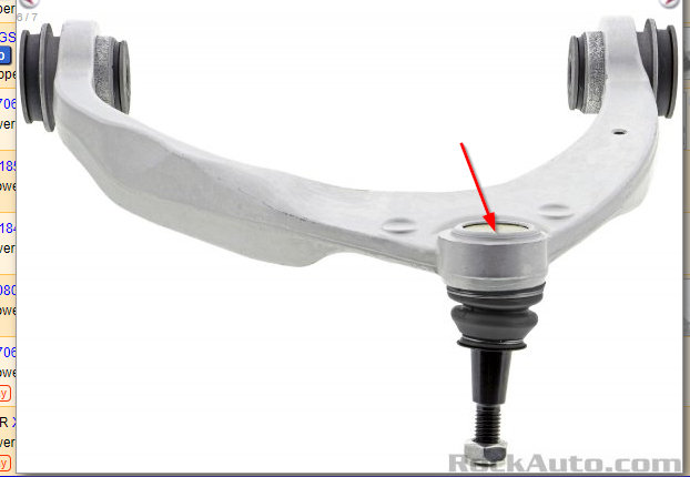

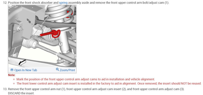

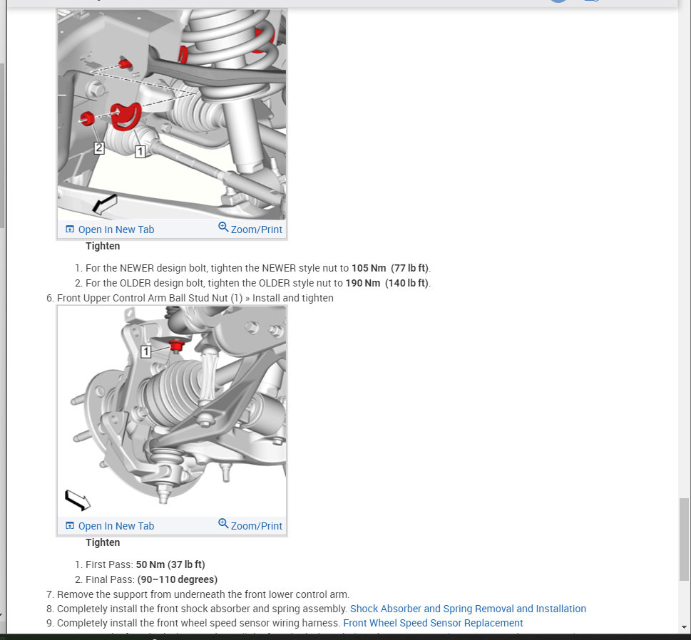

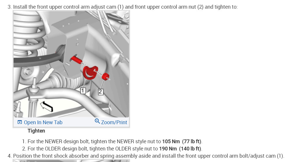

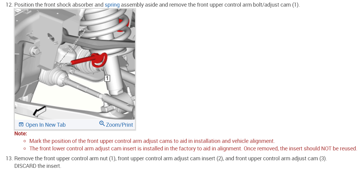

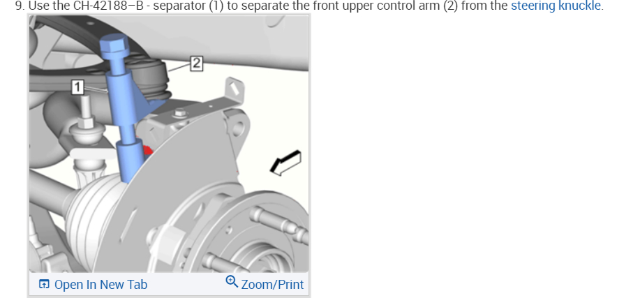

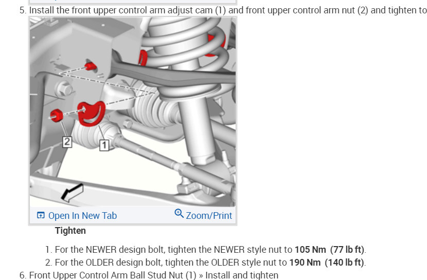

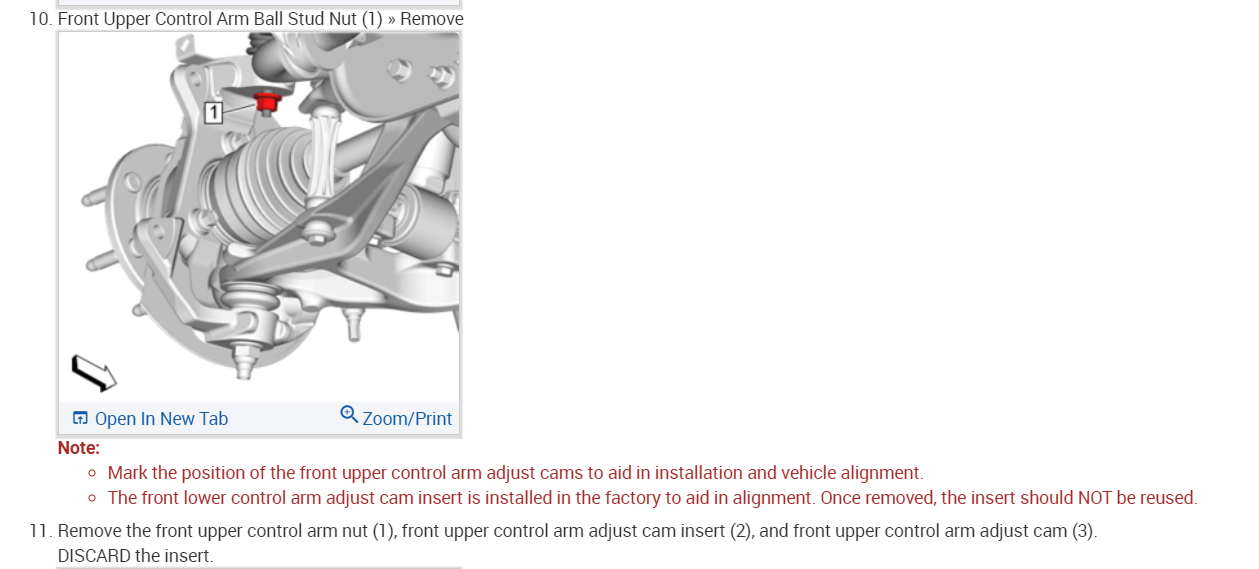

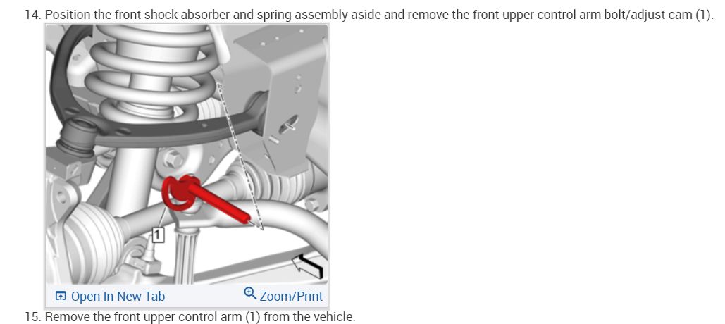

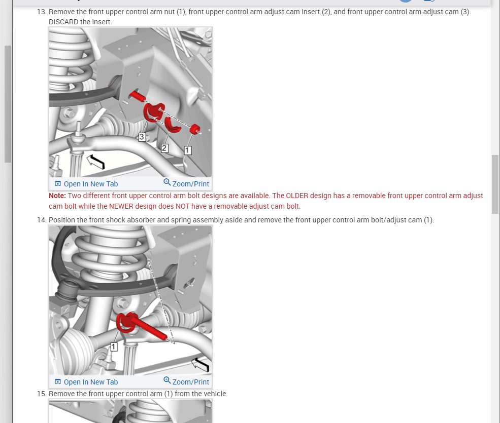

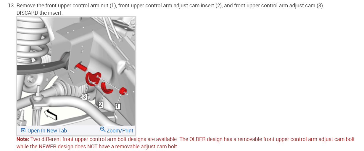

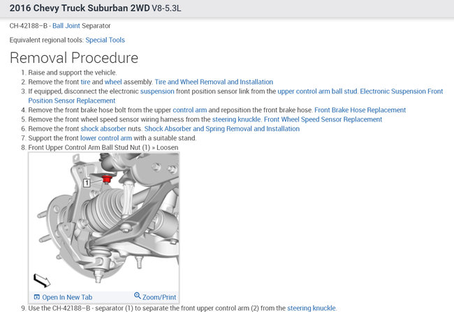

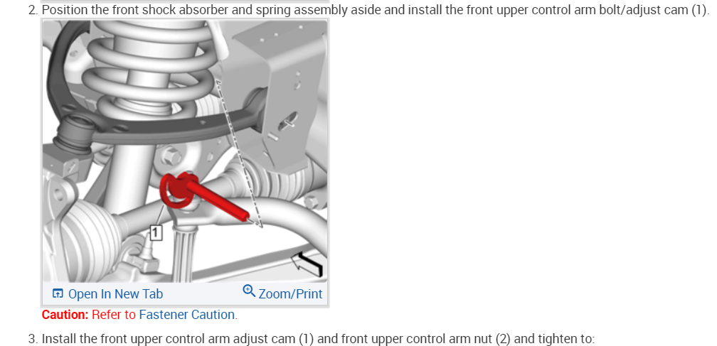

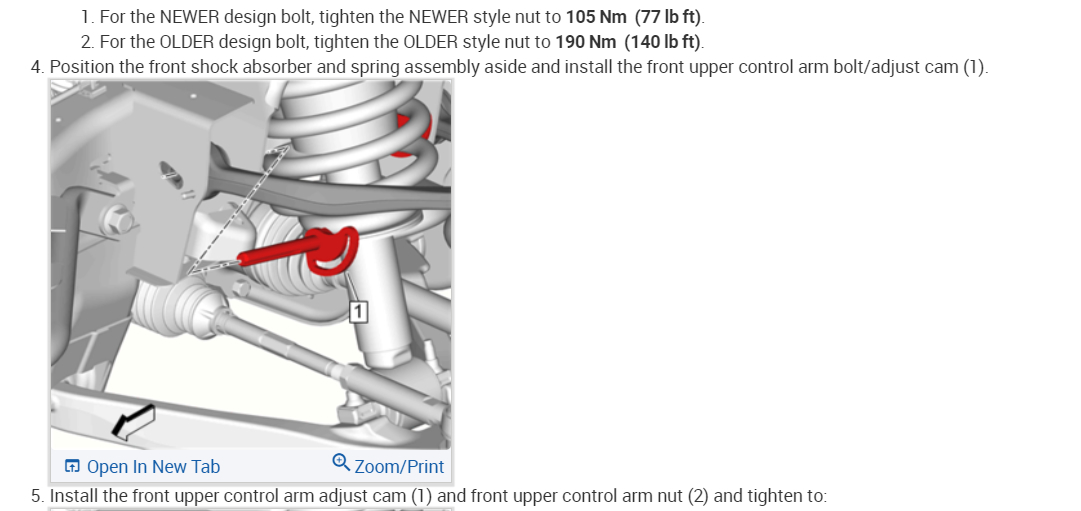

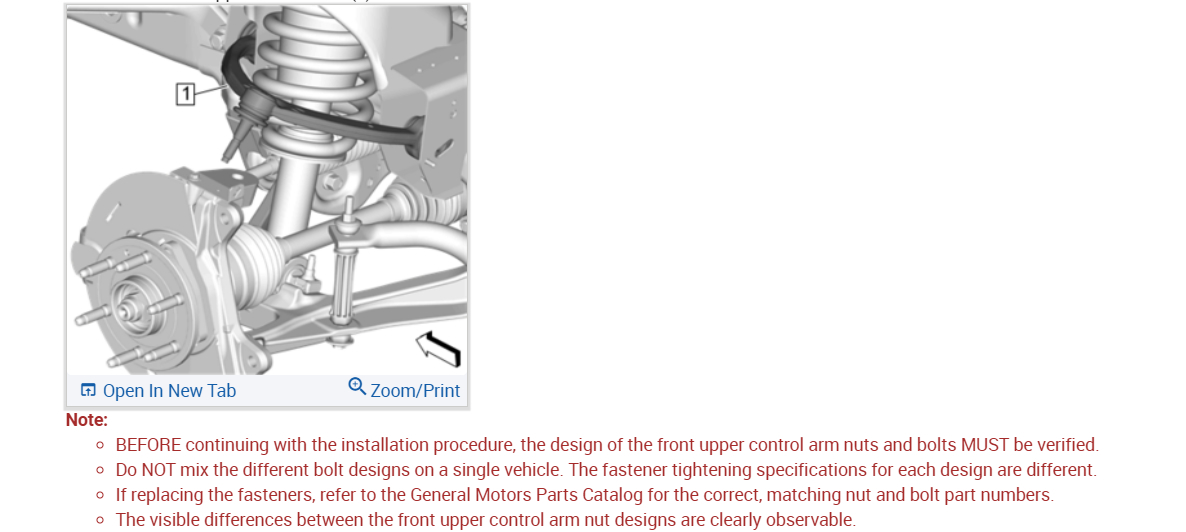

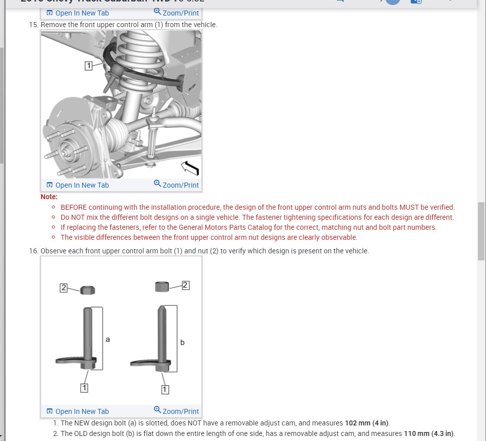

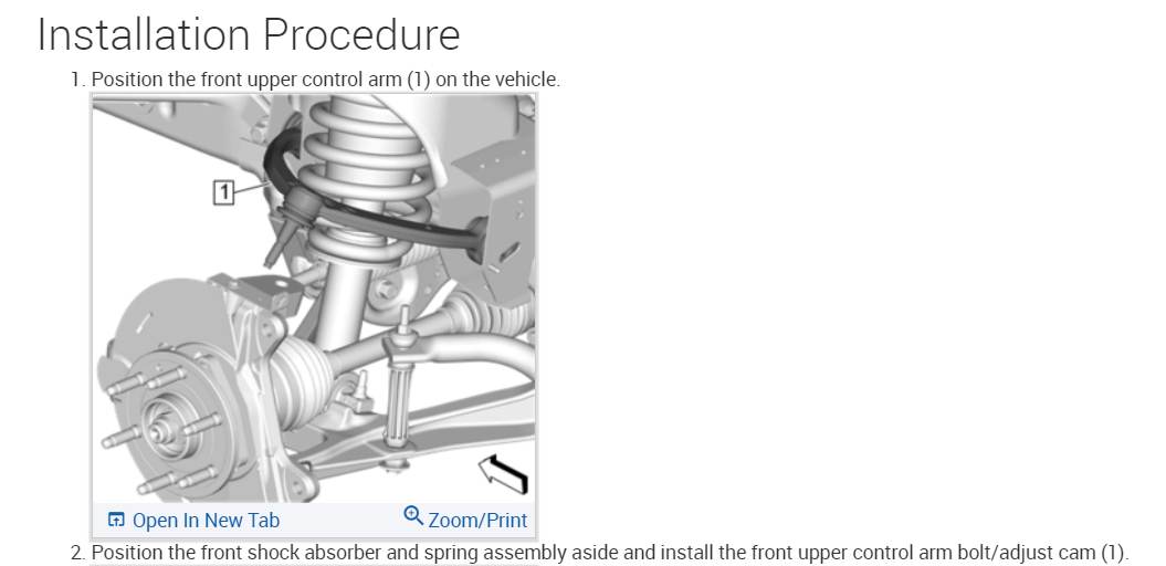

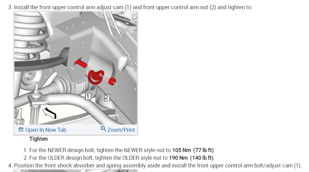

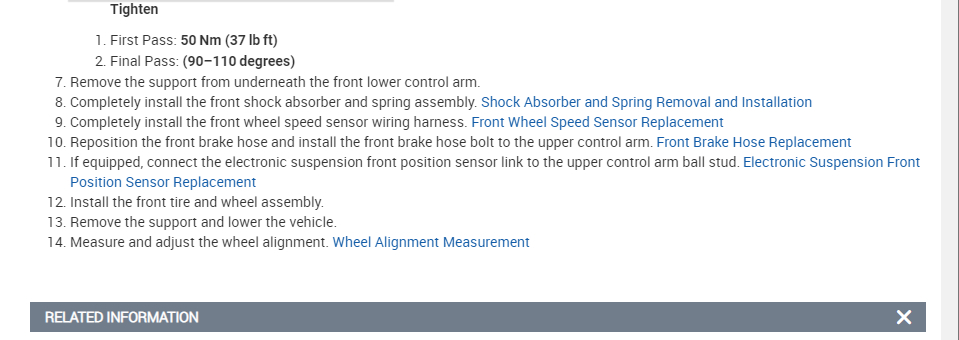

Hi, I was wanting to know how on this vehicle do you replace the upper ball joints. They are worn out. I see most places sell just the upper control arm and the manual really only shows replacing lower ball joints. Upper ball joint replacement shoes just a control arm remove and replace procedure. However, I did purchase upper ball joints only from Rock Auto from Moog. Wondering how to do this looks like they have some type of cap over the top of the ball joint how do I get that off and press it out?
