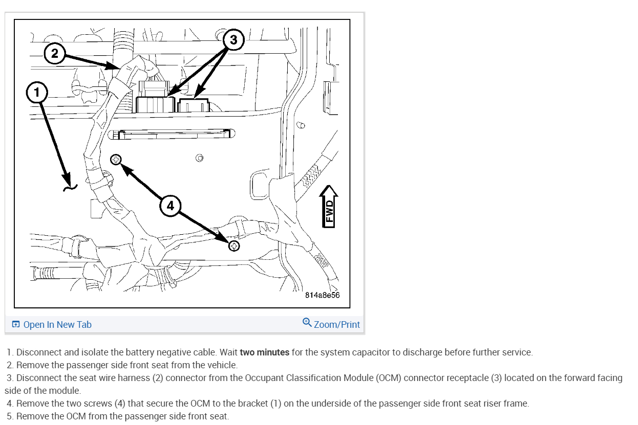

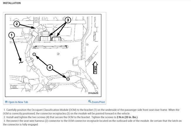

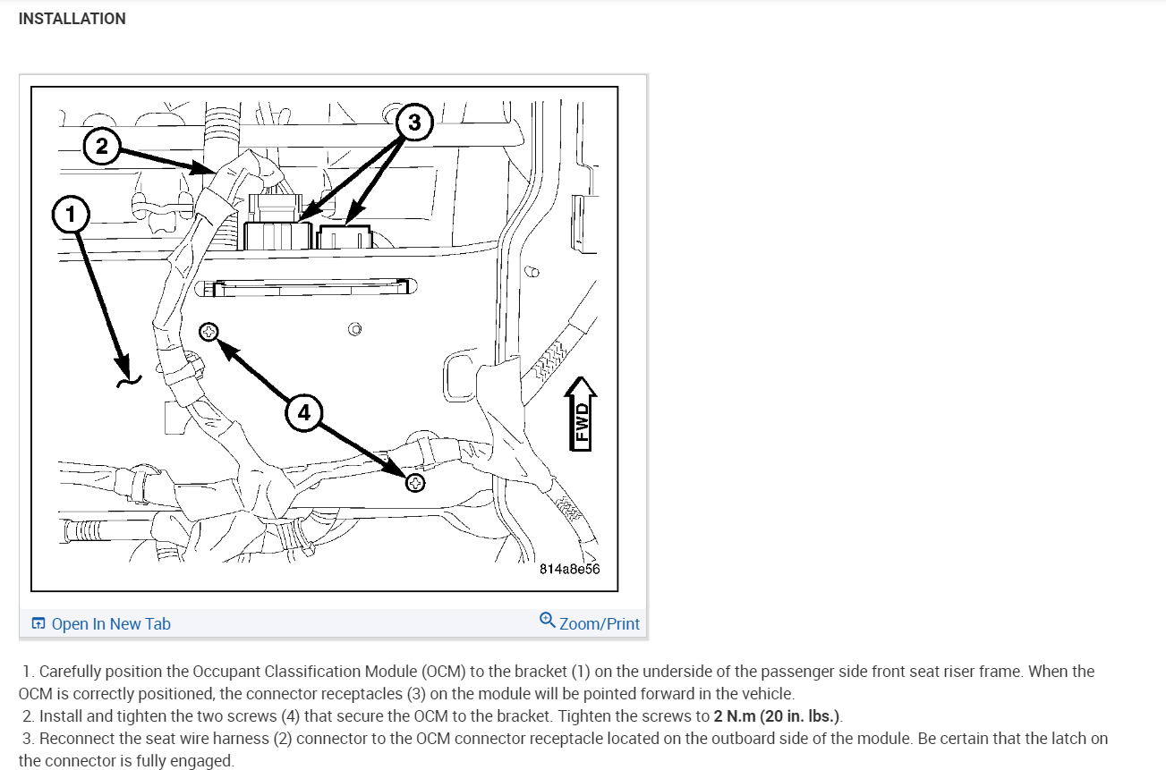

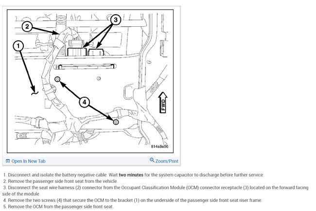

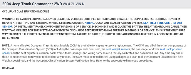

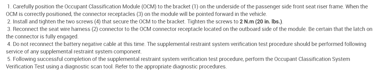

If you cannot find a preprogrammed unit then the dealer is your only choice, it would cost more to get a level of scanner that capable of programming the module. Here are the instructions on how to replace the module in the images below so you can see what needs to be done. Check out the images (below). Please let us know what happens.
