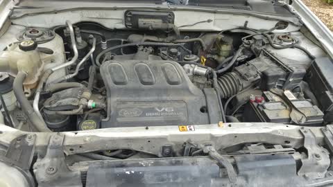

I have noticed lately that there is an unusual sound coming from under the hood. You can hear it when the car is idling, it is harder to hear when the car is driving. I am trying to get an idea of what it might be, to see if it's something I know how to tackle myself. I will add a video to this, hopefully you are able to hear some of the sound. To me it is sort of a metallic like noise, but I find it hard to explain.

I thought I uploaded my video the first time, I guess it did not go through. Should be visible now!
Aug 17, 2018 at 7:04 PM
Yep, that worked.
It is kind of vague but it sounds like it is under the front cover, like a water pump or some kind of bearing on something being driven by the engine.
remove the serpentine belt and see if the noise is still present.
