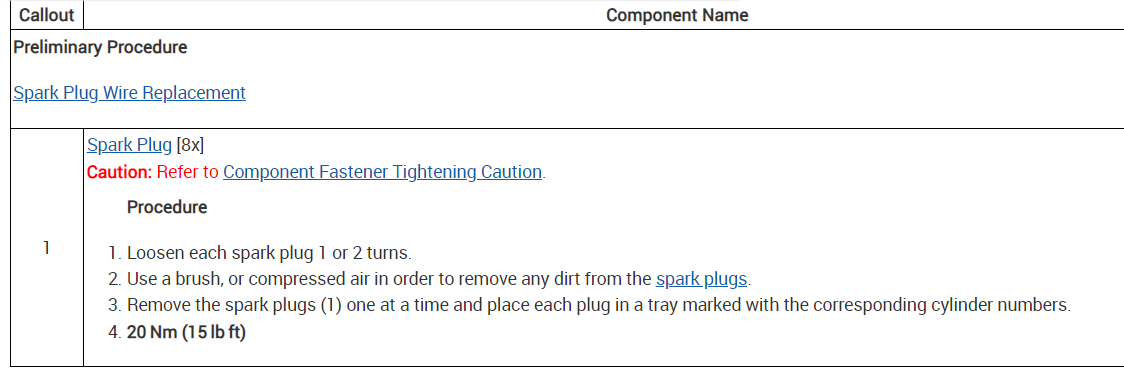

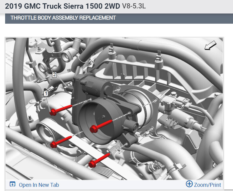

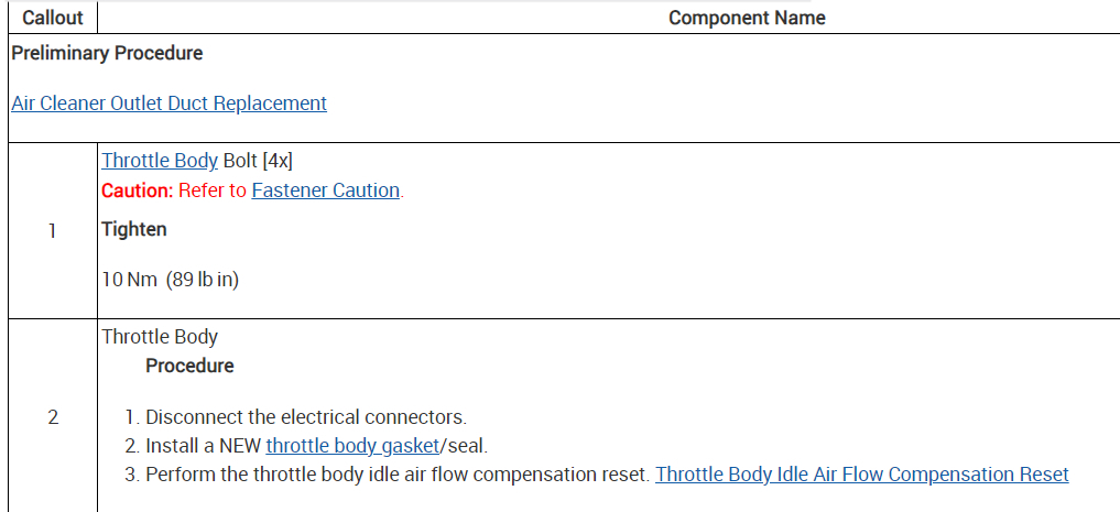

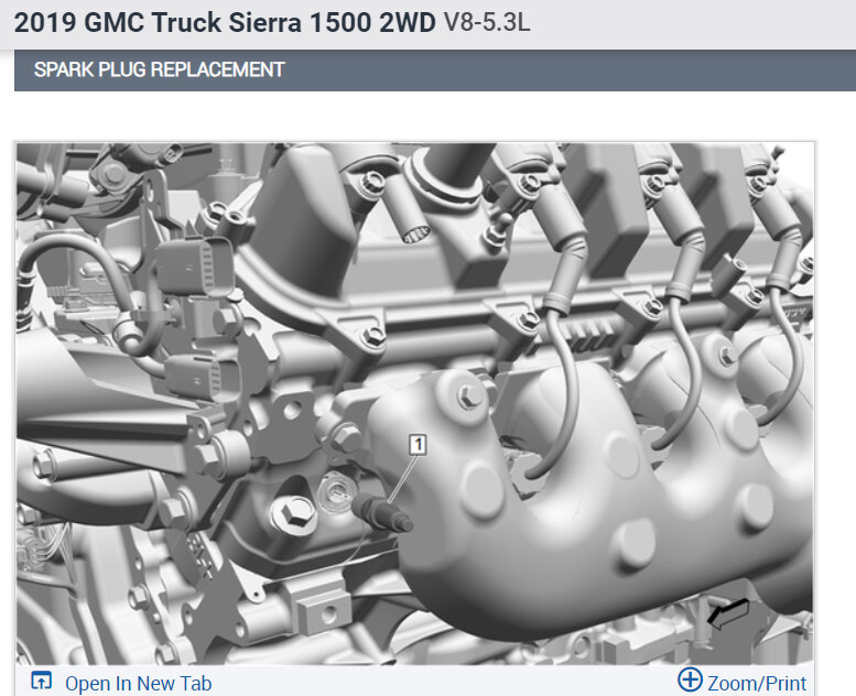

An engine misfire will cause this issue as well as a throttle bore that needs service, if you have not installed new spark plugs and wires, I would do that first. I have also seen ignition coils go out as well, but I would definitely do the tune up first. Also, do you have a check engine light on? if so, please follow this guide:
Here is another guide to help as well:
https://www.2carpros.com/articles/how-to-tune-up-a-car-engine
and of course, please read before attempting.
and
https://youtu.be/N2nC4V9DrdQ?si=_f5NSb5lIfgCcB_Z
You won't need to reset the throttle body if you leave the wires connected.

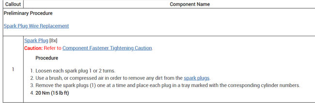

The recommended spark plugs are typically iridium spark plugs,
ACDELCO 41168 (GM Original Equipment; Iridium)
Here is how the job is done on your vehicle and specs as well. Check out the images (below). Please let us know what happens.

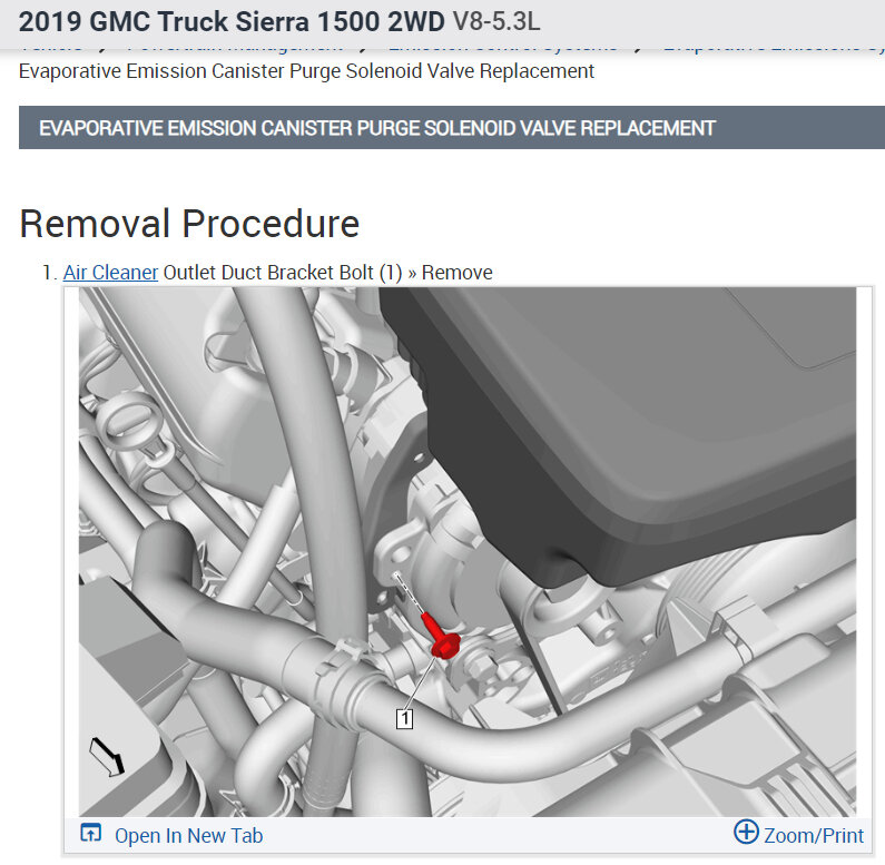

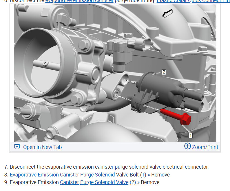

That could be a clue, what did it say about the emissions system? In the meantime, lets remove the EVAP system purge solenoid valve to see if you can blow through it, if so, the valve is bad and causing the engine to ingest fuel vapors which can cause the problem you are having, here is the location of the valve so you can check it out. Check out the images (below). Let us know how it goes.

It just says two or more of your emission control monitors have not completed their test or that there could be a DTC pending. I have removed the EVAP system purge solenoid, and I could not blow through it.

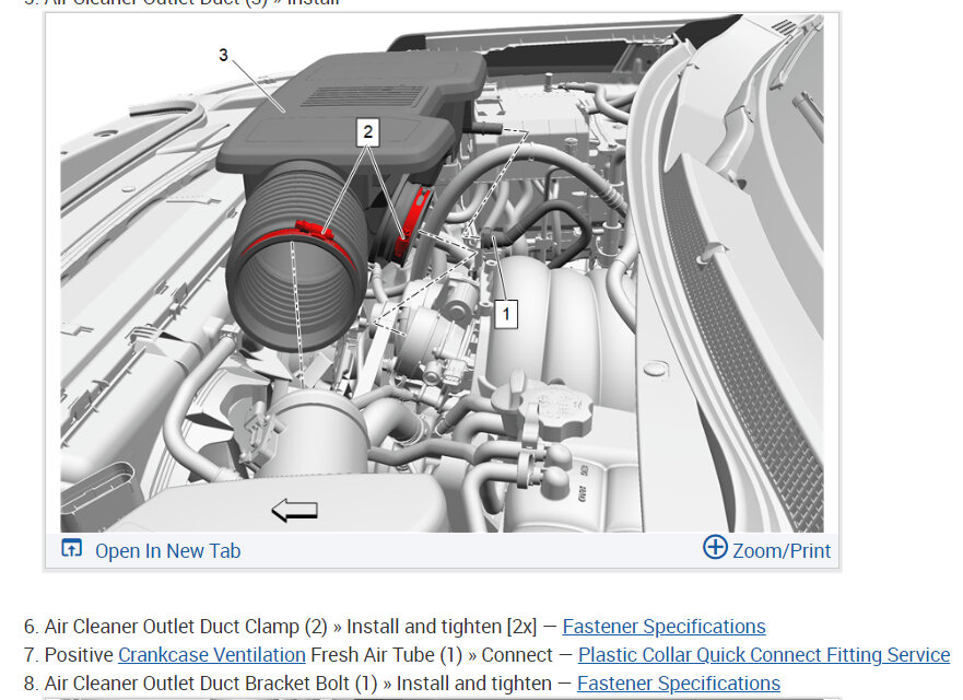

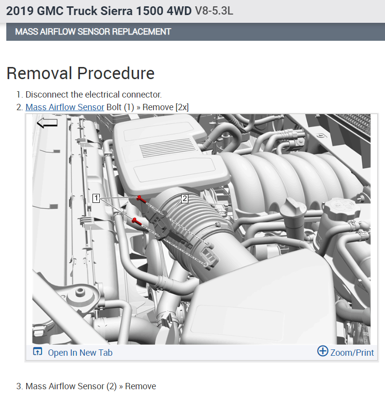

I have seen a MAF sensor hot wire get dirty and cause this kind of problem without showing a code. Unfortunately, there is no way to test the sensor except to compare it to a new sensor which is why the dealership mechanics have one in their toolbox just for this reason. Here is the sensor location so you can check it out. Also please make sure there are no leaks between the sensor and the throttle body. Also, do you have any exhaust leaks? Check out the images (below). Let us know how it goes.

MAF was the first thing I checked and cleaned. It has a brand new air duct from the filter box to the throttle body so there shouldn't be any leaks.
Dec 30, 2023 at 11:53 AM
How was it checked? Did you use a scanner to see the grams per second flow rate and how it compared to a new sensor? Like I say cleaning will not help it once it is too far gone. If you get it from Amazon, you can send it back if it doesn't help.
