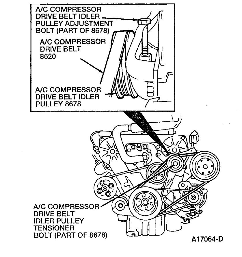

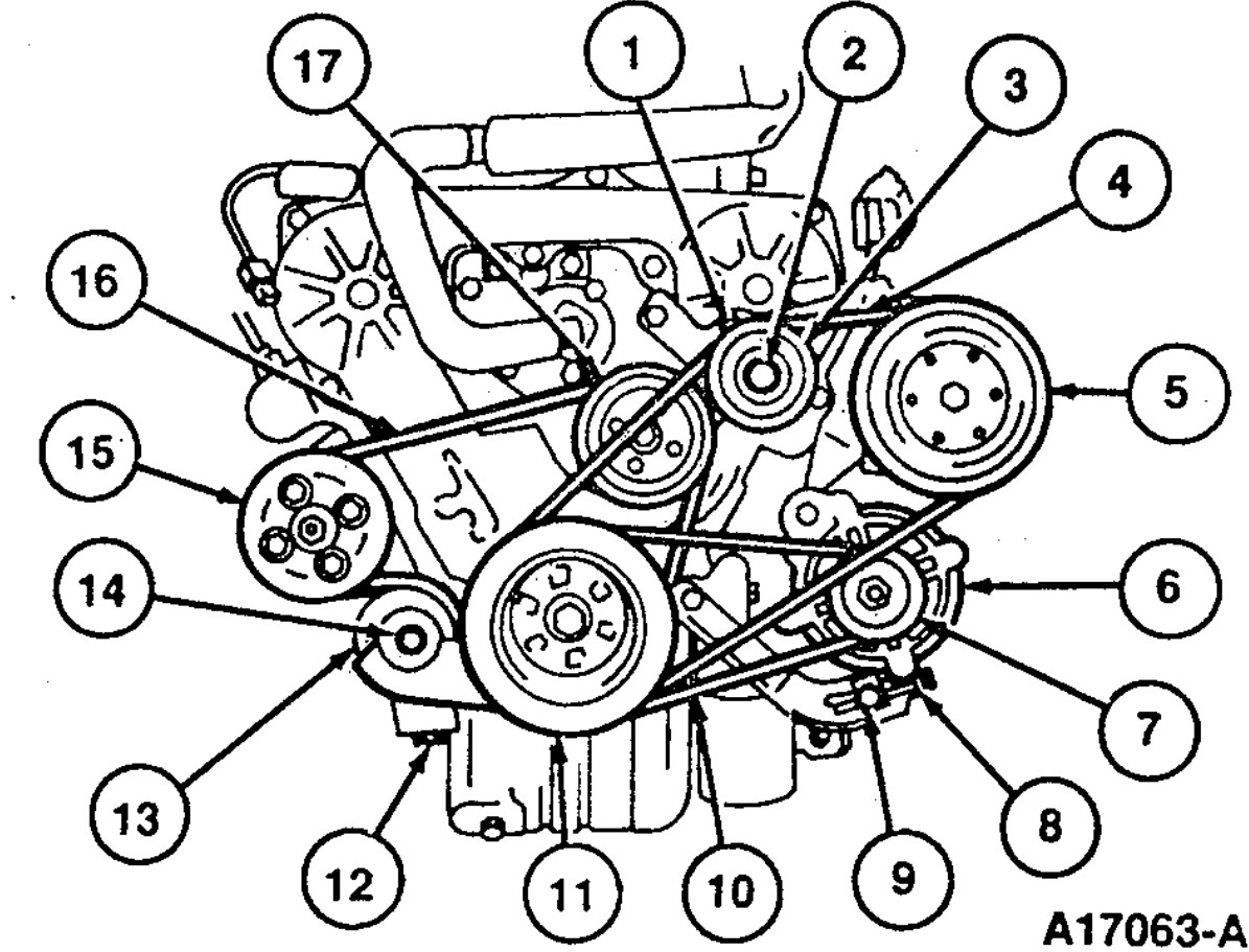

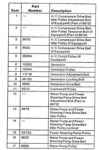

There are 3 belts depending on the driven item. These are the OE part numbers
XF5Z8620AB is the Alternator Drive belt
XF5Z8620AC is the Power Steering belt
F3XY8620B is the AC pump drive belt
If you re-use any of the belts be sure to mark the direction, they were installed before removal so they can be installed the same way. If you don't you will likely end up with belt noise and squeals.
