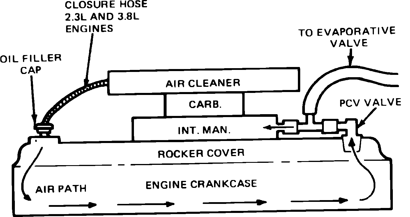

I have a random metal line coming out from near the oil cap. Where is it supposed to go?
Jan 17, 2019 at 12:43 PM
If the item you are referring to plugs into the valve cover, it sounds like it is the PCV valve. Take a look at the picture I attached. First, locate the oil cap and then to the right, the PCV.
Let me know if that is what you are referring to. If it isn't, could you upload a picture for me to see?
