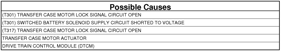

C1406-12 Transfer case brake control - circuit short to battery.

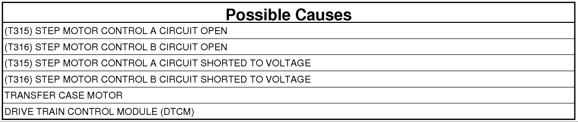

C140a-13 Transfer case motor control - circuit open.

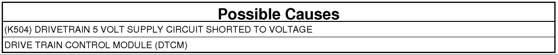

C2110-12 Sensor supply one voltage - circuit short to battery.
All related to the transfer case and its controls. I doubt they involve the button but the last one that shows the five volt reference shorted to voltage could.

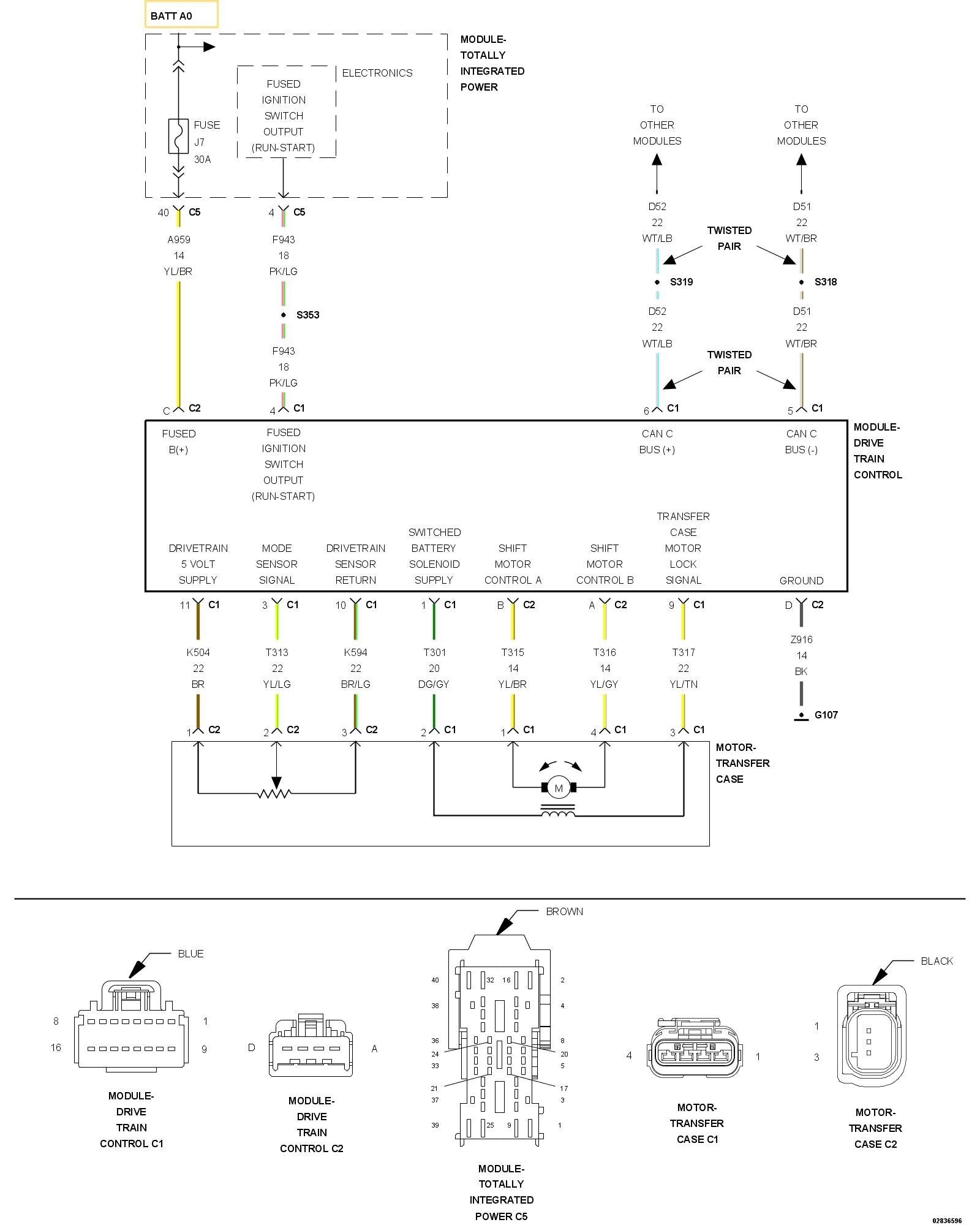

From the descriptions I would start by looking for harness damage near the T-case or its controller. A bad wire shorted to the others could be the issue.
