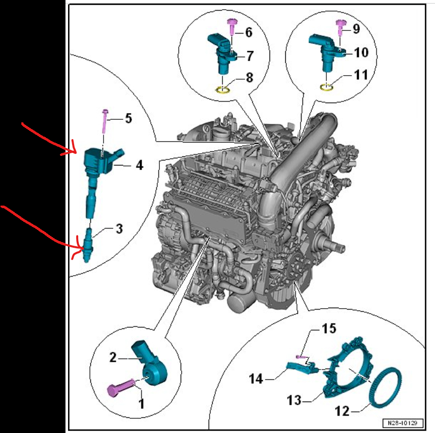

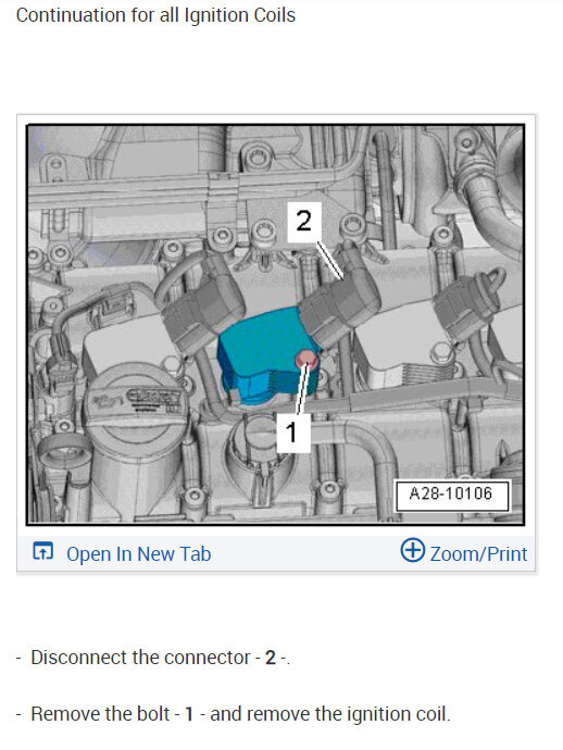

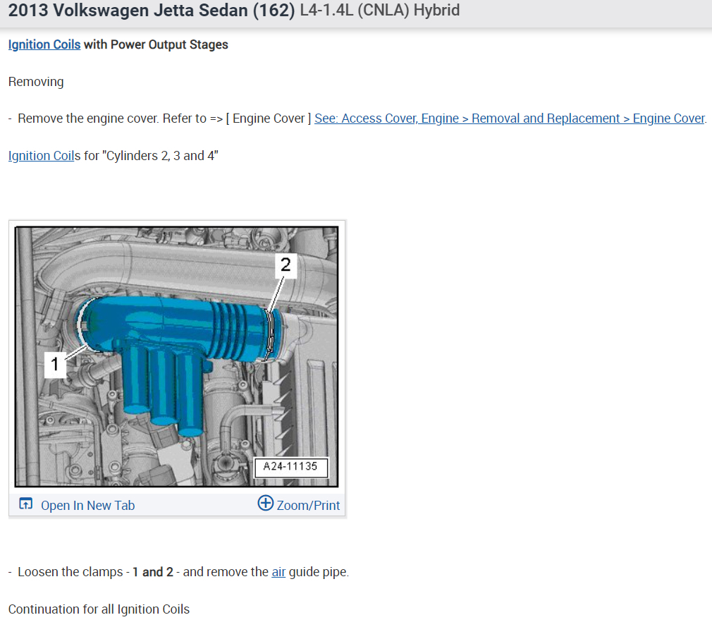

This can happen when the engine is misfiring, have you changed out the spark plugs and coils? If not, this is where I would start, if the engine is not running well the ESP system can get mixed up and flash the ESP warning light. Here is a generic guide to help you step by step with instructions in the diagrams below to show you how to do the job on your car:
Torque spec: Spark Plug .................... 22 Nm
Check out the images (below). Please upload pictures or videos of the problem so we can see what's going on.

Yes, the coil pack and spark plugs are pretty new. The problem isn't with the ESP. ESP works like it should to, when the car slides in snow, ESP kicks in, the question is why does the engine misfire for 1-2 seconds after ESP did its thing keeping the car straight. What I'm thinking right now is that because the battery is trash (27%health and where I'm at its below freezing outside) it doesn't have enough juice to power all the systems including the ESP and so it doesn't send enough or send incorrect voltage to the coil packs causing a misfire while ESP is working , after it's done everything comes back to normal . Can this be true? I don't want to keep changing everything until i find the problem.

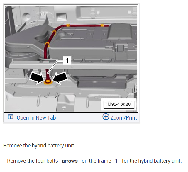

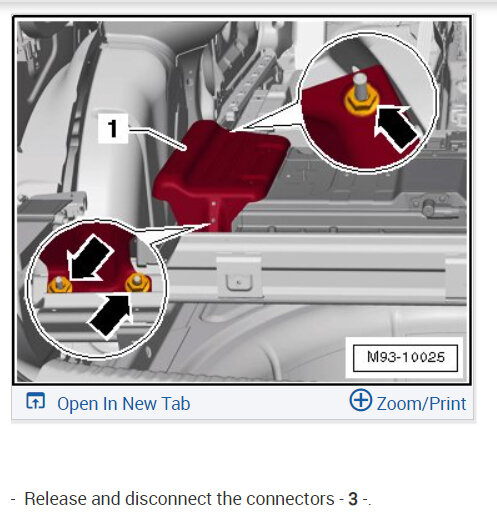

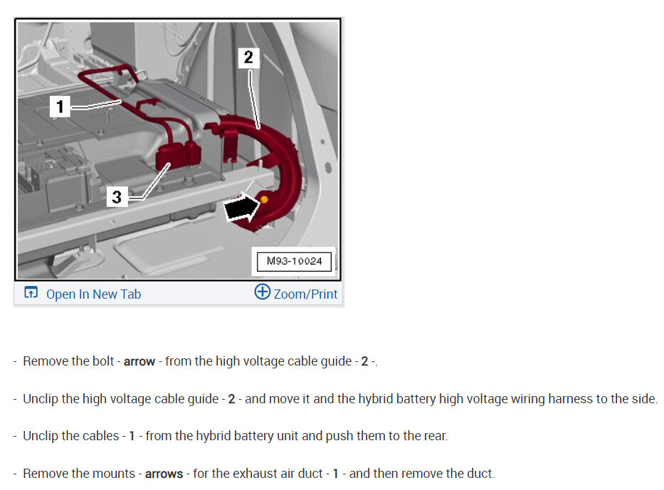

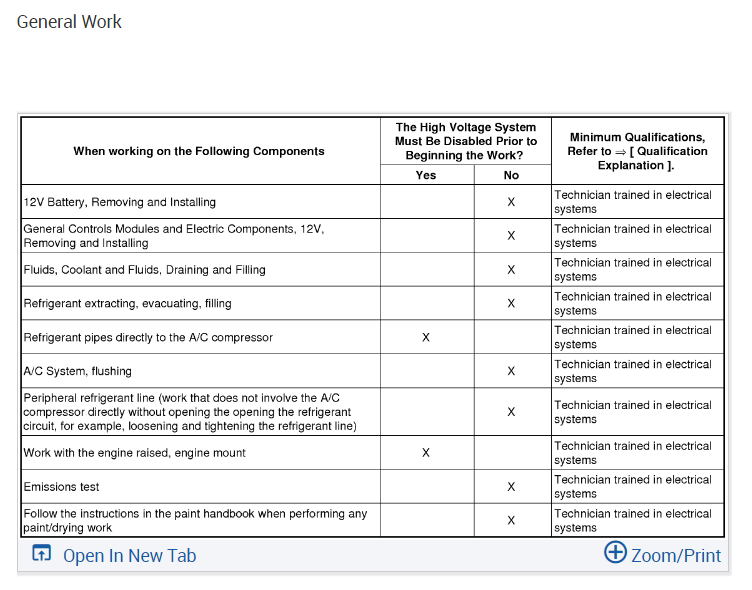

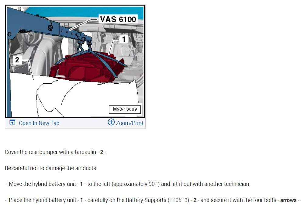

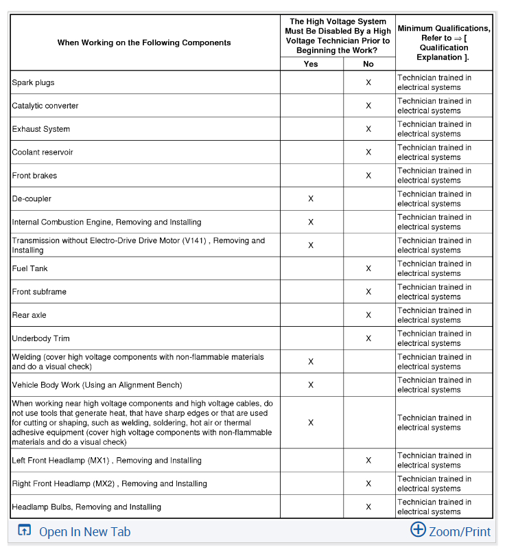

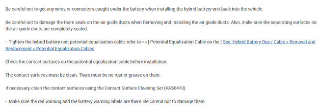

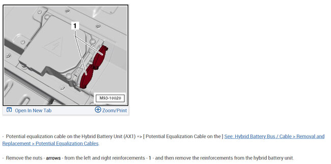

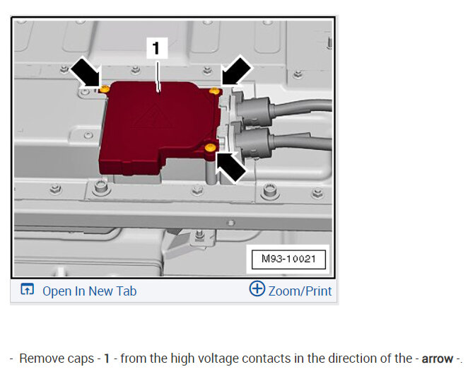

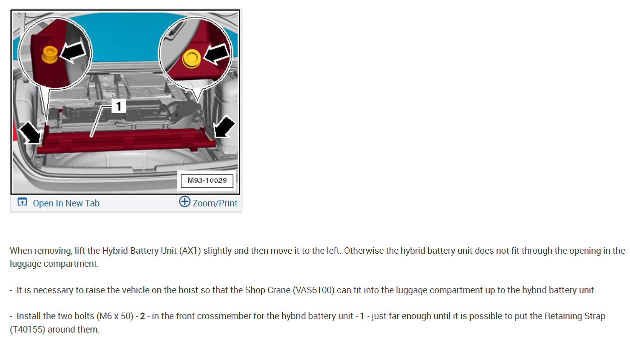

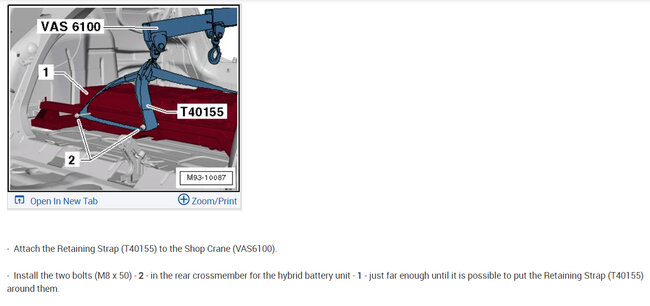

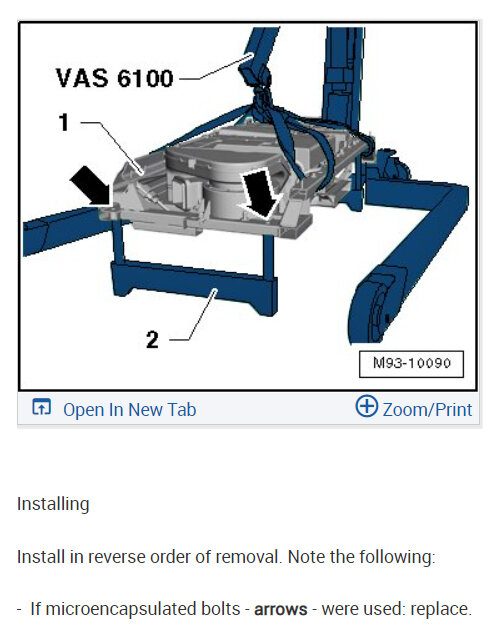

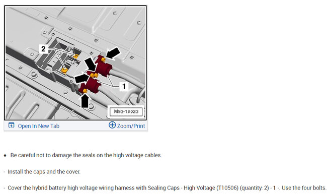

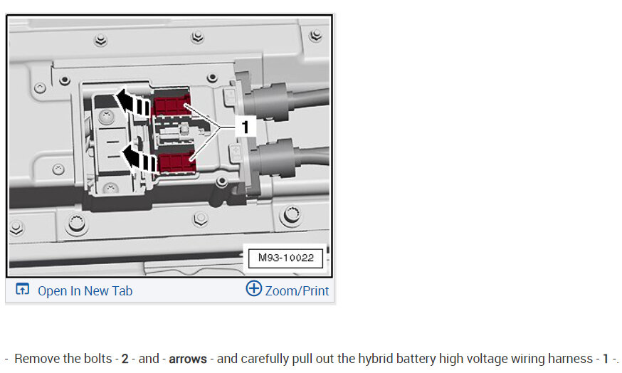

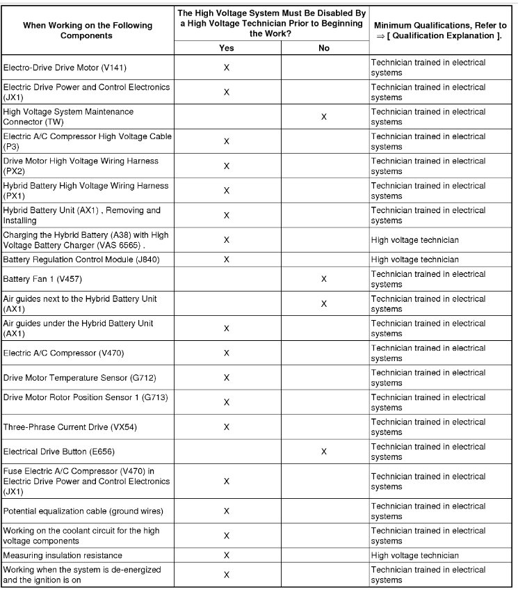

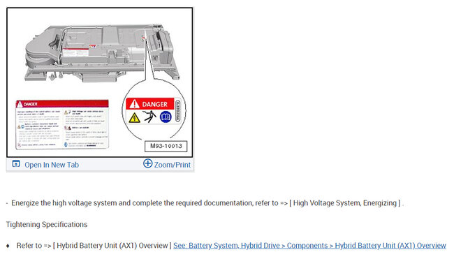

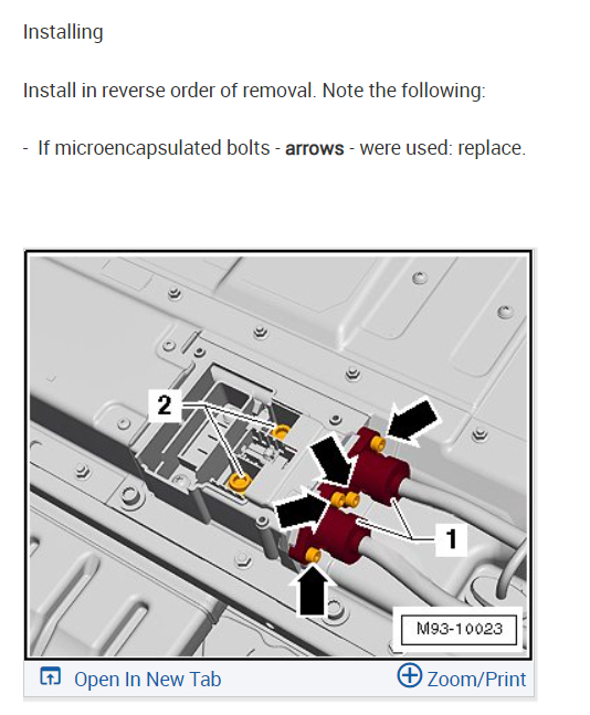

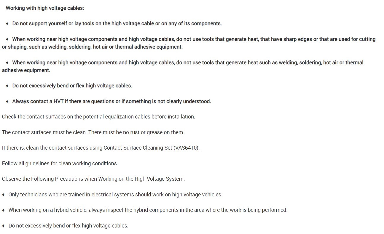

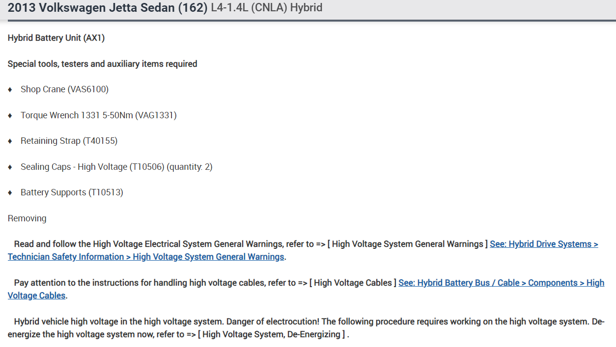

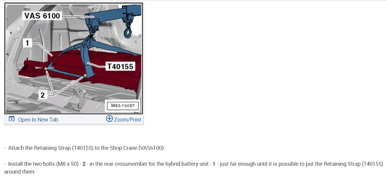

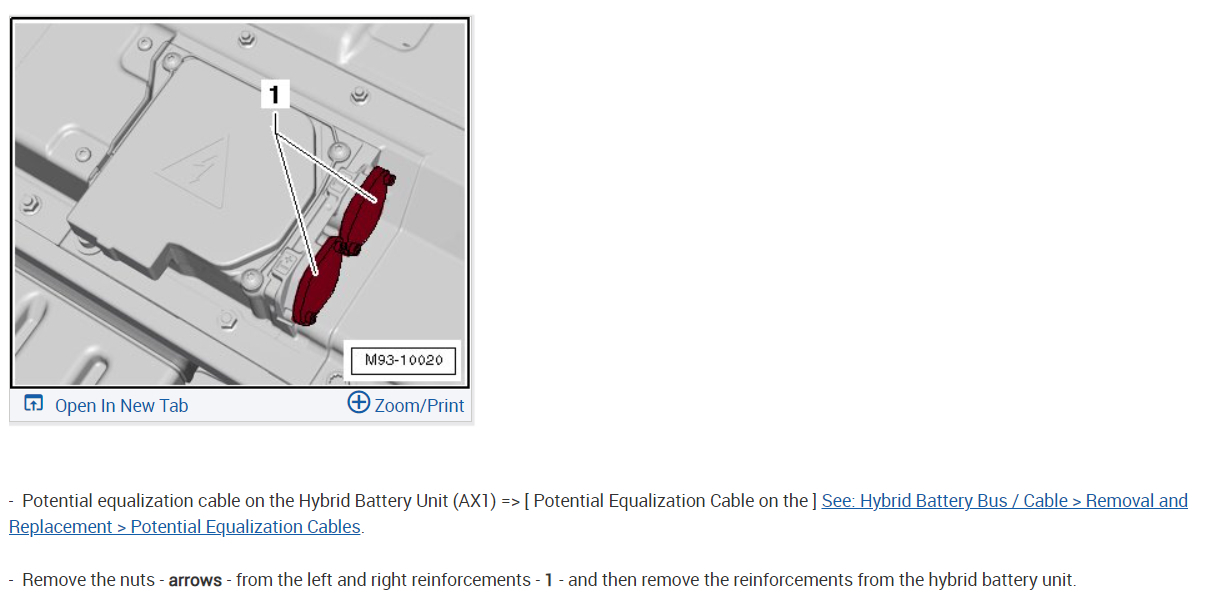

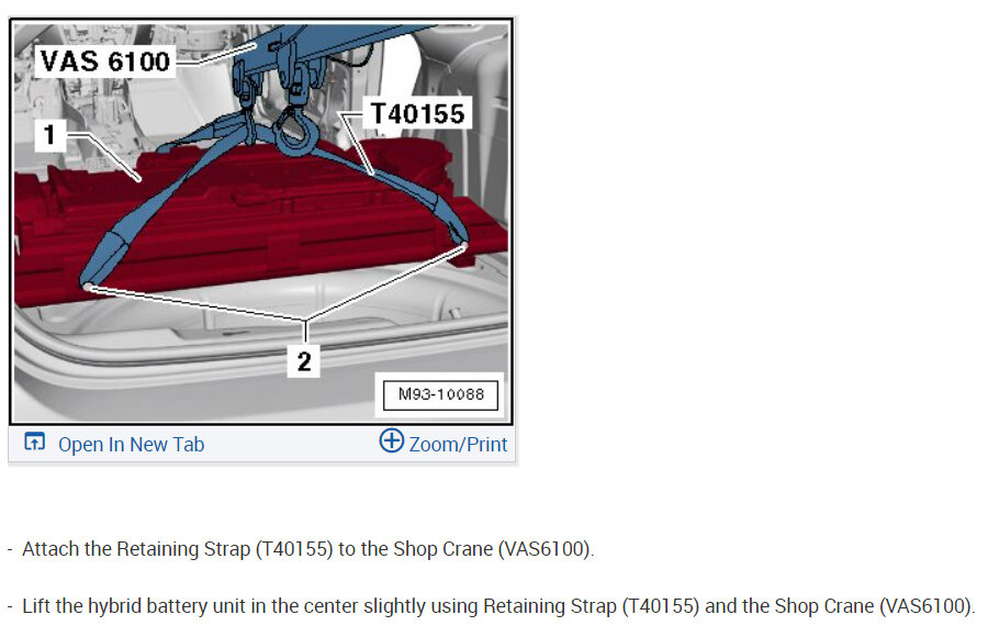

Yep, good call, can I ask if this is a plug-in hybrid? If not, it sounds like the hybrid battery is bad. But we should run the CAN codes to see if any are stored. You can get a CAN scanner (Controller Area Network) which will work on most cars from Amazon.
Here is a video to show you how:
https://youtu.be/u-4syLc-ifQ

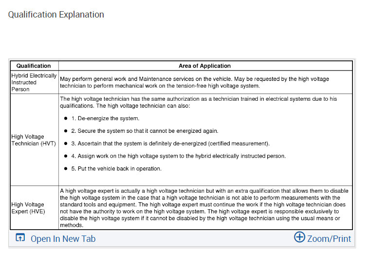

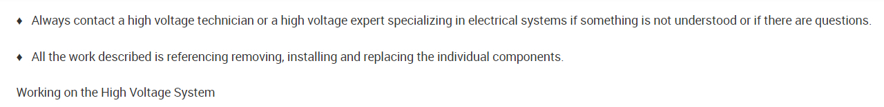

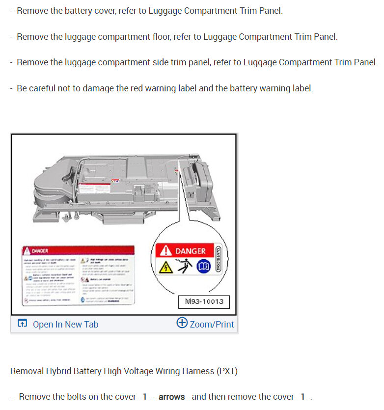

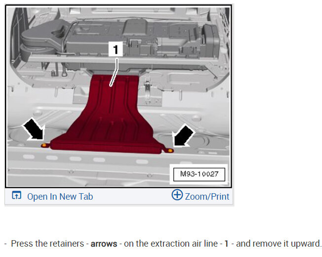

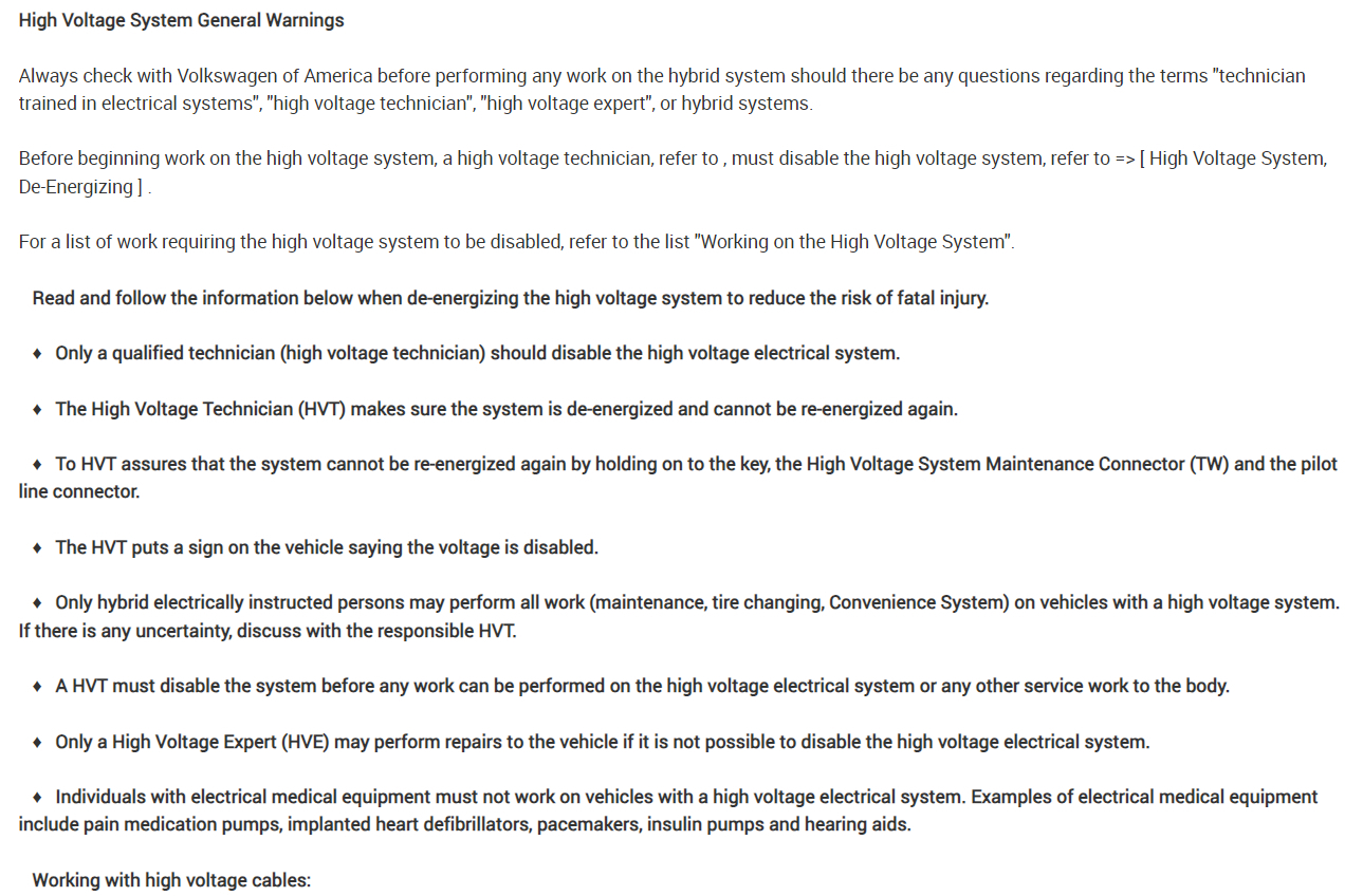

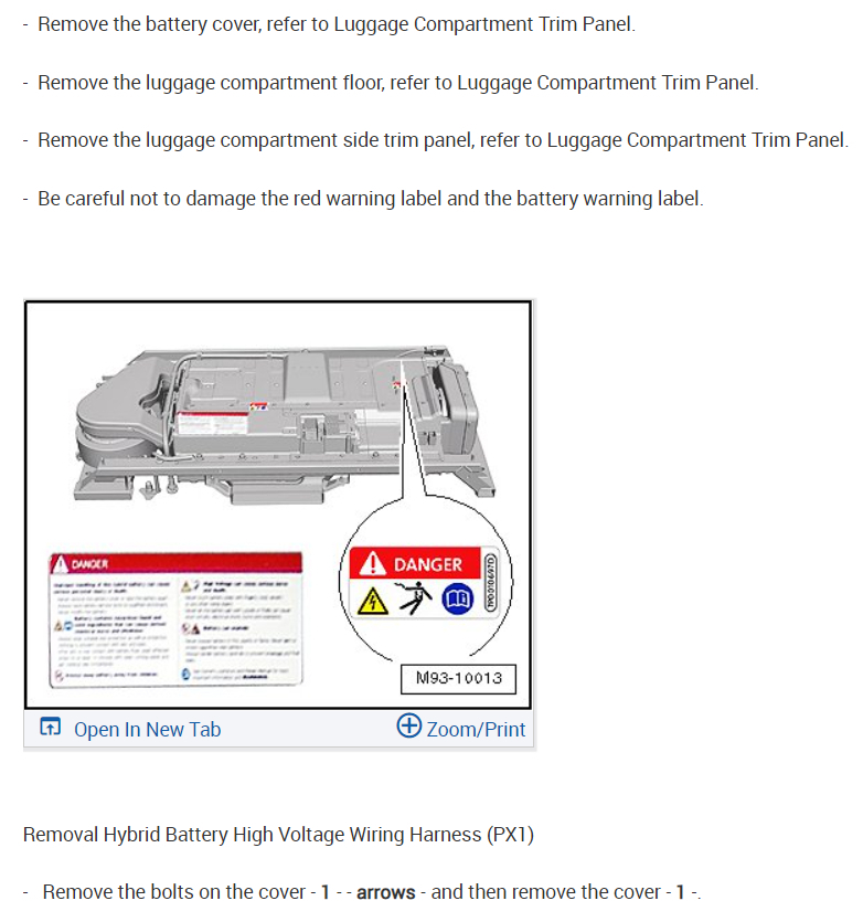

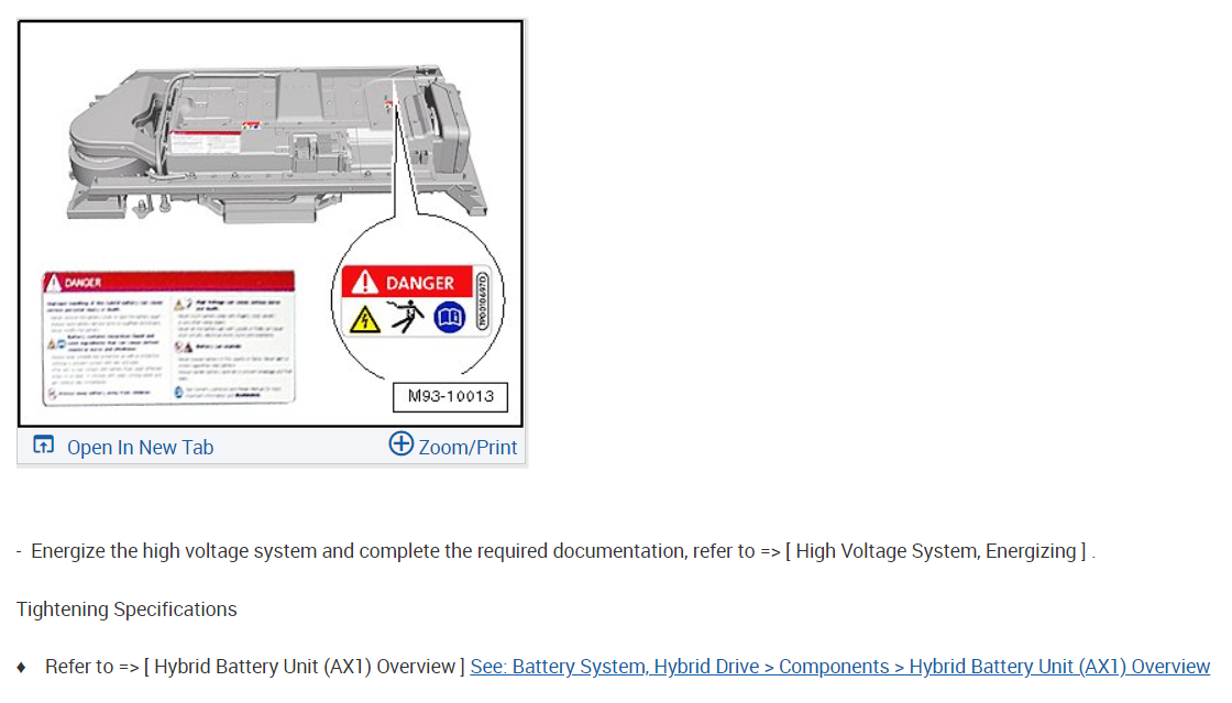

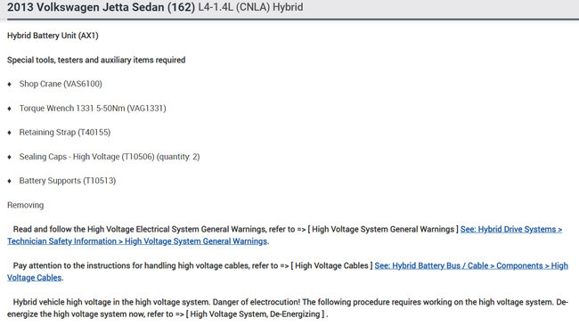

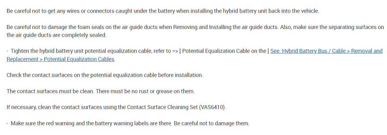

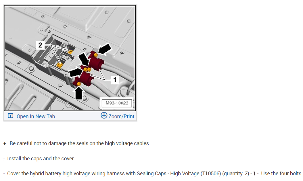

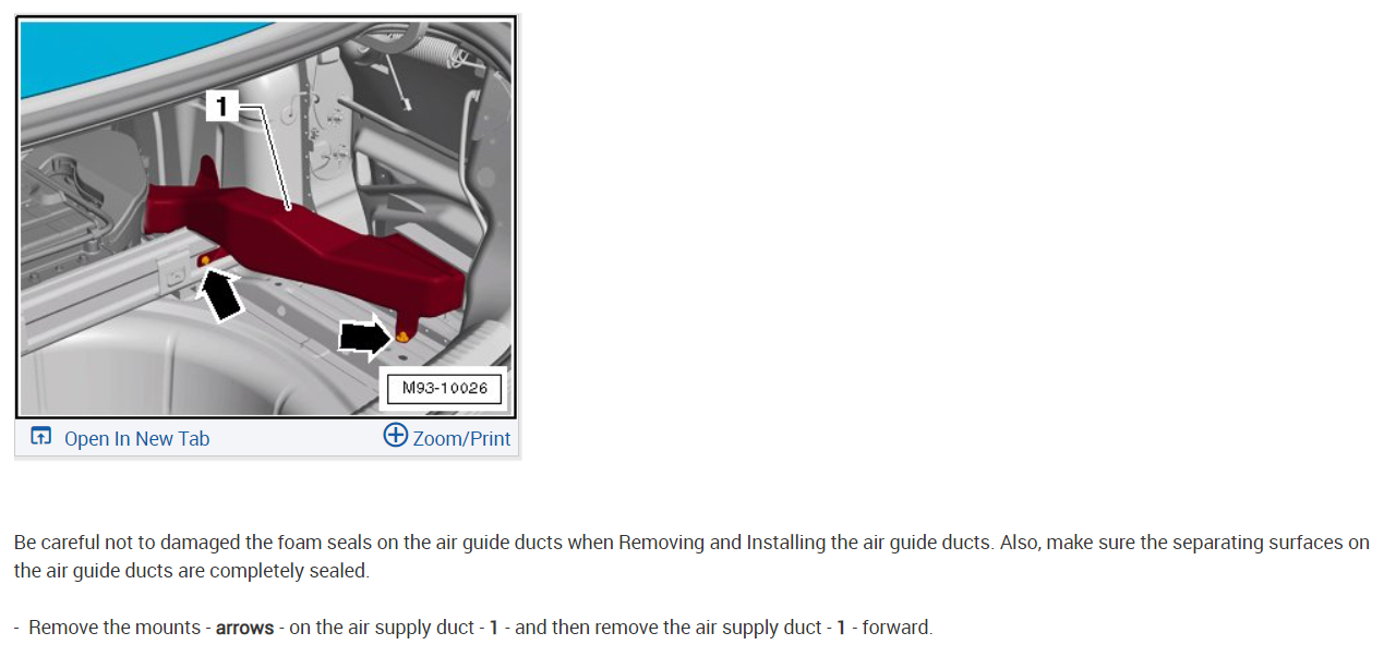

To change the battery out you need to be trained and it takes an engine hoist to remove the battery because it is heavy. Here are the instructions on how to do the job I would read it over completely so you can see the job that needs to be done, Like I said though you need to be trained on this job to avoid personal injury. Before we do anything let's run the codes first to confirm the failure. Check out the images (below). Please let us know what happens.
