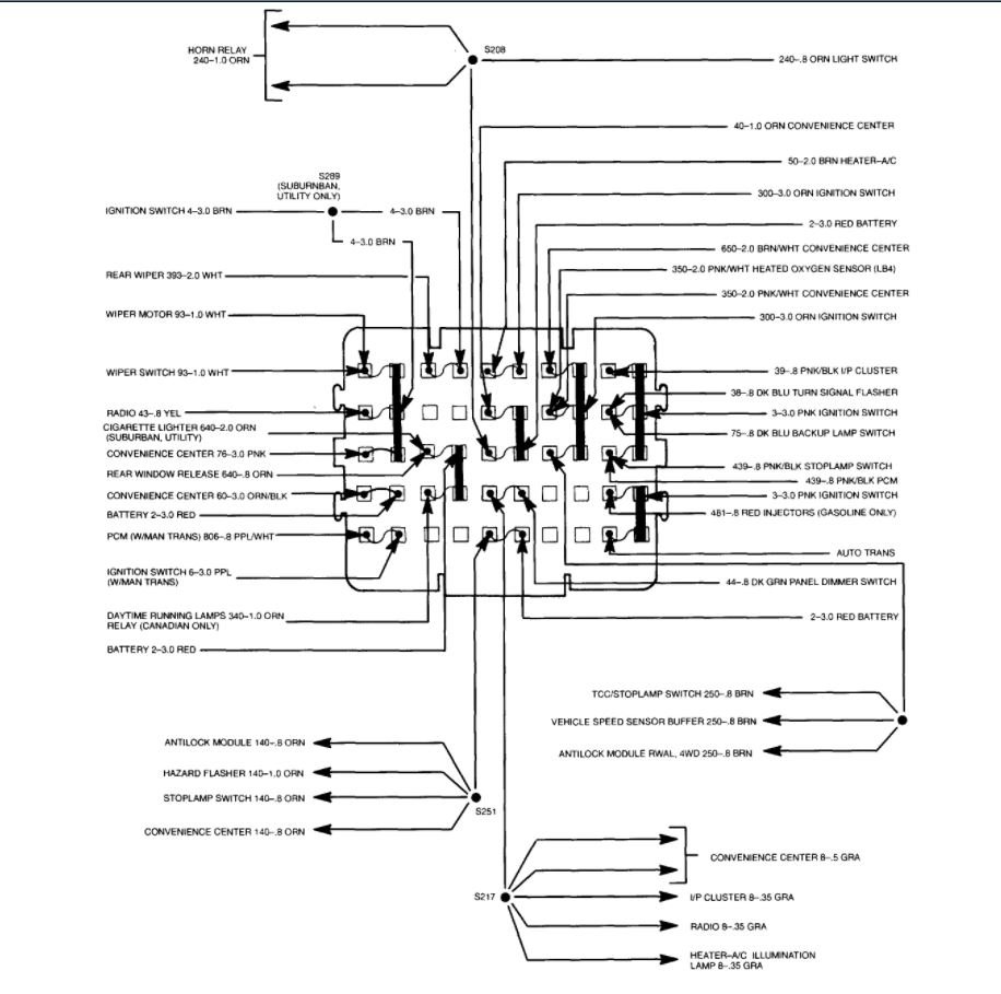

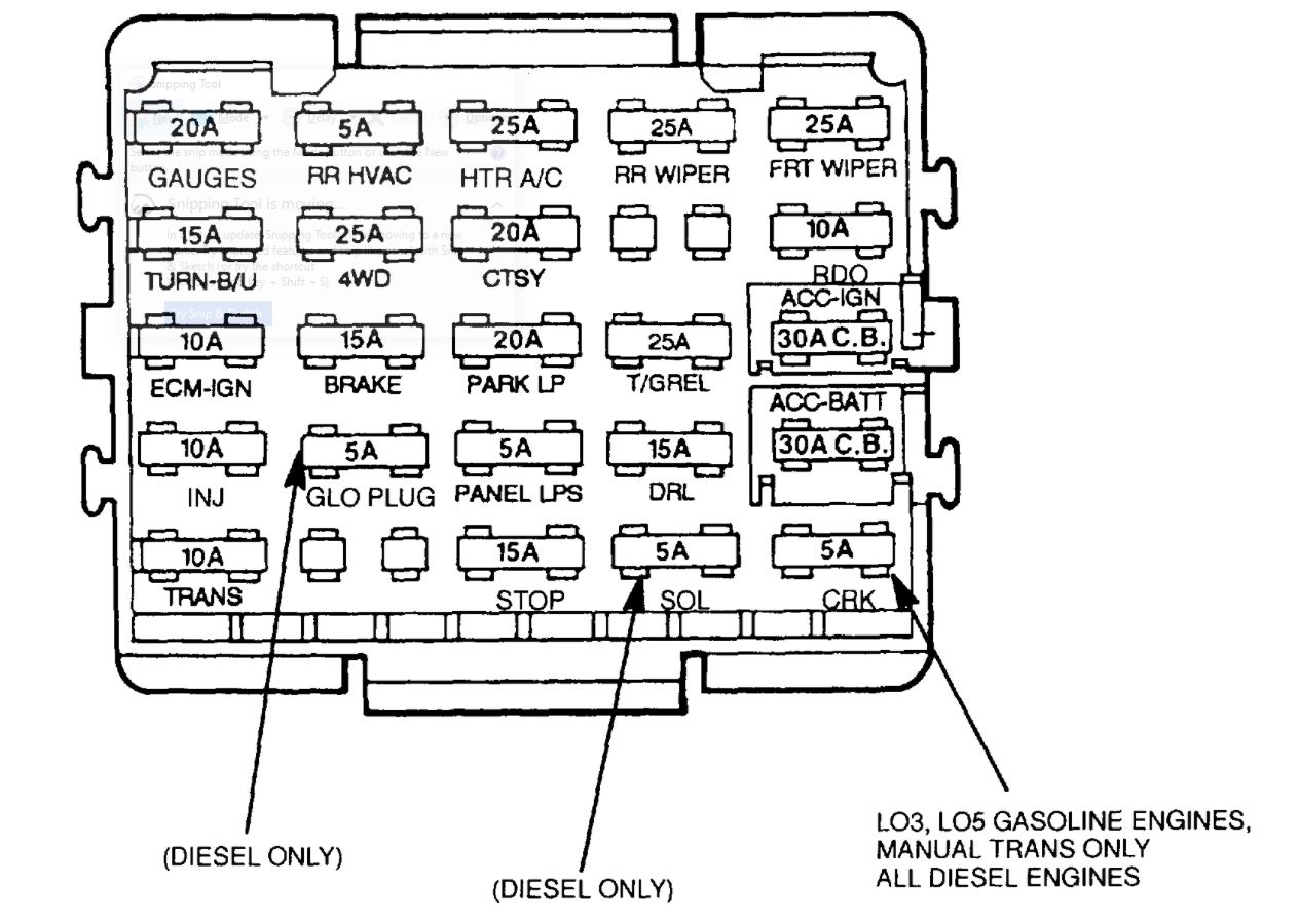

I need a diagram of the under the hood fuse block for the truck listed above.

Good morning,
I attached a picture of the front and back of the fuse block for you to view.
Let us know if you have any other questions.
