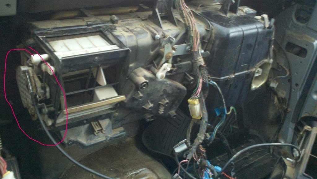

my control that switches from defrost to floor it will not work. it acts like it is stuck. what can I do to make it open?

Sounds like the mode door controller may have failed. It is on the end of the heater box to the right of the steering column. Circled in the picture.
Image (Click to enlarge)
