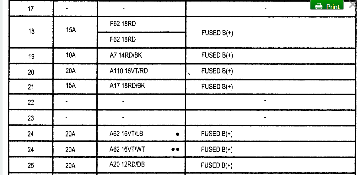

4) Go to the underdash fuse box. It is located on the drivers side of the dashboard. Find a circuit that is "hot at all times". Fuse 18 should work. Pull out the fuse. Take your fuse tap and splice enough wire to to it, using a butt connector, that it will reach the switch you just installed in the engine compartment. Usually you find a grommet in the fire wall where wires are running through it, utilize this to route the wire. Install the fuse tap in fuse 18 slot. Install fuse 18 in the fuse tap.

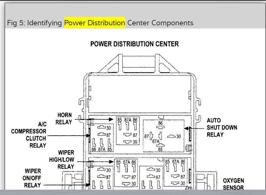

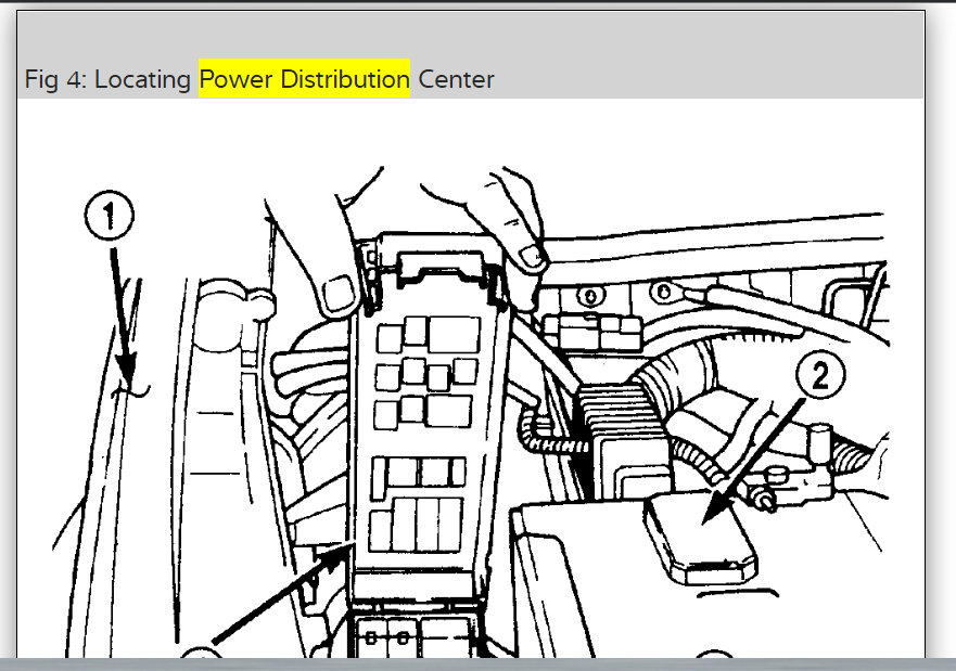

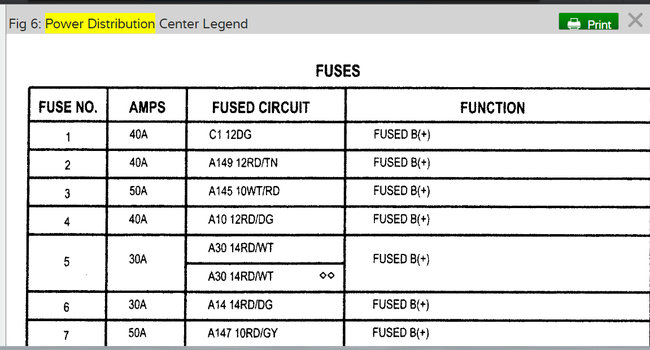

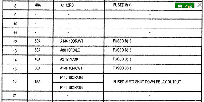

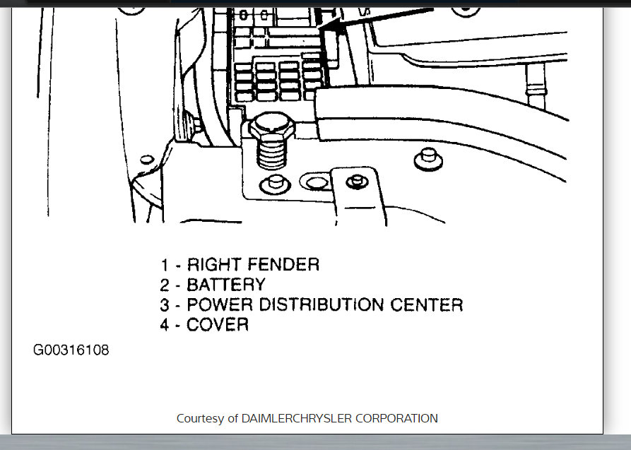

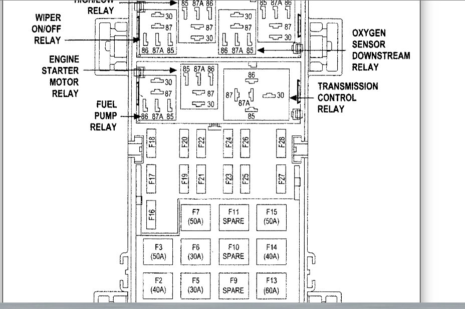

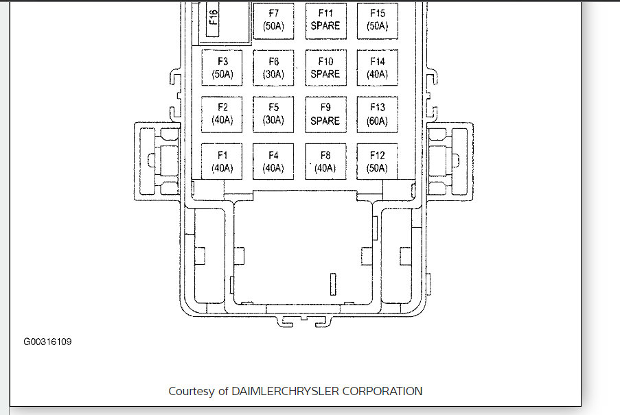

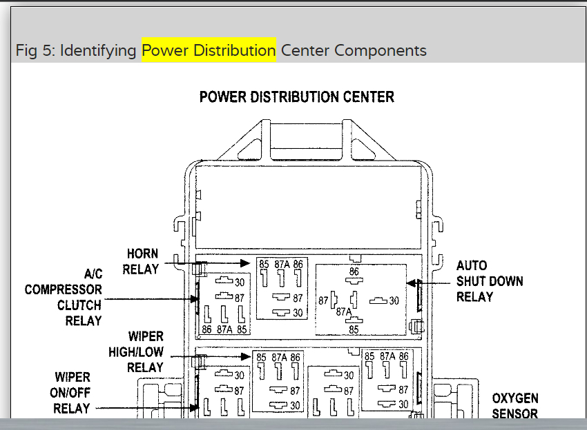

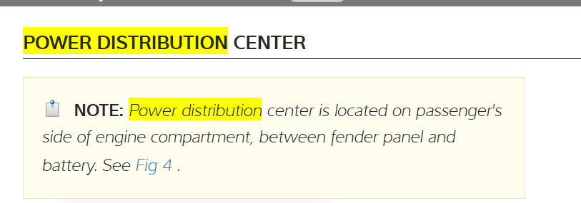

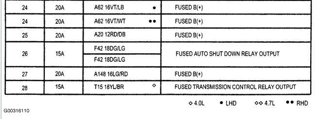

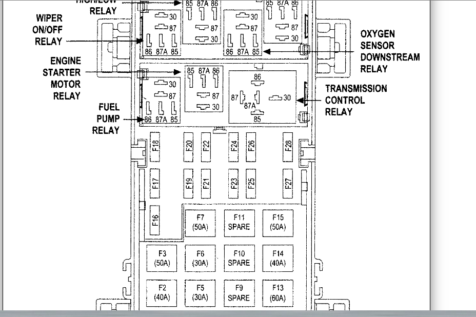

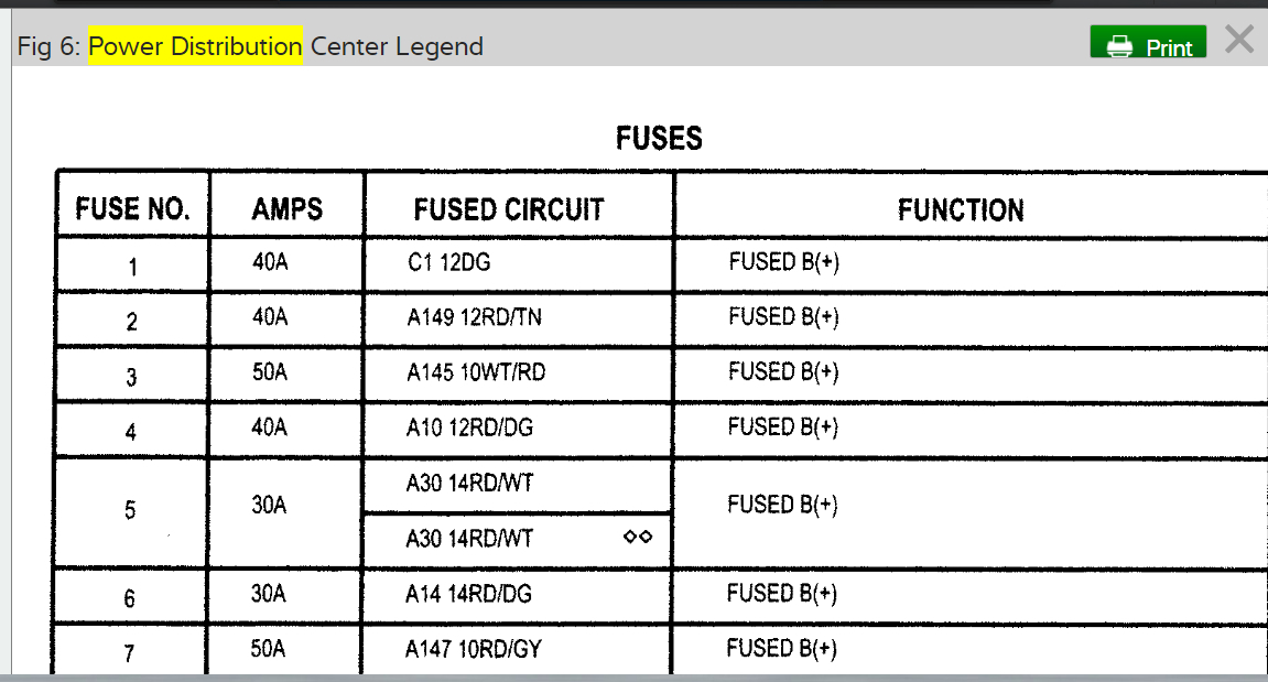

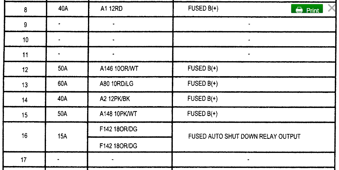

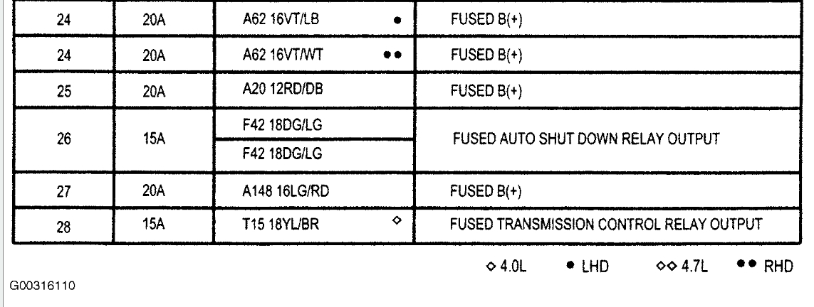

I have included the location and diagram for your vehicle's under dash fuse panel in the diagrams down below. Please let us know how it turns out and if we can help you with anything else.
