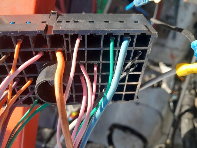

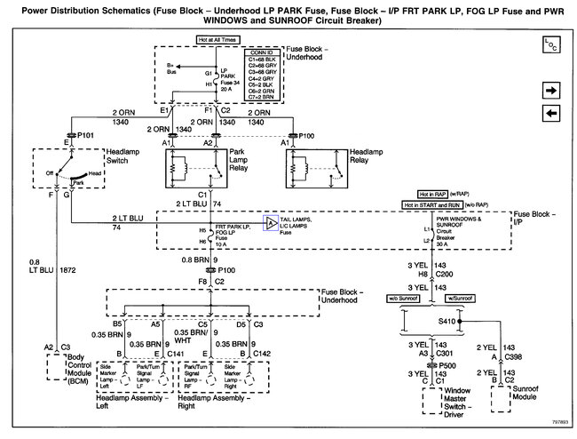

Hi, I need a wiring diagram for the under-hood fuse box.

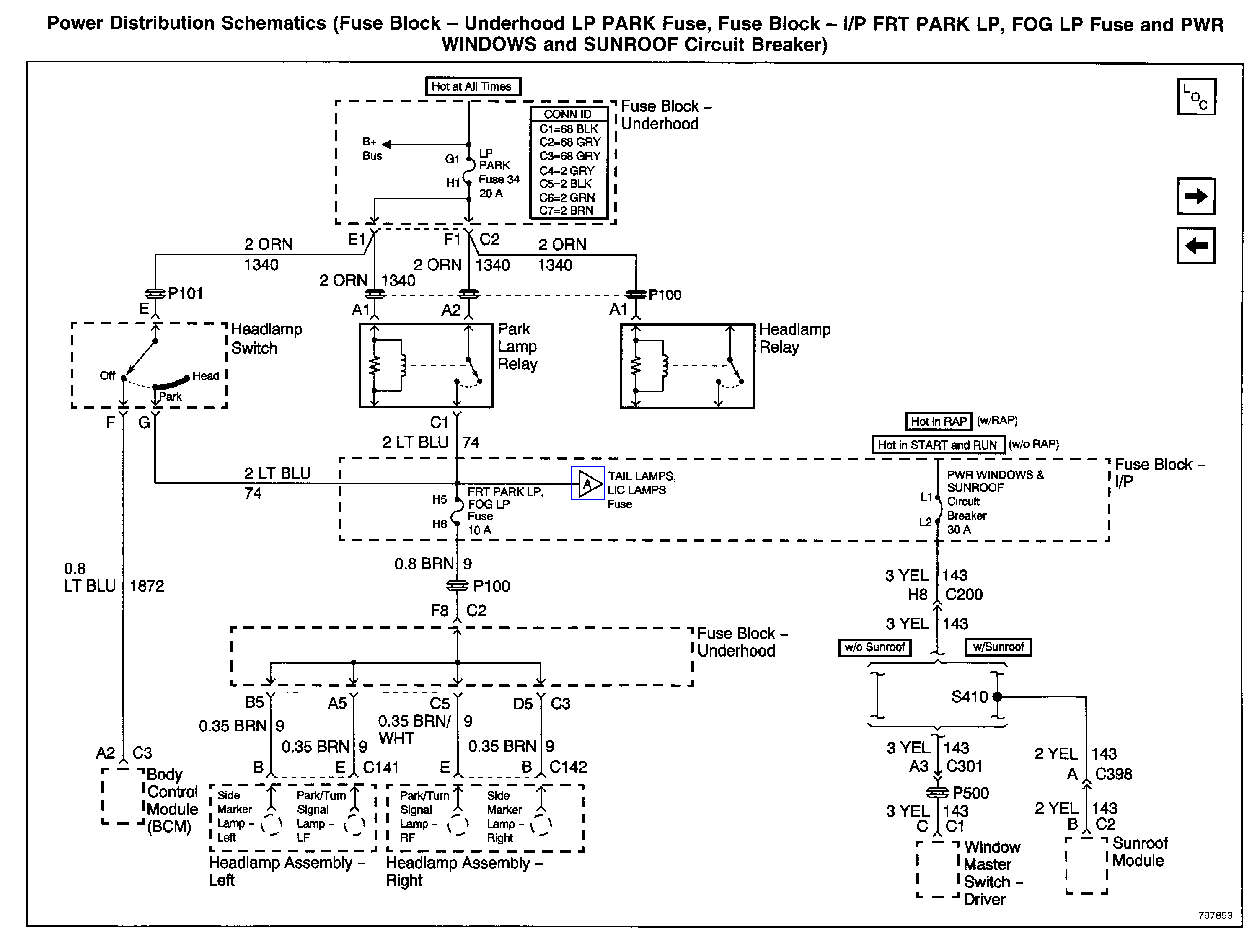

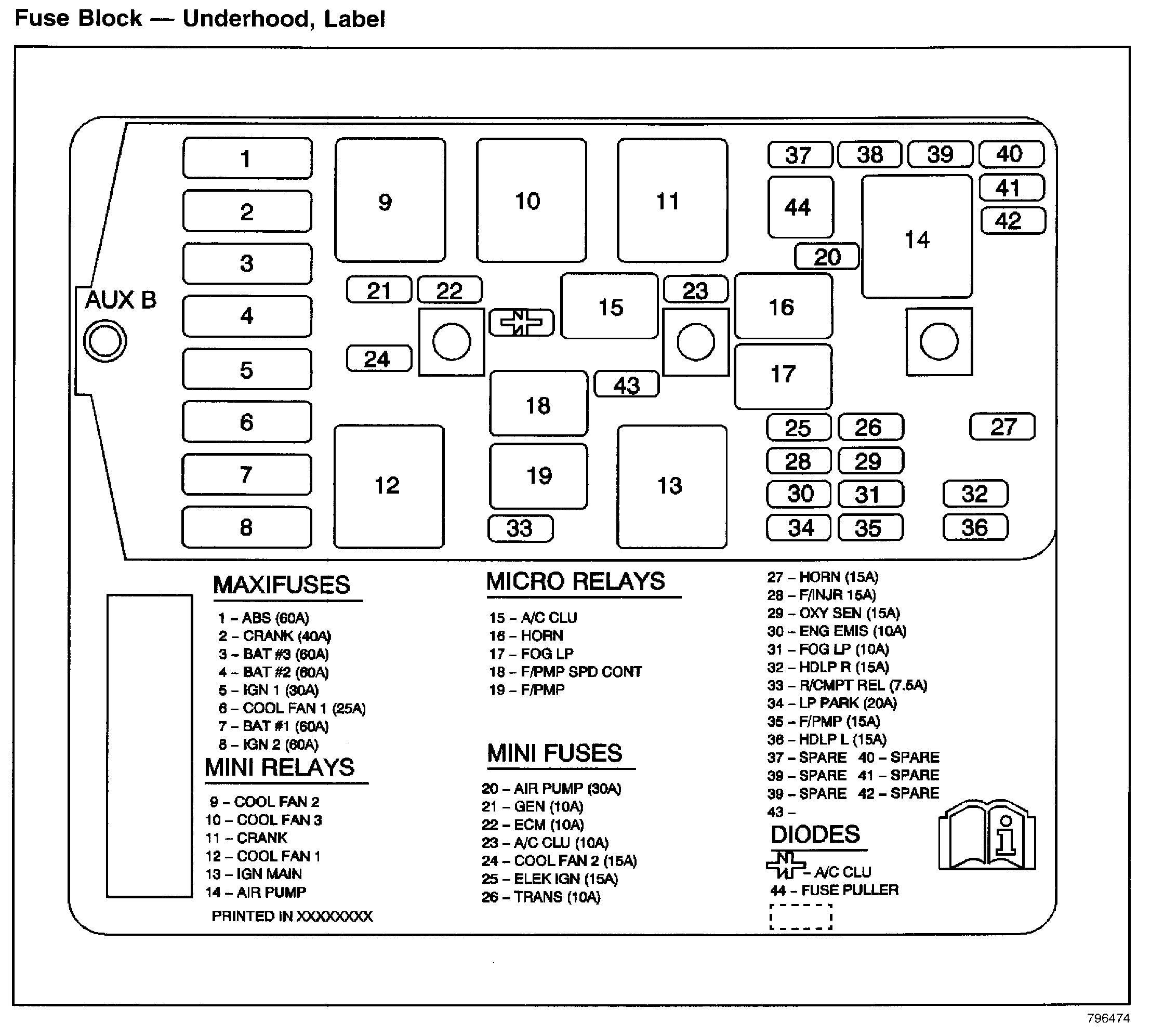

Here's the diagram for the under the hood fuse box. please click the image below.

I need where the wires go into the fuse box.
Aug 26, 2025 at 7:57 AM
HAYDEN224
  • 5 POSTS
I need the diagram for this.
Aug 26, 2025 at 7:58 AM

What distribution
Power ?
Ground ?
Theres alot of them
Im assuming power

I need it for the pink wires I screwed up and now I don't know where to put them.
Aug 26, 2025 at 11:56 AM

There's 3 diagrams for the underhood relay and fuze box
Each one shows up top what they're for including wire color ..just keep in mind they're combined for the one box ..just click the images below . Good luck
