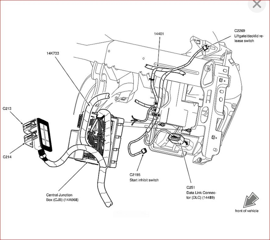

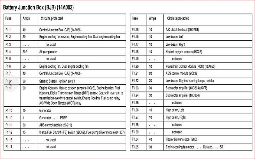

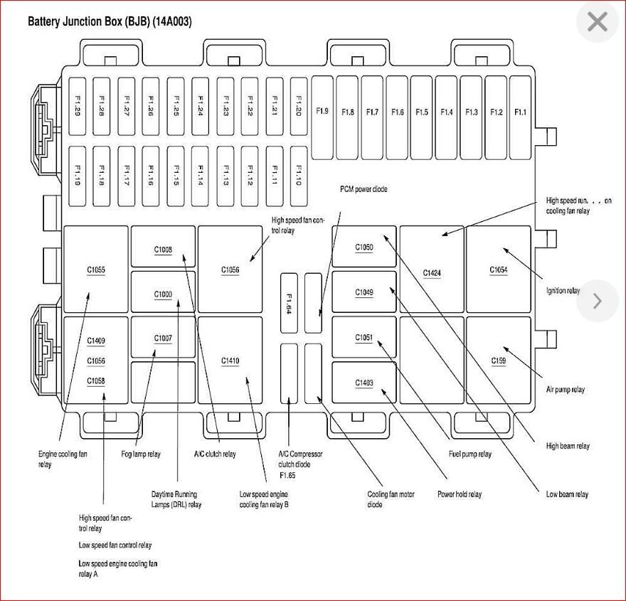

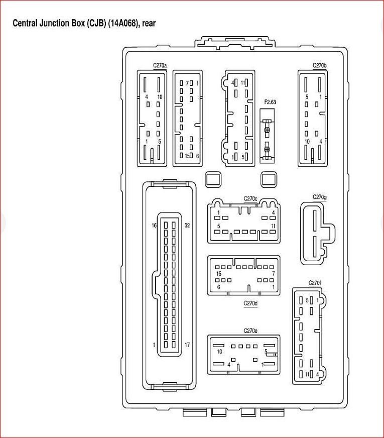

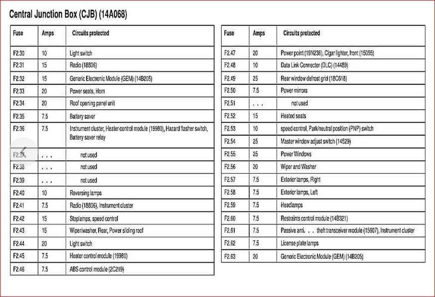

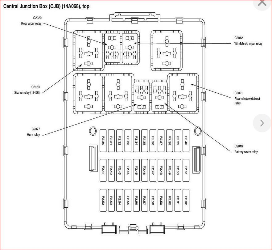

I would like to know the diagram and where the fuses belong if they are all there.

Hi ReynodsStaci,
Here are the battery junction box in the engine compartment and the central junction box behind the dash panel.
Let me know if you need more information. Thanks
