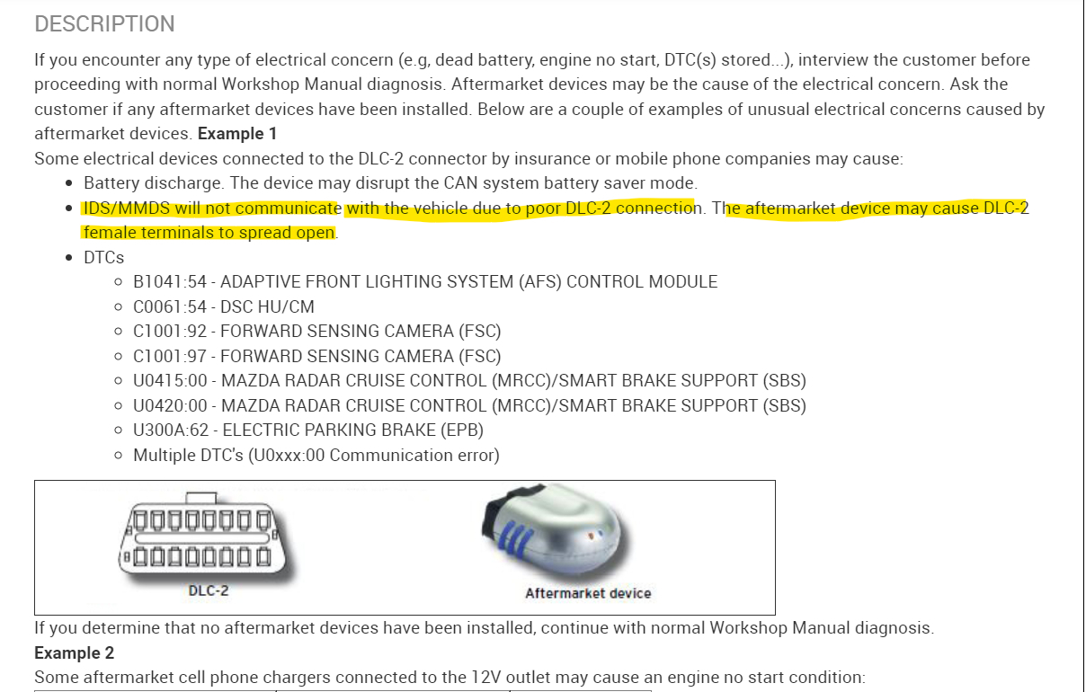

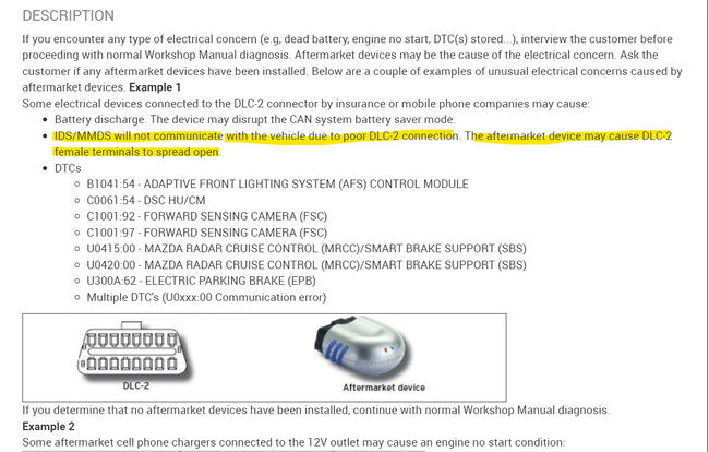

Another thing is that the use of some aftermarket scan tools actually has wider pins in their connectors, and they end up spreading the female pins in the data link connector in your vehicle, there was a warning out about this awhile back. Some cheap code readers were causing this. So, if the auto parts store cannot communicate with your ECM, then you'll know the issue is with your vehicle and not some other cause. I'll post the diagram for your information bus, there is a fuse you can check.

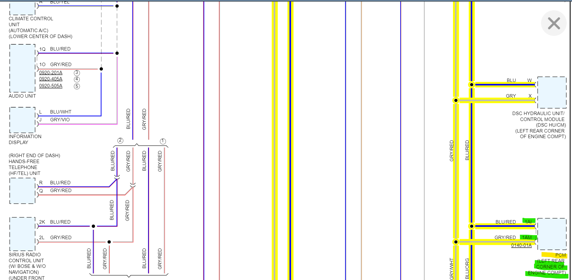

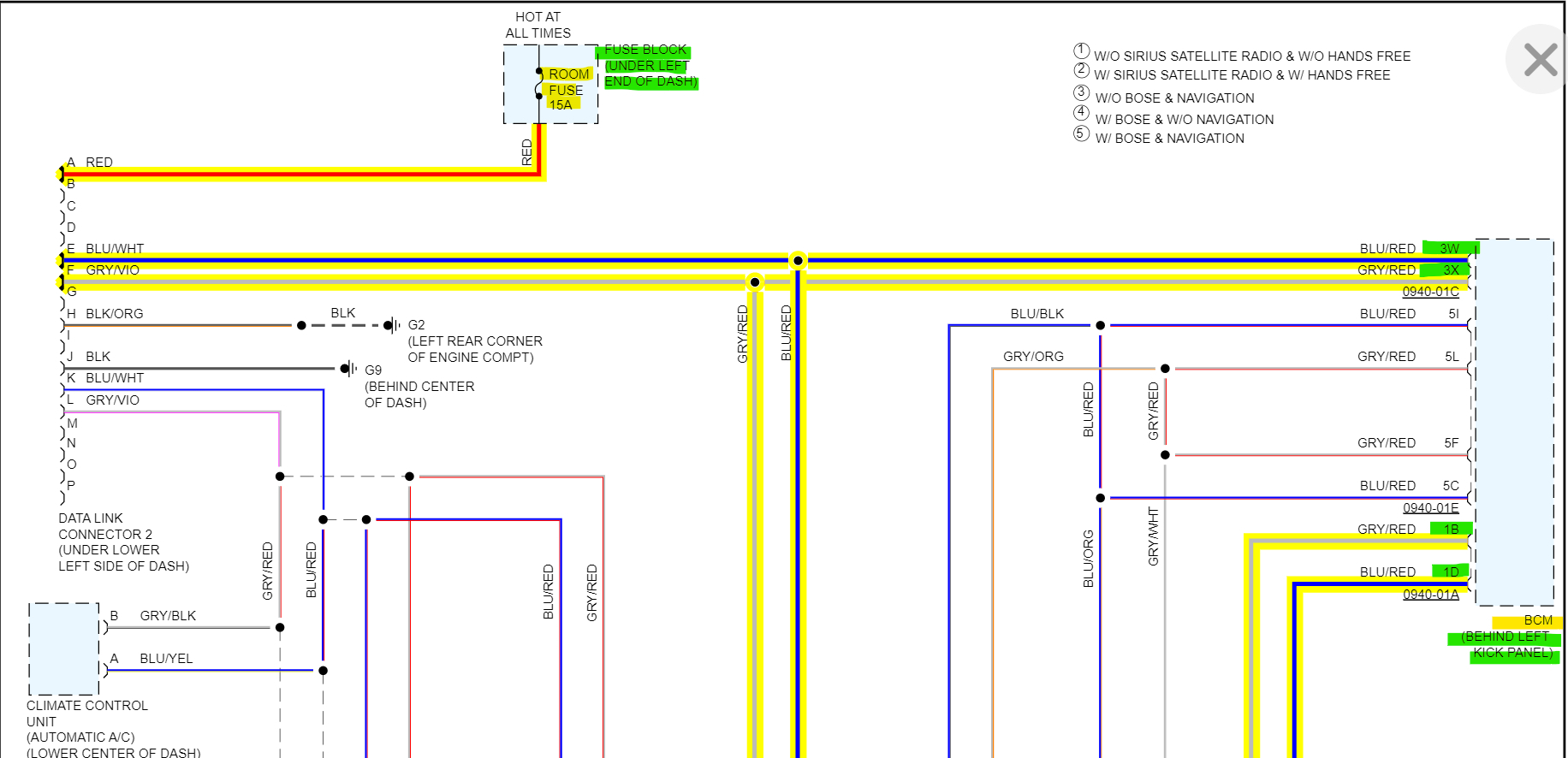

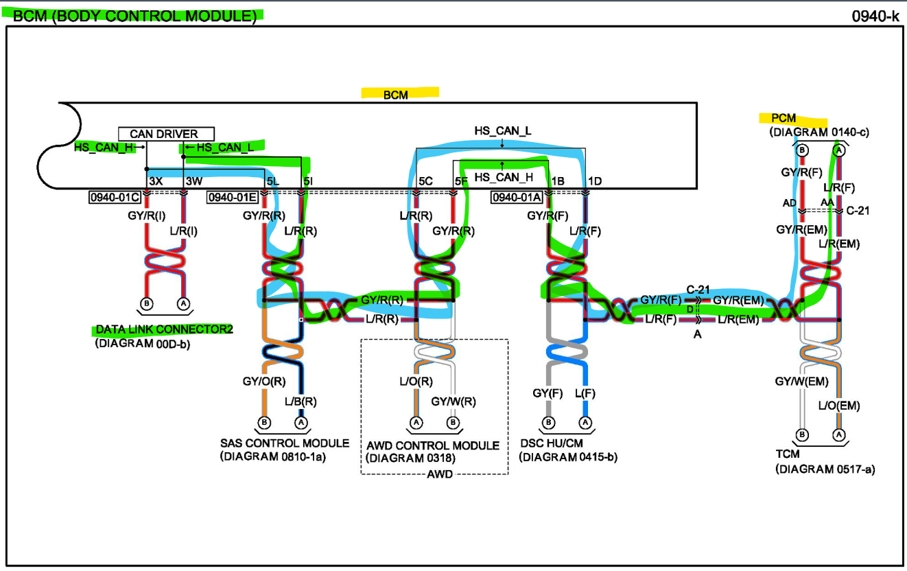

Diagrams 1 and 2 below are aftermarket diagrams showing how the communication wires are routed. In diagram 1 on the left is the Data Link connector under your dash, you can see that the highlighted wires run to the Body Control Module first and come out to run down to the engine computer and a couple other modules, so it's possible that communication was lost through the BCM, and their scanner is not reaching the ECM. In this case the BCM is a type of Gateway for those other modules. There is also a fuse you can check at the top of diagram 1.
The 3rd diagram is the OEM (manufacturer) wiring. It's the same. Just a more complicated version.

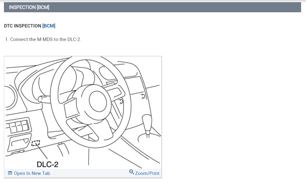

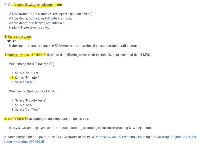

The other possibility I came across was labelled "DTC Inspection" (diagnostic trouble code inspection) According to this service information you can see in the 2nd to last diagram it required a few conditions to be met to retrieve trouble codes, which is what an inspection station is looking for, A vehicle will fail if there's any trouble codes related to emissions stored in the ECM. I'm not sure exactly if a manufacturer would require these conditions just for getting codes out of the computer, I've never heard of this before. But it is in service info for some reason. It requires all switches off except the ignition switch, all doors closed, all doors unlocked, and Parking Brake lever pulled.
Bring the vehicle to an auto parts store for a free code scan and see if any of these make a difference. Hopefully this will help. I would think that if any of the communications networks were down you would be experiencing a lot more issues. I also added the Technical Service Bulletin about the data link connector pins being spread by aftermarket devices (last diagram).
