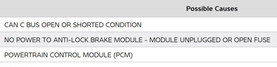

I wanted to know if U1110, 20 can cause the reading P1775?

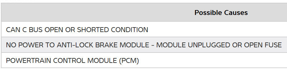

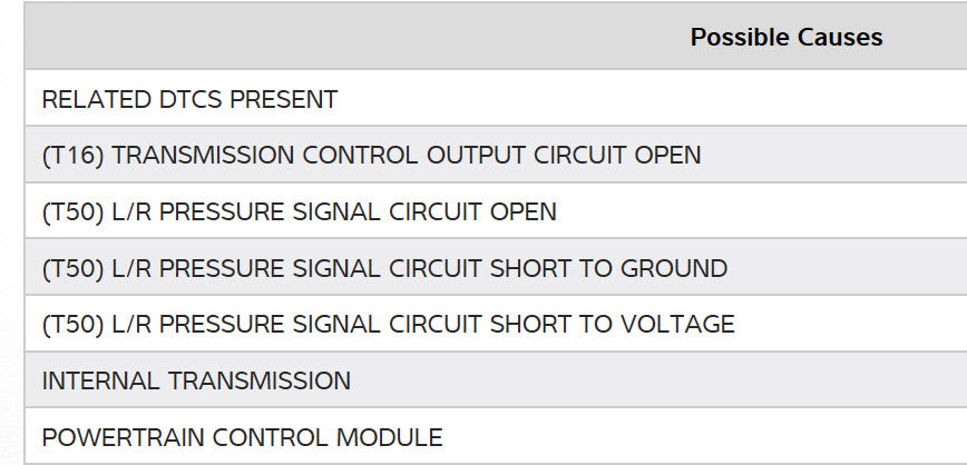

pictures show code meaning and p code is first then 10 then 20 but they may cause the 1775 code, not saying they will but the U codes should be fixed first. ignore first picture I could not erase it.
